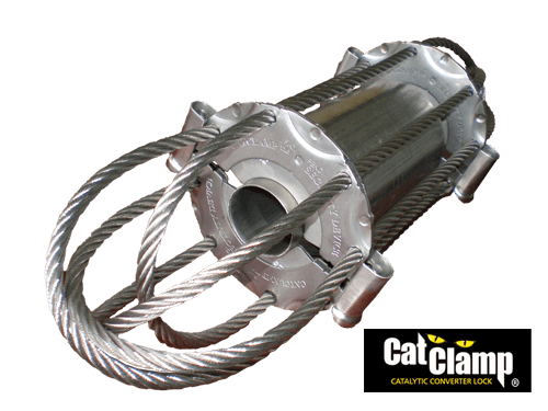

    They make these for diesel cats, haha.
