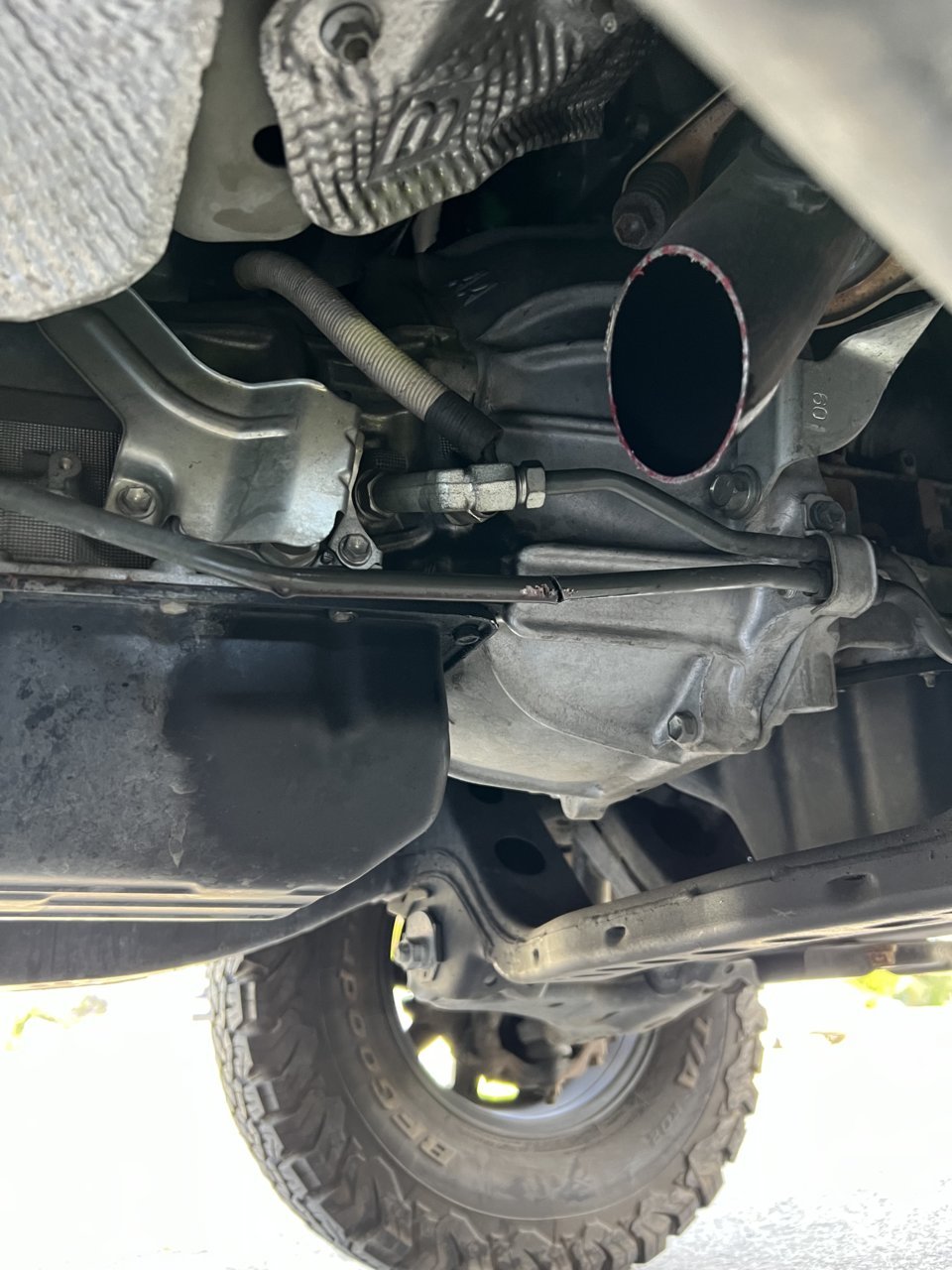

    Had my catalytic converter stolen this morning off of my 2013. They cut in into my transmission fluid line too. Anybody got any tips/ suggestions for replacing the line? Thanks!

    Either buy / make a complete new line, or you can repair that with a couple of compression fittings. Regardless, it needs to be complete removed and cleaned...any chunks of metal that made their way into the line need to come out

    Just look up the part number for the cut line, a parts diagram is what visually confirms your part. You will also need transmission fluid and the knowledge on how to make sure it’s at the proper level. You can’t just dump it in. It needs to be at the proper temperature to verify it’s filled correctly. This isn’t a job for the non experienced.

    The trans line you could get away with cutting out that section and getting some union fittings and put a replacement section in. Hell you could probably just pull that hard line, cut it straight, put a flare on both sides and get a properly sized rubber trans cooler hose and clamp it on there - its what they do up front, but def put some heat shielding in place

    Fawk im sorry man. You can make your own cat shield pretty easy if you have access to a small welder and an angle grinder. If not im sure there is someone that can make something local or already sells a prefabbed setup. The worst thing would be to get it replaced then have it happen again.
