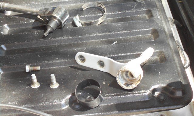

    I can appreciate the concern about buying a tailgate stolen from someone else's truck. No doubt it happens daily.
    Aside from the locking gates and parts sold to retrofit locks - do put a cover on the passenger side hinge to block the slot, so removal is more difficult. Some of the methods to do this are expensive and some rather simple. Being able to snatch one quickly is the attraction to thieves so anything that slows them down is good. Owners rarely remove their tailgates any more, so the "keeper" doesn't need to be too elaborate, but it shouldn't be weak or easy to defeat (Be advised the hose clamp is only good for about 7 seconds.) At various threads on this site, you will find more than a few ways to do this. If the thief has plenty of time to work and tools - its difficult to be 100% effective.
    Hinge Cover Fitting the Band.jpg I fitted mine with a steel band made of exhaust tubing - assembled and then blocked the screw holes with JB Weld. I have found marks on the band where some nitwit thought it could be beat with a screwdriver.

    Thank you all for the feedback! I'm going to dive in the Toyota TIS manuals here shortly. Thankfully these thieves were smart enough to unclip the connector under the bumper so they can likely sell a working tailgate. I used an aviation grade hose clamp and filled the slot with 3M 08115 bonding adhesive. At the least it will slow them down. If the thieves are hungry enough, a simple T30 on the end of a drill can disassemble inner shell and expose the simple inner workings. We all just need to be aware of where we are parking and be as prepared as can be.

    What secures the steel band from moving, or rather rattling around?
