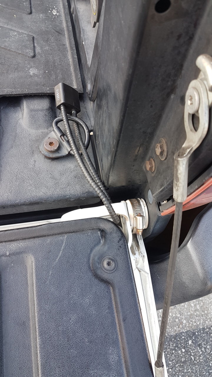

    Double Duty!!! Moved cable lock to hose clamp side piece of mind in case get thru clamp then drop damage tailgate. Wont hurt to w gun lock on both sides either

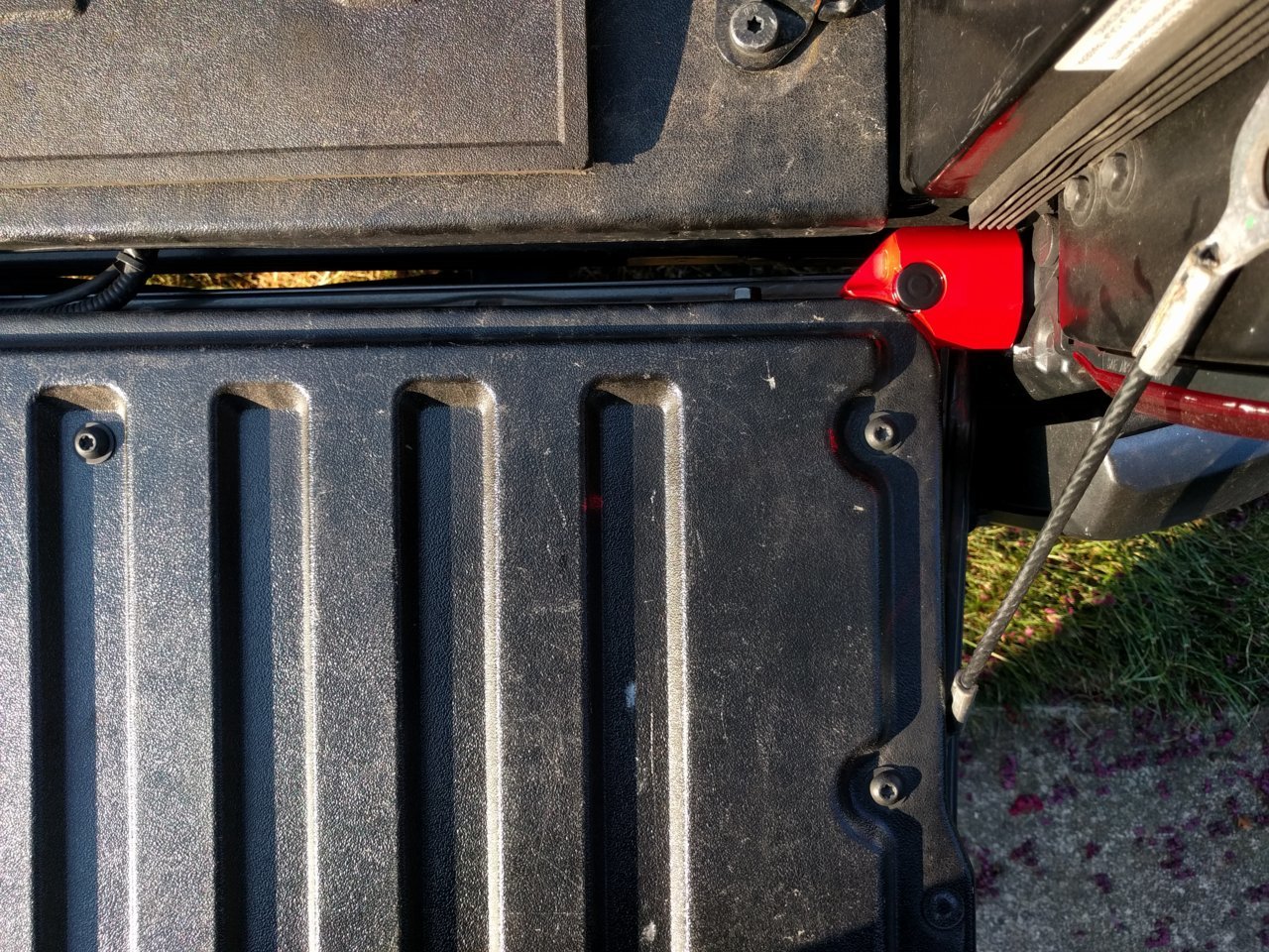

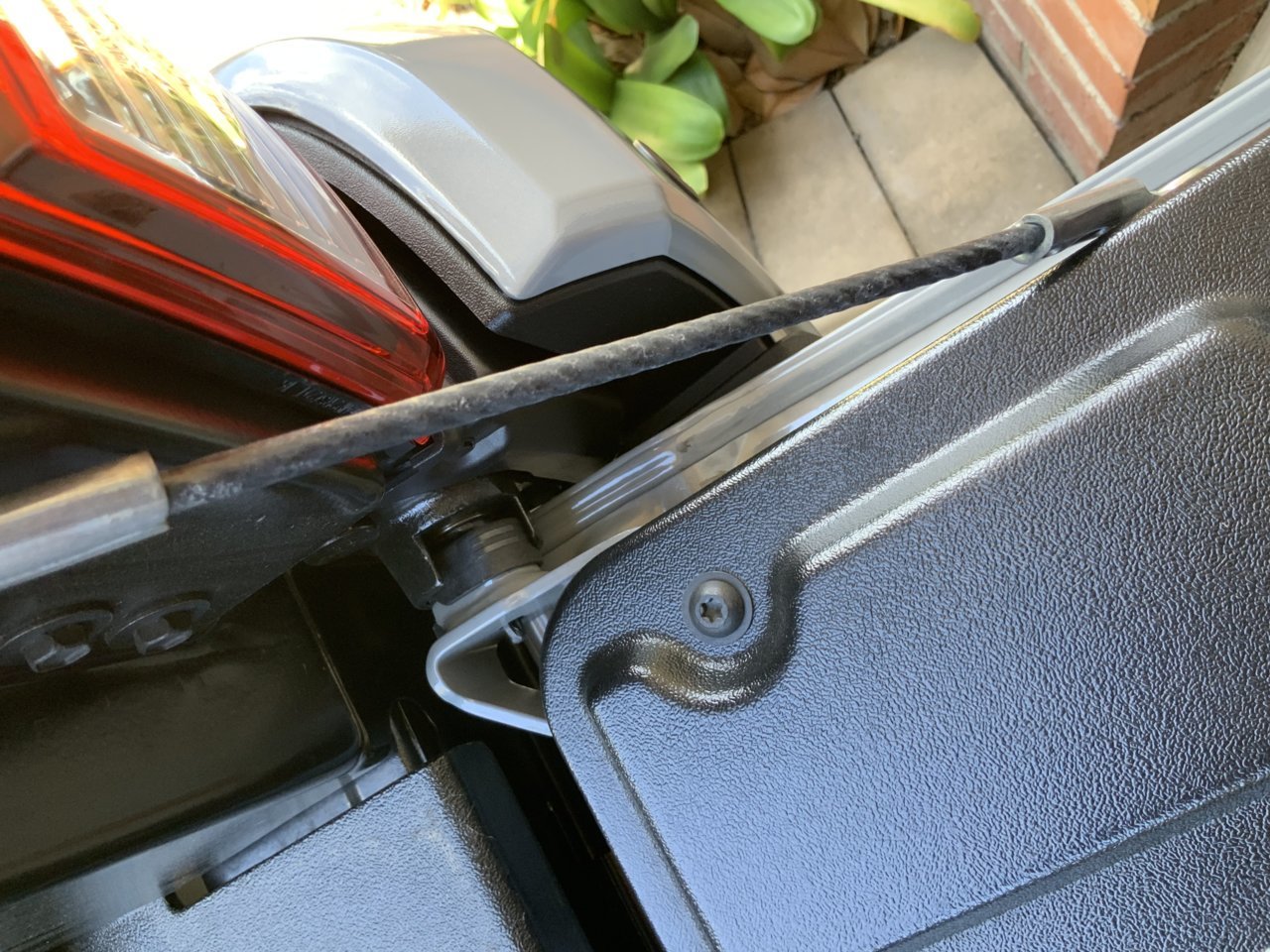

    AA63F25B-A903-455A-AA22-5E357B29795E.jpg Hinge design has been changed on my 2019 from my 2016. Looks like Toyota tried to make it even easier to remove. Hose clamp can be pushed to the side.

    Yeah I tried the hose clamp and it just slides right over on the 2019 with little pressure. Useless now. Have to buy one of those steel brackets people are selling I guess. Luckily they aren't very expensive.

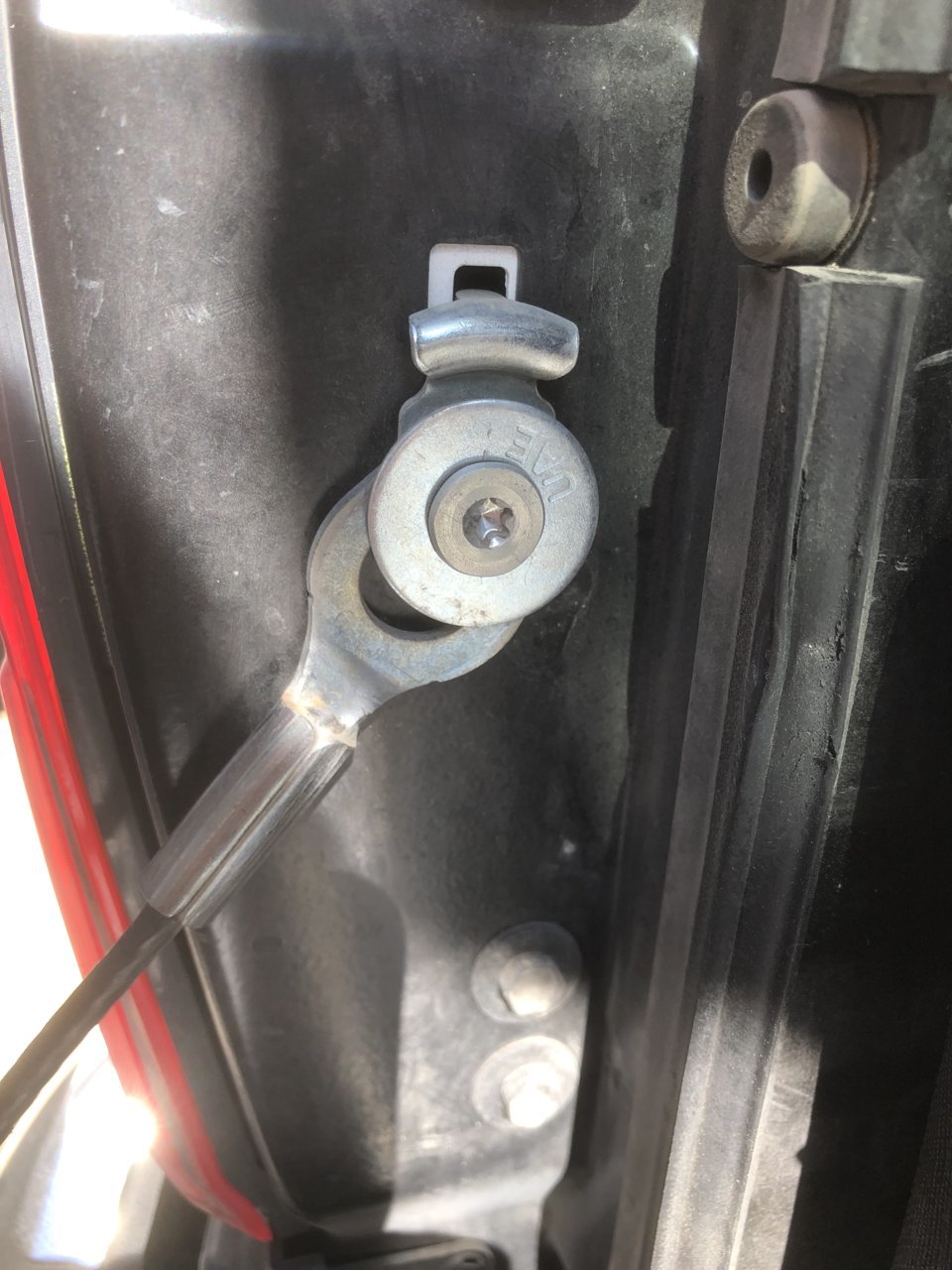

    You guys with just hose clamps have to at least do this:
    Really, hose clamps are a joke!

    Fkn brilliant. I've got a bunch of those and now I know exactly what to use them on!
    :bowdown::bowdown:
    As some red locktite for extra funsies.

    What size washer is that you are using? Did you have to do any modifications for it to fit over the existing bolt,

    There is a nylon spacer under the washer too, else you would pinch and keep the cable eye from moving out and in when you open and close the tailgate. Other than the fender washer and spacer, no other modifications are necessary.
