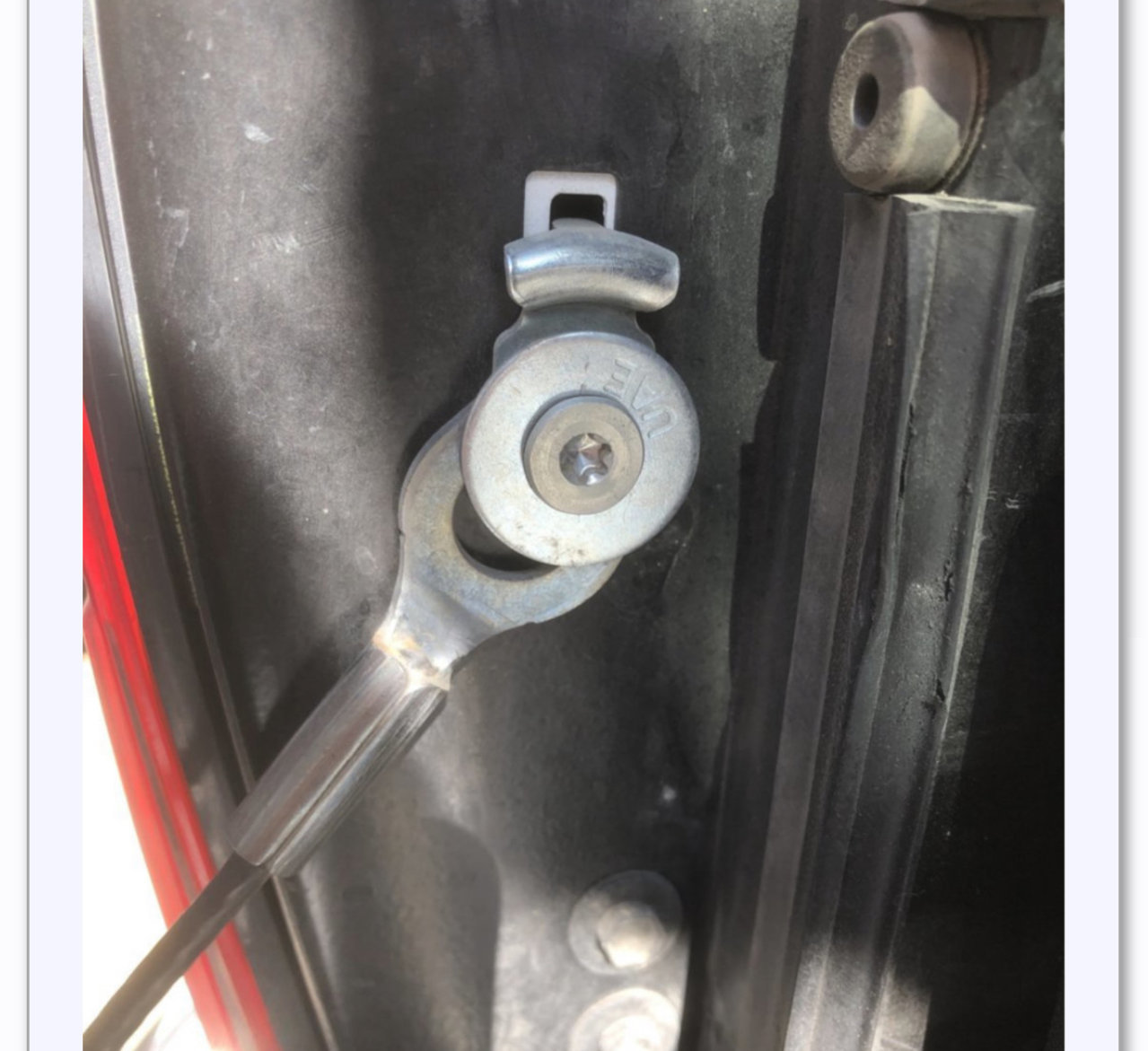

    I could break my hose clamp tailgate “protection” off in less than 10 seconds with a flat head screwdriver, they’re useless.
    …and as for tailgate support cables, this is how you lock them in. A fat old fender washer with a spacer underneath to let the cable eyelet rotate when the torx bolt is tightened up.
