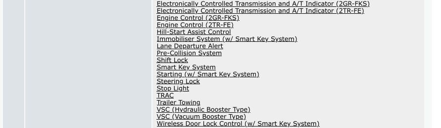

    I have a 2020 Tacoma. I am curious what the stop fuse controls by its original wiring. I recently was driving and had a brake override and cruise control malfunctions come on the HUD. I pulled over and turned the truck off and it would not start back up. I went through the brake sensors and fuses for the breaks and ignition but nothing was wrong. I decided to pull and check every fuse when I found that the 10a STOP fuse was blown. Does anyone know what this fuse is designated for and what might cause this fuse to blow.

    That fuse touches a lot to include starting if you have the smart key/push button start.
