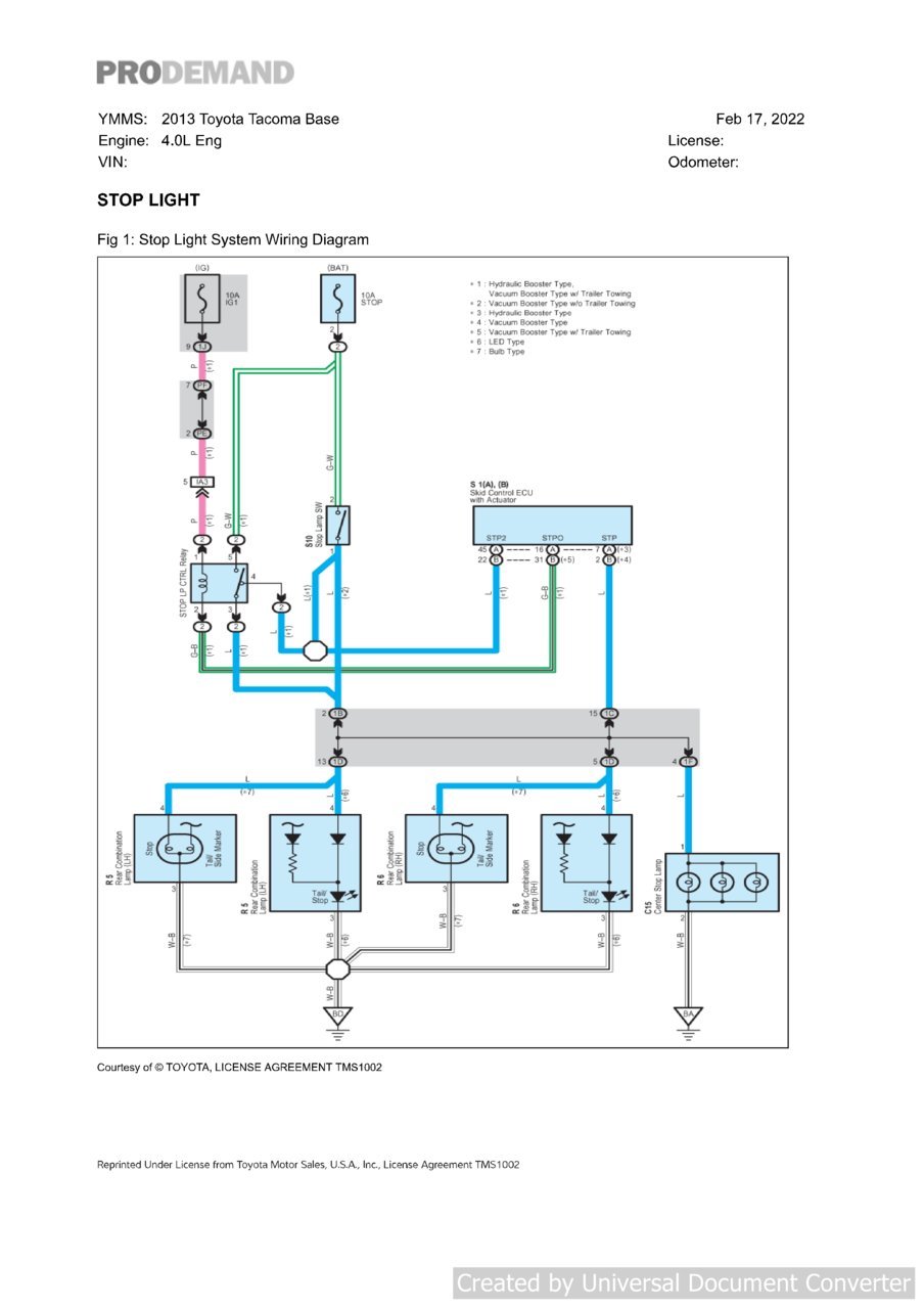

    There are 2 wires one is solid blue or green and the other is blue/green with red stripe. I know white & black is the ground. Diagram says blue but they look green to me. Just need to know the stop wire.

    My diagrams show the STOP light as Blue.
    And the Tail light as Green.
    Are you sure you are on the right connector?

    Brake light wire is Blue, Tail Light wire is Green.
