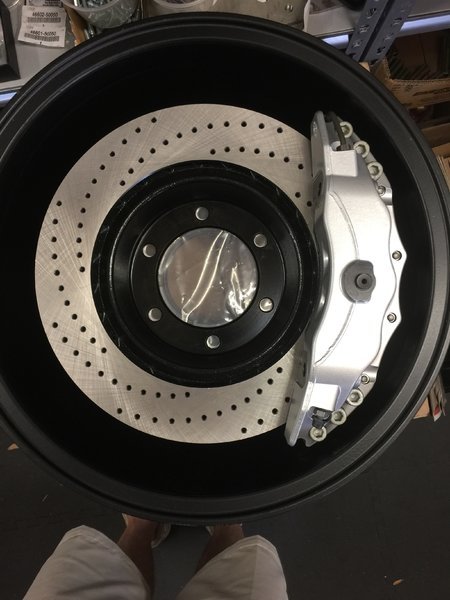

    anyone have this kit in 16" , fitted with scs wheels?

    09 4x4 Off-Road Access Cab
    Check out the build
    Here's a pic of the TR 323 (16" kit) on TRD 16" wheels.

    went to install my kit today but damn wheel doesnt clear caliper. the spoke rubs with the caliper. will either need to run spacers or get another set of wheels. sucks!

    i really want to get the 16" kit, but dont want to be a guinea pig. worried about gapping between wheel and caliper. hit/rub against wheel balance weights.

    Mine was hitting on the face of the caliper. So face of caliper/back of wheel spokes.
