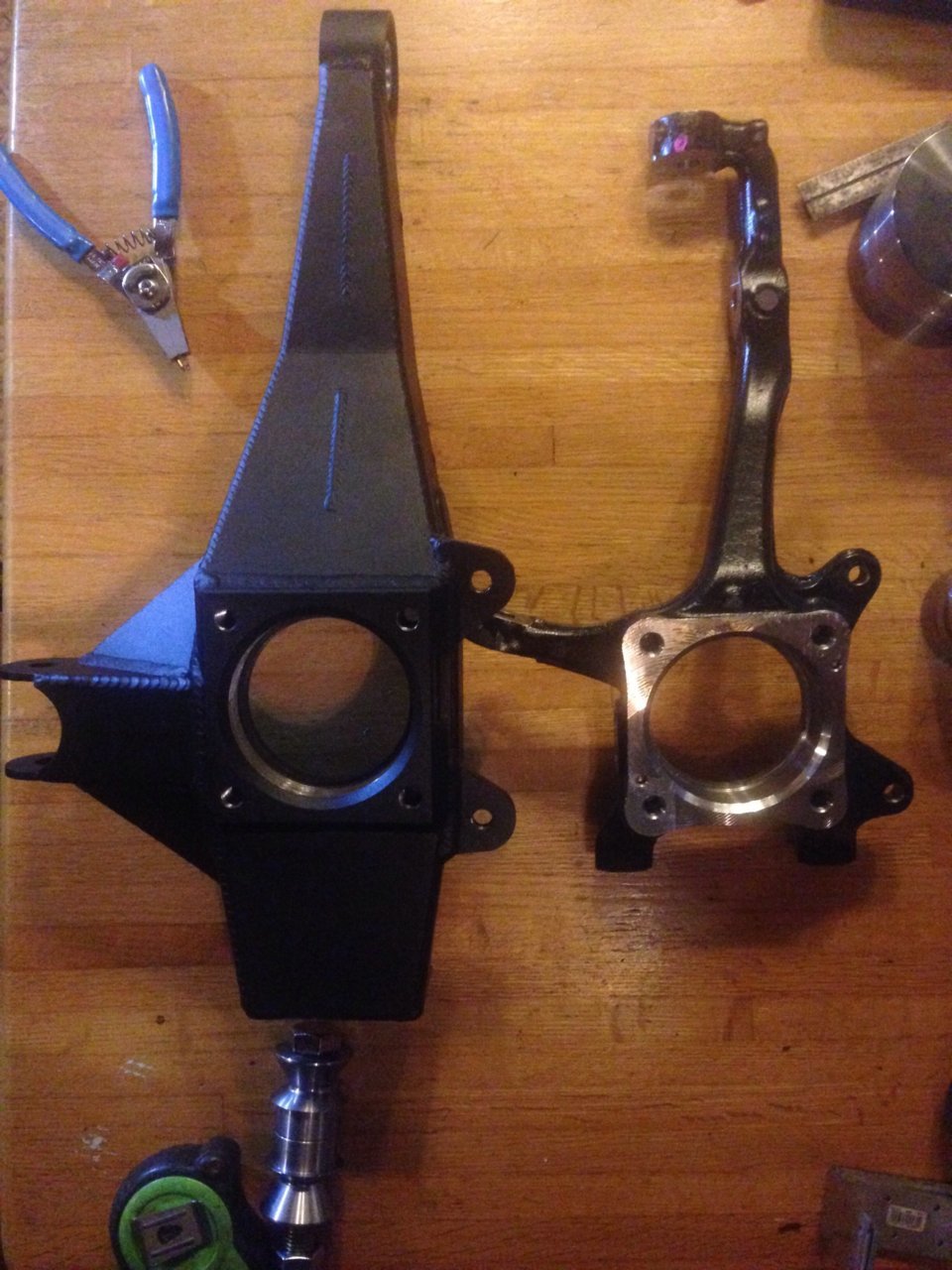

    I have the weld on bracket spindle reinforced from allpro. My bbk for 16” wheels fit fine. I did remove the backing plates. I am running the sos spacer kit.

    Totally different animal here

    I get that. I was just was just noting the allpro brackets fit. Haha.
    Those suckers are beefy, Huck it!

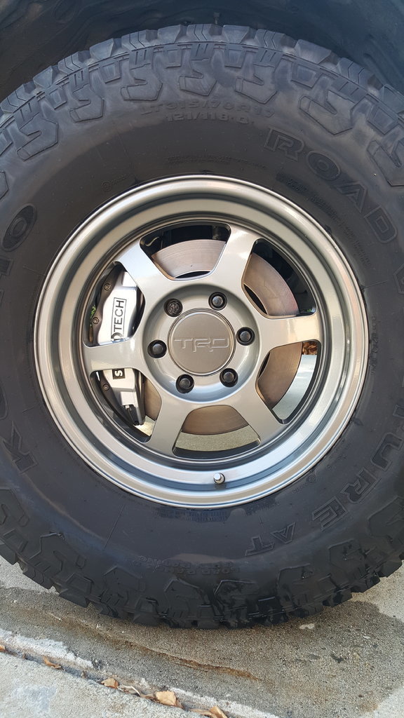

    ‘13 SUPERCHARGED DCLB TRD SPORT
    Where did you get those centre caps??
    06turd likes this.

    @TegoTaco Bought the center caps from Toyota and derp'ed them. Then did the center cap mod to make them fit. The center cap mod is essentially sleeving the cap so its a slightly larger diameter so it can be pressure fitted into the centerbore. There's old threads here on the DIY center cap mod.
