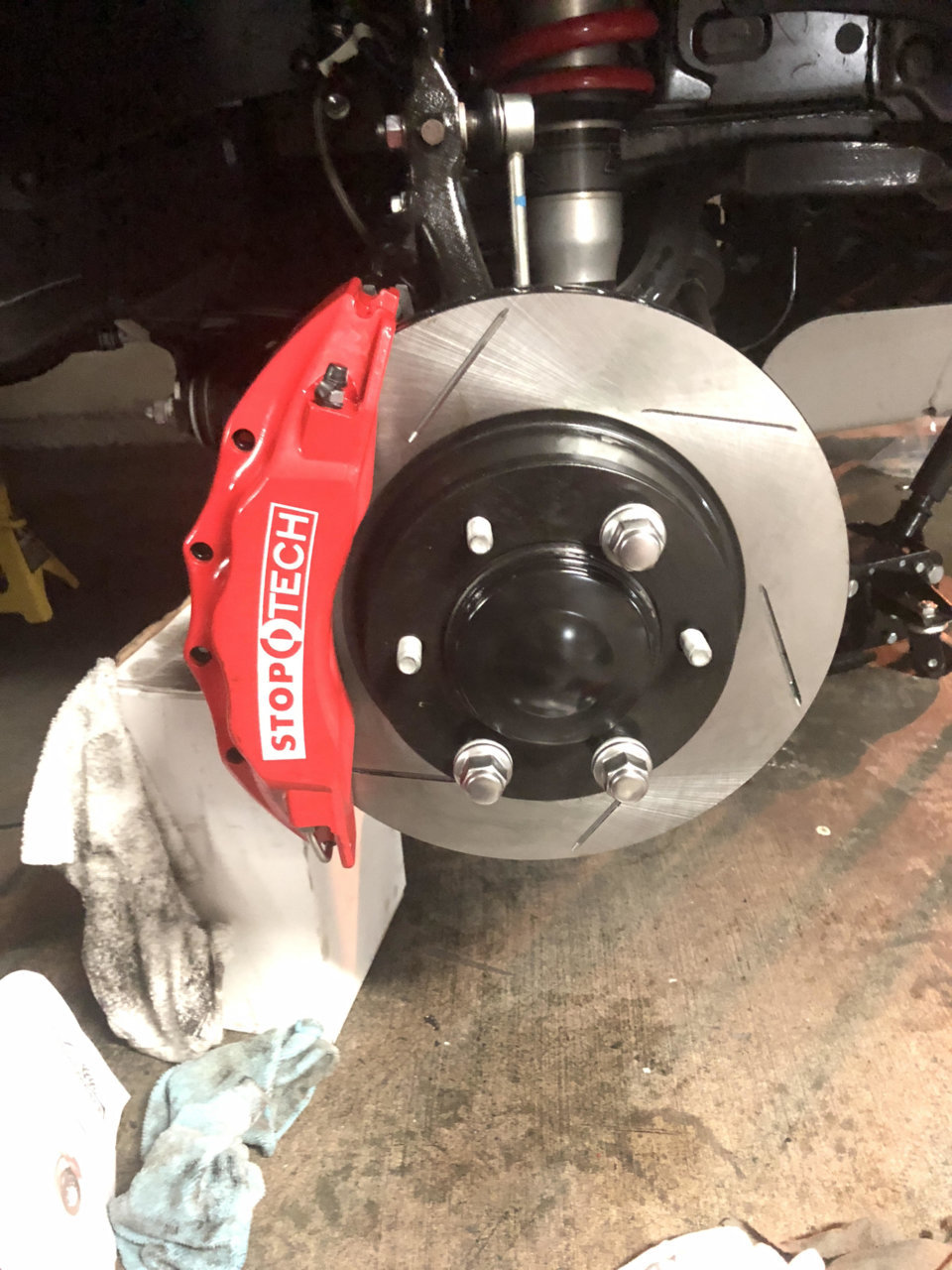

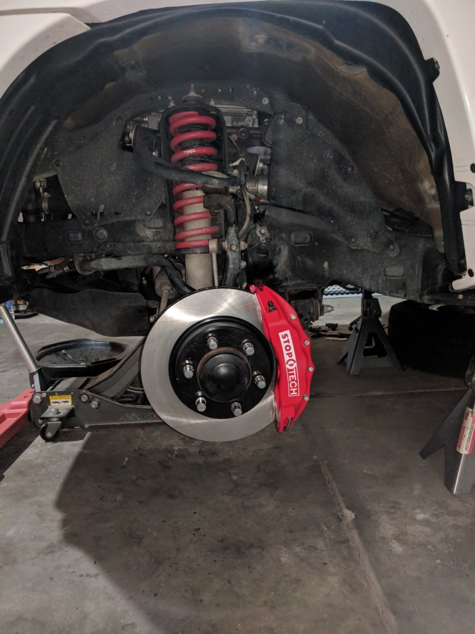

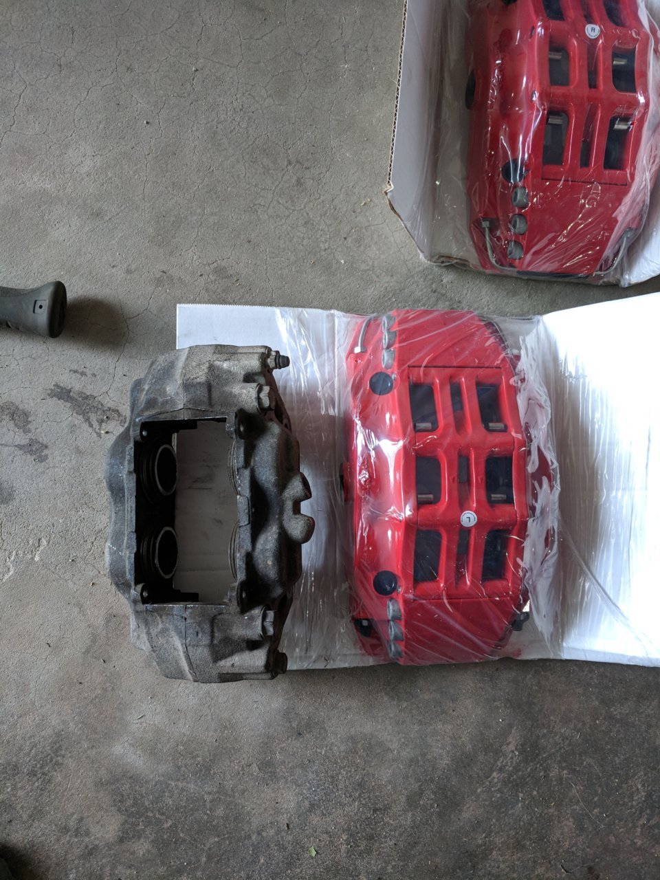

    I got everything but the SS brake lines installed tonight. Will finish it up tomorrow.
