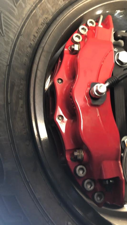

    Do you or anybody else hear rubbing with this kit on 16”s? I noticed a sound today with my windows down while driving straight by the beach at low speeds. Haven’t had time to test if it still makes the sounds during turns. It doesn’t sound like it did when it was stock and it’s annoying for sure.

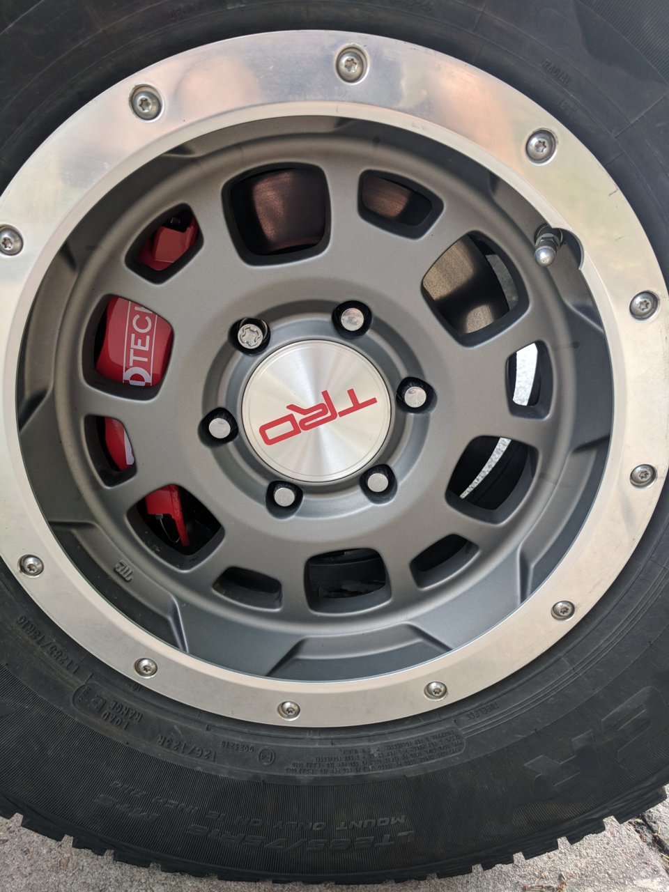

    no rubbing, but i have the '14 TRD rims.

    Nice rims. From what I can see you have a bit more clearance than I do. Sigh, guess I’ll be taking the wheels off again soon and figuring this one out! Lol

    Did you trim the dust plate back as far as you could? I trimmed as much as I could off mine.

    I trimmed it down to maybe an inch around on all sides. There is definitely rubbing on both sides. What could be rubbing? I really want to check but don’t have much time on my hands

    1. pull off tire
    2. spin brake rotor by hand.
    3a. if no rubbing noise, then rubbing is possibly caused by tire/wheel combo. (Check brake caliper or the inner wheel barrel for rub marks)
    3b. if there is rubbing noise, then rubbing is caused by bbk parts or possible installation error. (recheck parts/install process for clearance issue)
    If you've put some miles on your truck after the BBK install, there should be telltale signs of rub marks somewhere. If you are using 16" wheels with a BBK, there's minimal clearance already. Just because one particular style of 16" wheel may clear a BBK, doesn't mean any/all other 16" wheels will do the same. In fact, my new(ish) 17" wheel didn't clear my BBK when my old 17" (FN wheel) did without a problem.
