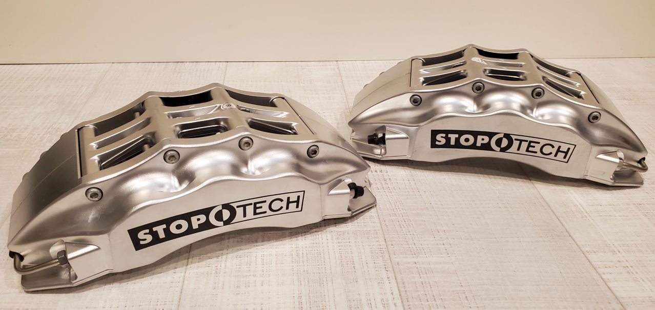

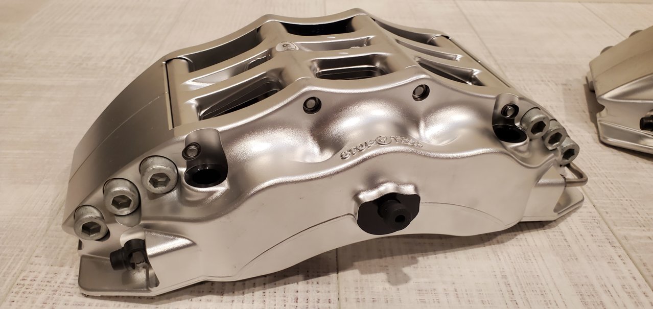

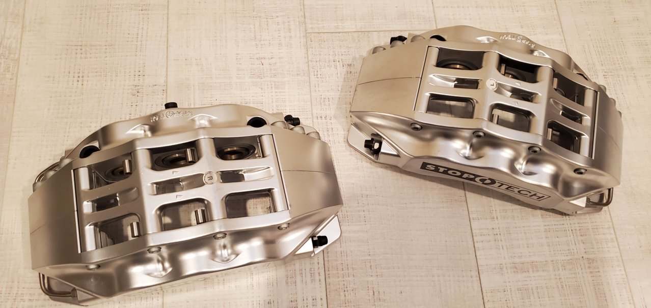

    Calipers just arrived and look great! Silver (special order) took some time to ship due to COVID, but it was expected. Tom was a pleasure to work with!
    Hope they work as great as they look :thumbsup:
