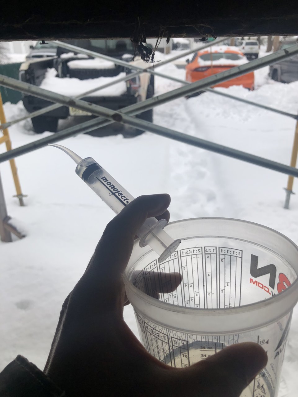

    Maybe I’m just confused, are you saying to put something between the firewall and the back of the pedal?
    If not, any rigging holding the pedal down towards the floor that might move even slightly would suck air into the system.
    I suspect there’s something more I’m missing. Regardless, I’ve had a lot of success changing out my brake components and fill new calipers and lines up as much as possible with these syringes. 619A4D86-237E-4C29-B9D2-C16FE03C3F8D.jpg

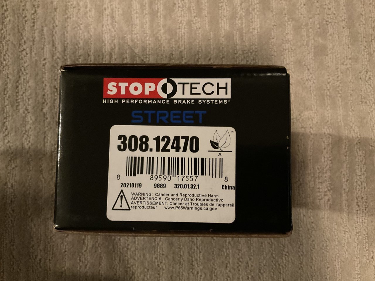

    Anyone have a link for replacement pads? Having a hard time finding them. SOS doesn't have replacement pads listed for the 6 piston Tacoma upgrade, only the Tundra, but then the Tundra ST60 pads are also out of stock. About to rebuild the rear drums and want to do the front pads at the same time. Been running these since late summer 2018

    I got an extra set of pads when I ordered mine. This is the box/part number.
    Currently out of stock, but maybe this will help someone down the road:https://www.amazon.com/dp/B01KHL1GHC
