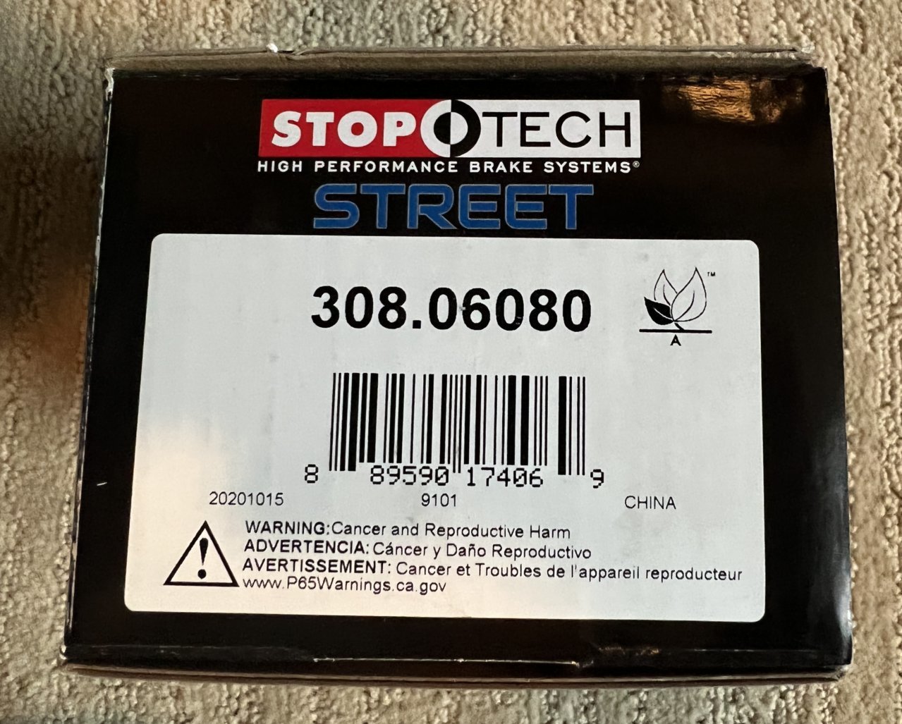

    I figured someone may be wondering about the pads for the Stoptech rear disc conversion as well.
