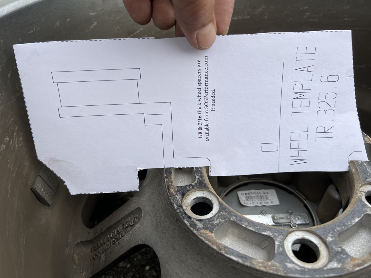

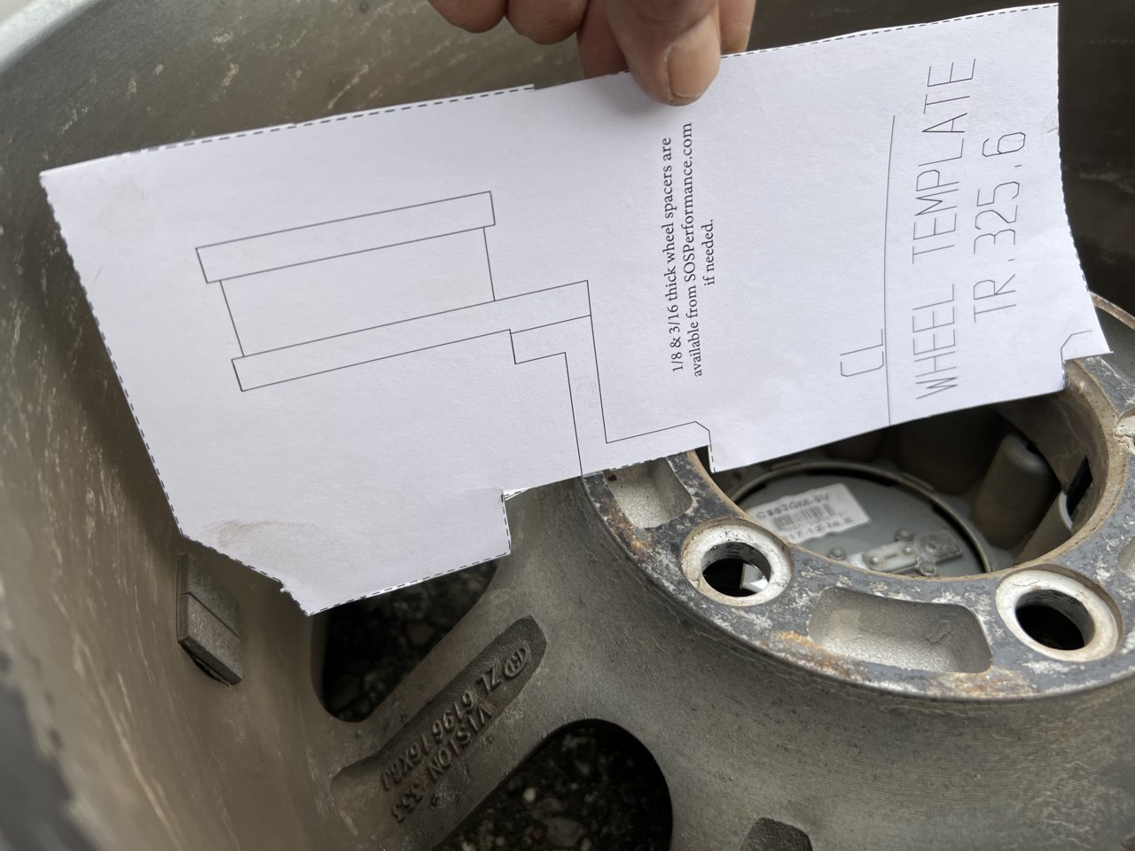

    Looks like it should fit, right?

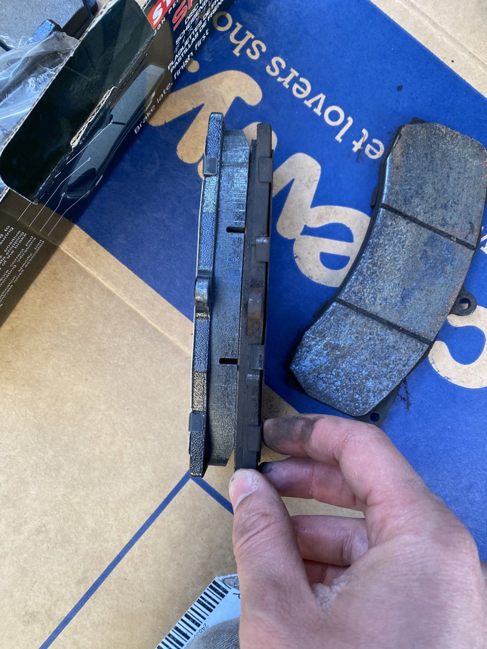

    SOS now uses Hawk pads on their kids as well instead of the sports if you want sport.

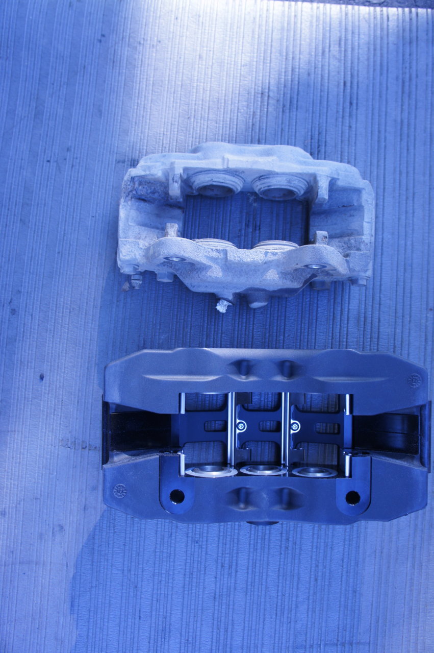

    What’s your wheels size? My BBK works in a late model 17” 4R wheels.
    Stock vs BB caliper

    This is what they ship with kits that do not want street and instead Sport pads. I got these on my front setup.

    !6". Looking at the 323 rotor. It's an AM wheel no one has or heard of, lol, a Vision brand 'Turbine'.

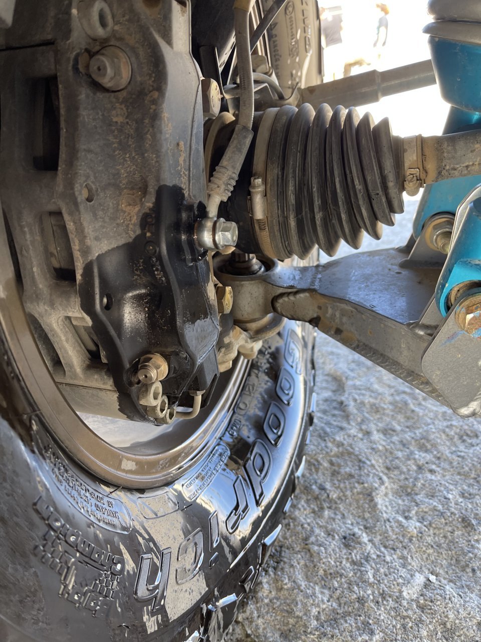

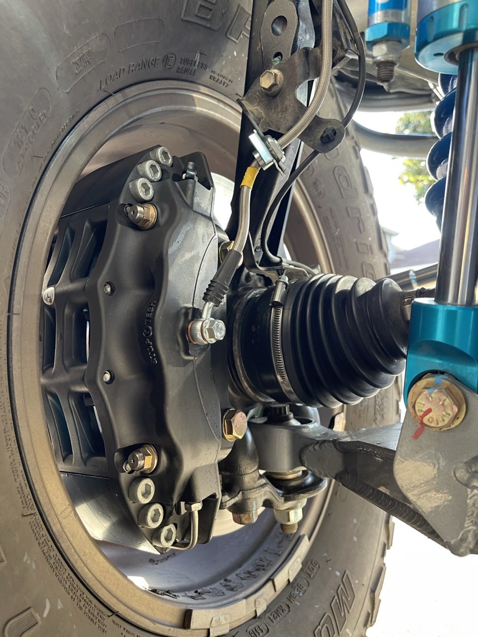

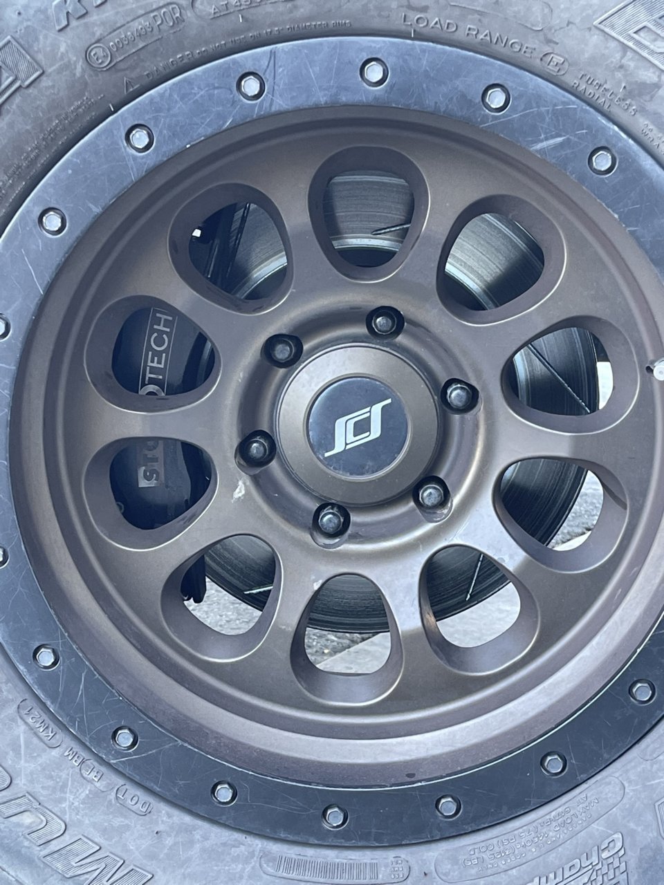

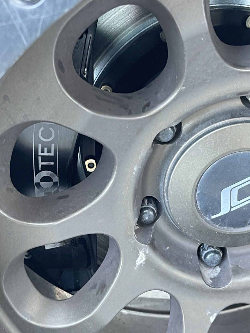

    Earlier this year I swapped my Willwood Kit (Aero6 calipers) to the Stoptech ST-60 kit. Went all in with 2 Piece Rotors. Went slotted due to the truck being a pig. Went with anodized flat black.
    I had a shop do the work as I was having some welding done. They removed my 4 runner backing plates and out in the spacers. I didn’t realize at first so for now I’m running it open.
    Also finally swapped in the rear kit I have been sitting on for a couple years. I think it was the same one mentioned that was sold on X runner a guy put together ( I have the calipers, lines and new rotors I’ll have for sale. Was able to use code for a deal on the BBK kit) I’m trying it all to help stop.
    Overall it’s been a great setup. I had the willwoods up front and stoptech rear for a short time while I waited for the front calipers which were back ordered for 6 months. felt hood. After swapping to stoptech F/R the pedal became super firm almost as if you need to push hard to stop. Not mushy at all and opposite.
    I also installed the e brake setup. My biggest complaint is there. My e brake is non existent. It’s been adjusted a few times by the shop that’s installed it but still becomes useless. I know it’s not as big as the stock Tacoma but uses the 4Runner e brake style in the rotor and should do something. Taking to Tom and a few people they noted they had no issue. I’m going to pull the wheels and inspect. My guess is a combo of e brake cable length and adjustment was not done correctly. Anyone have e-brake issues that did the swap? Any insights or things you ran into?

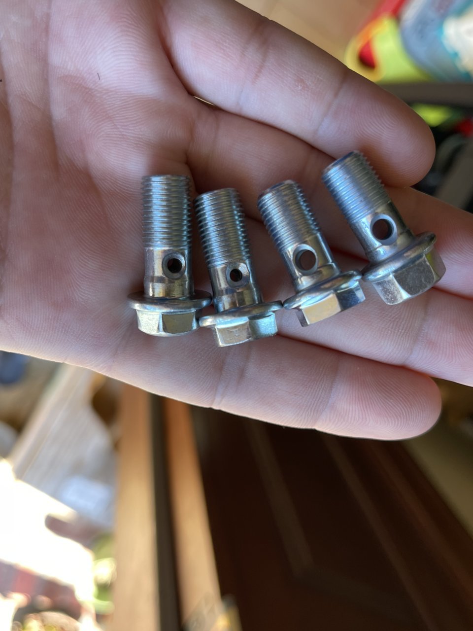

    The other item which came recently and Thai will go for anyone running LT and possibly Standard length with bypasses. Got luck but at the top of a mountain lost all brake pressure. At full lock the banjo came in contact with my bypass shock and has either vent or loosened it. A few folks have confirmed the same. I was able to tighten and get home with some air in the lines but none the less one thing is rather not happen again.
    Tom sent me some new banjos and I got some spares. He also had a kit of machined banjo bolts that lowered the head height to help with this issue. TBD but something to consider for folks running bypasses or if for is close at full lock.
    Now I just need to figure out the E-Brake issues and I’ll be set. For now O have limited some of the trips I have gone on. Especially after the last one with the banjo bolt.

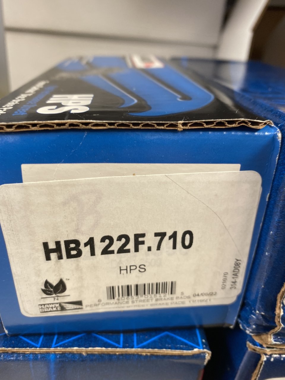

    hey do you have the part number for sports brake pads, i would like to know. Thanks in advance

    @madsand check these hawk out. this is what sos sends for the "sport" pads now.
