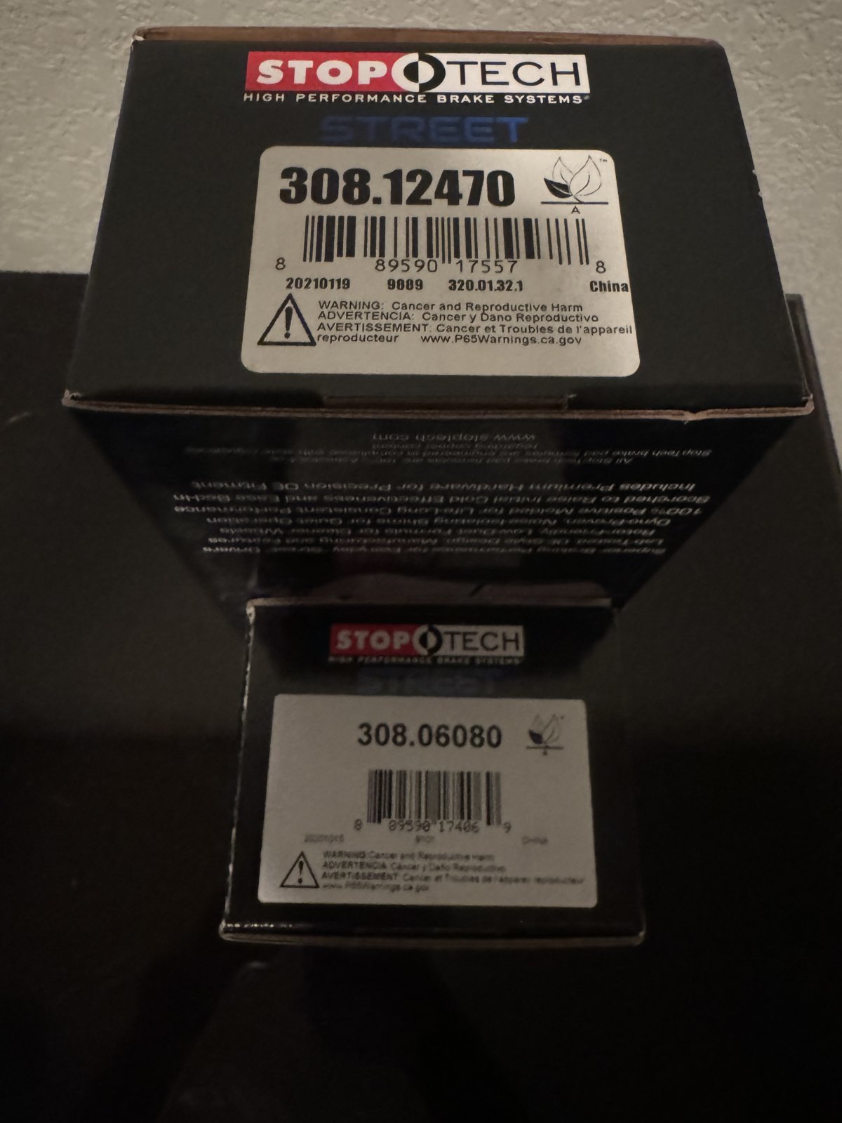

    anyone have the part #s or specs to replace the pads and rotors for the 6 piston 2nd gen kit? I have been searching with little luck in finding info on a kit I bought used servals years ago.

    When I needed replacements, I shopped for a brake pad that fit the Stoptech ST-60 caliper.
    And for the rotors, I'm pretty sure I searched for an application for the 340mm rotor found on the late model GX/4Runner.

    You can also look on SOS Performance. They use Hawk pads a lot now but also Stoptech sport pads work.

    These are the spares that I have for ST-60 fronts (top) and ST-40 rears (bottom)
    Speedo[QUOTED] and scootter82 like this.
