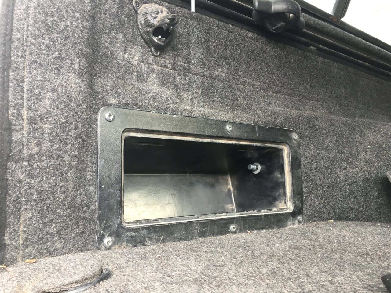

    Cargo straps and the rear diff breather on the drivers side and fuses, switches, and plugs for bed lights and anytime power on the passenger side. I pulled out the boxes and sealed up the openings to cut down on dust and water that gets in them.

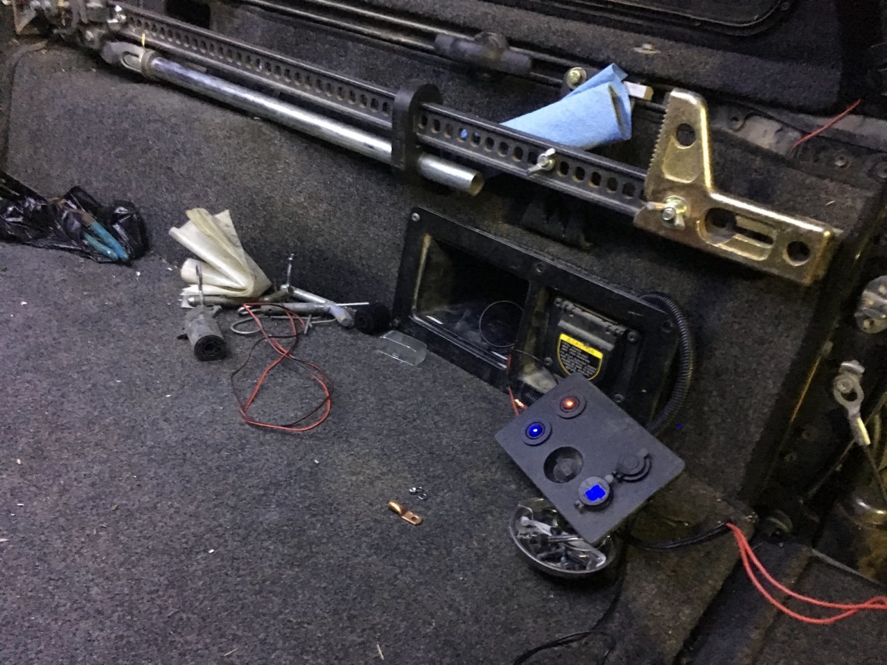

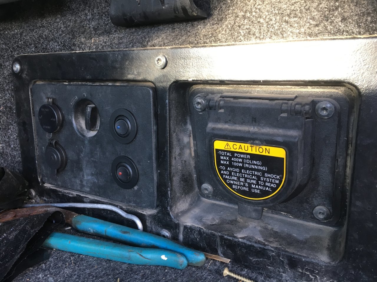

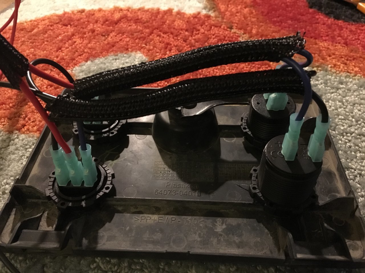

    @Domprerun, we camp a lot. I have a 2nd gen too...the outlet is standard on the TRD offroad, pro, and sport models (maybe the limited too). The problem with the factory plug is that it only has power when the truck is on. I ran power to the bed from the battery that I can turn on whenever. There is one 12v plug to power a fridge and two high output usb plugs with a voltmeter that are run off one switch and I added LED lighting to the underside of the shell as well that runs off the second switch.
    Here's a link to where I started the project in my build thread: https://www.tacomaworld.com/threads...ld-and-ramblings.452204/page-22#post-20091050

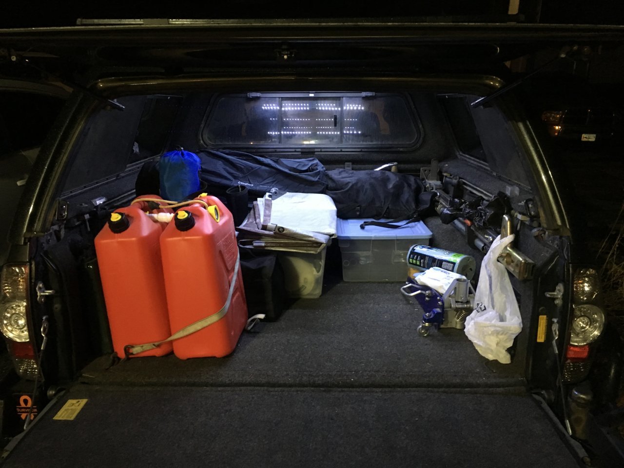

    The lighting and constant power have been game changers. This pic was taken around midnight the night before a trip and it's like daylight back there.
