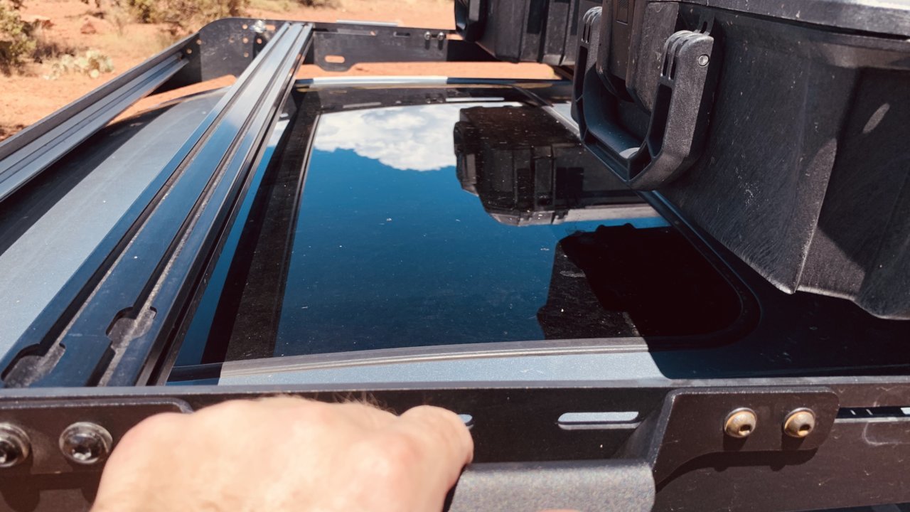

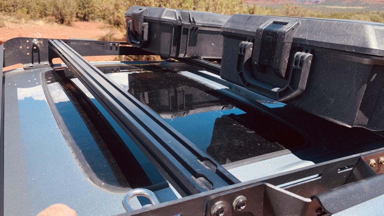

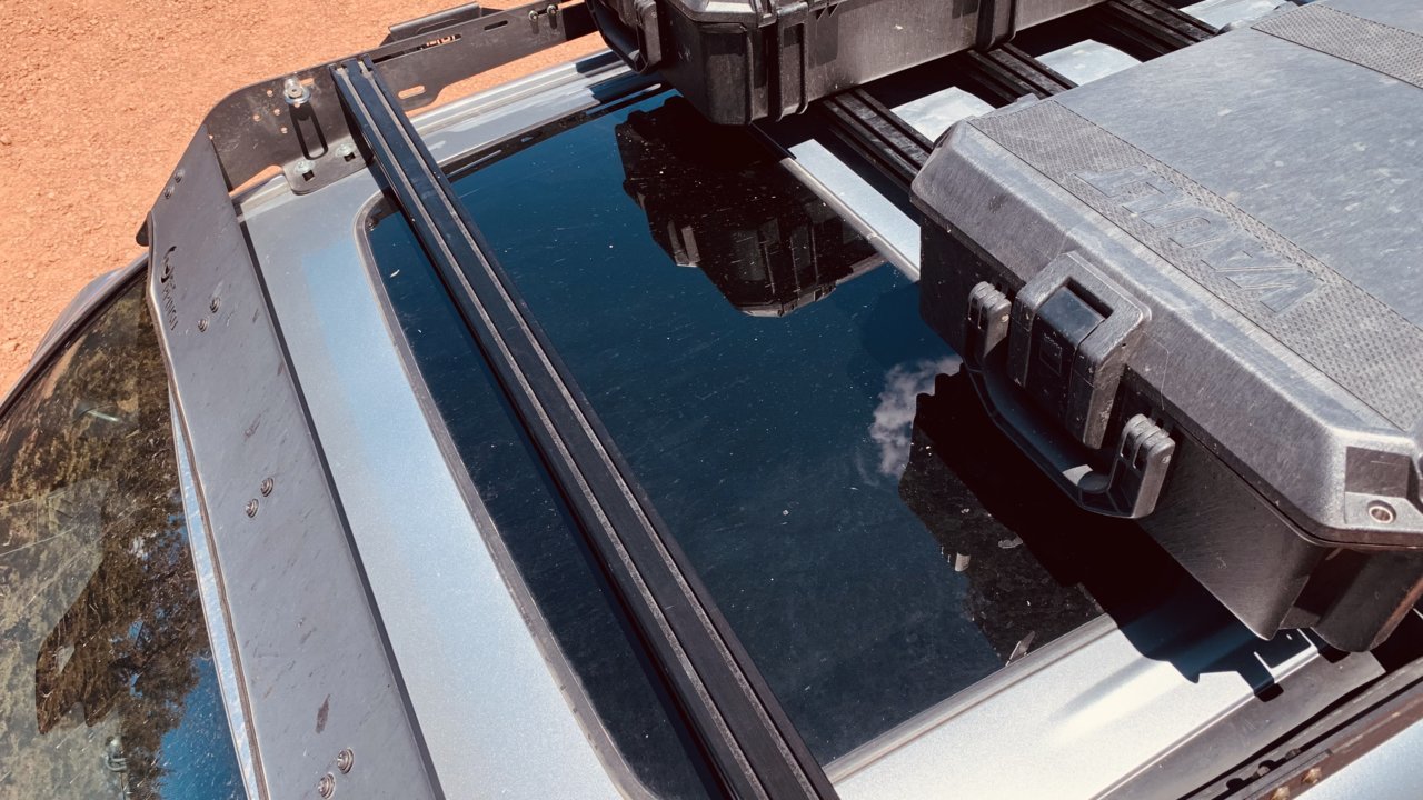

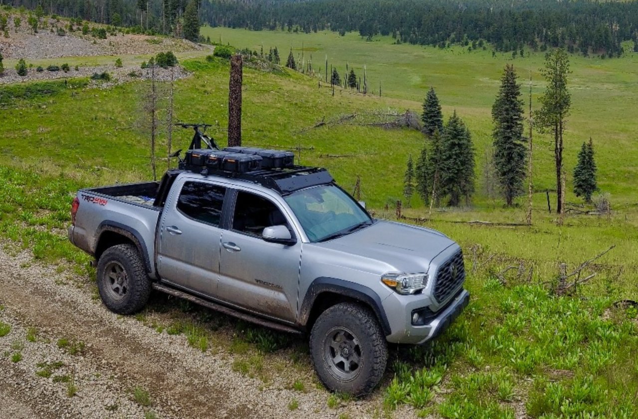

    I actually remembered to grab a more detailed shot while I was out on the trails yesterday. I’d forgotten that I moved my front-most crossbar back one slot to attach a pair of Prinsu grabhandles where I wanted them, but the moonroof is still mostly unobstructed & you can see the former attach point where I now have silver loops mounted.

    Thank you! That's really helpful. How's the wind noise? How do you like those handles so far? I found a Prinsu rack on offerup and bought it. Time to install it soon. :)

    I only hear slight windnoise with windows down while travelling at speed. I installed the rack more than a year ago, so I really don’t recall how much the noise increased or even if I truly even noticed it. It’s nothing at all to be concerned about.

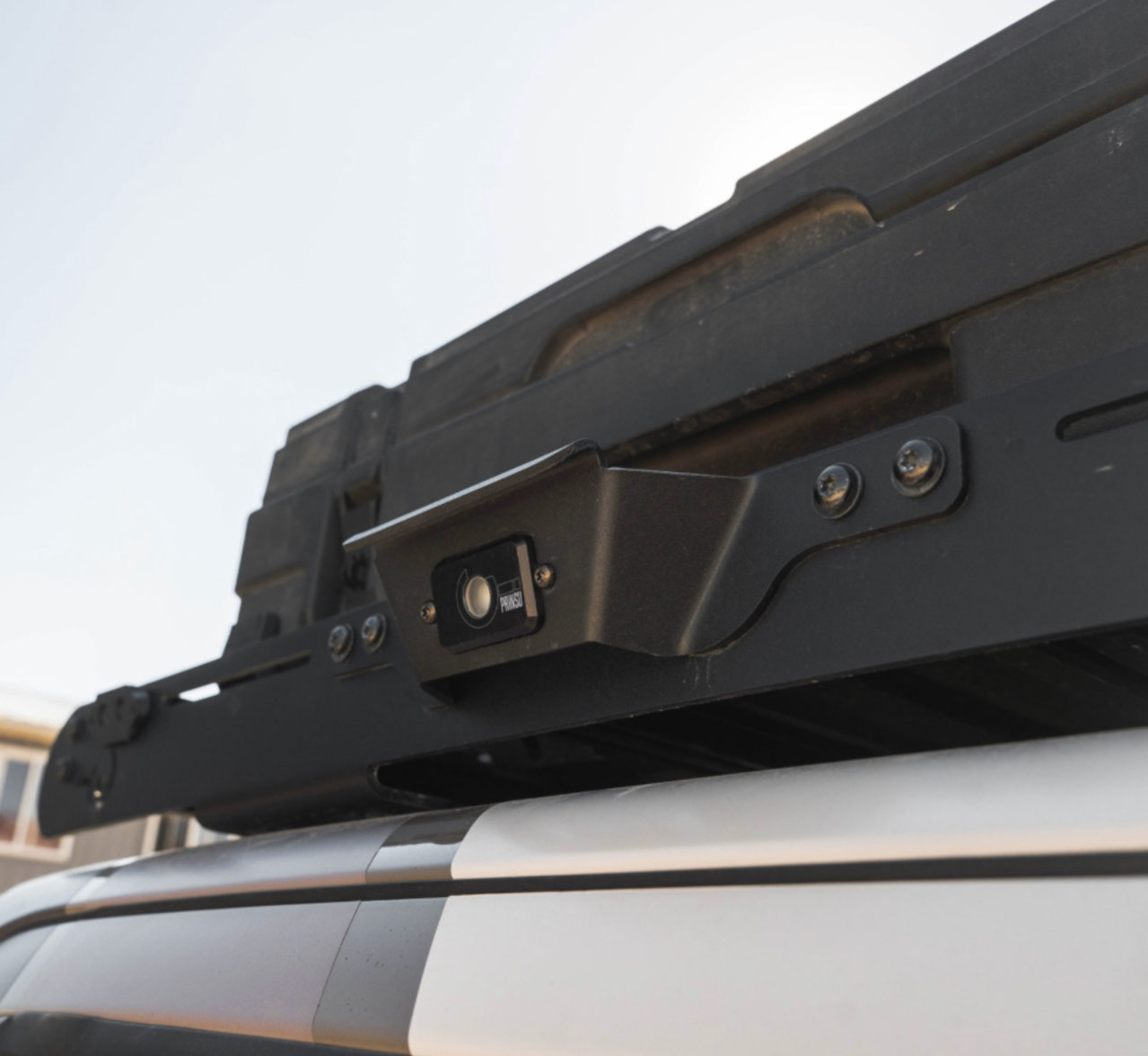

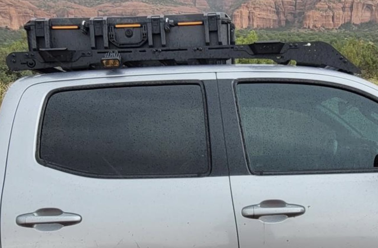

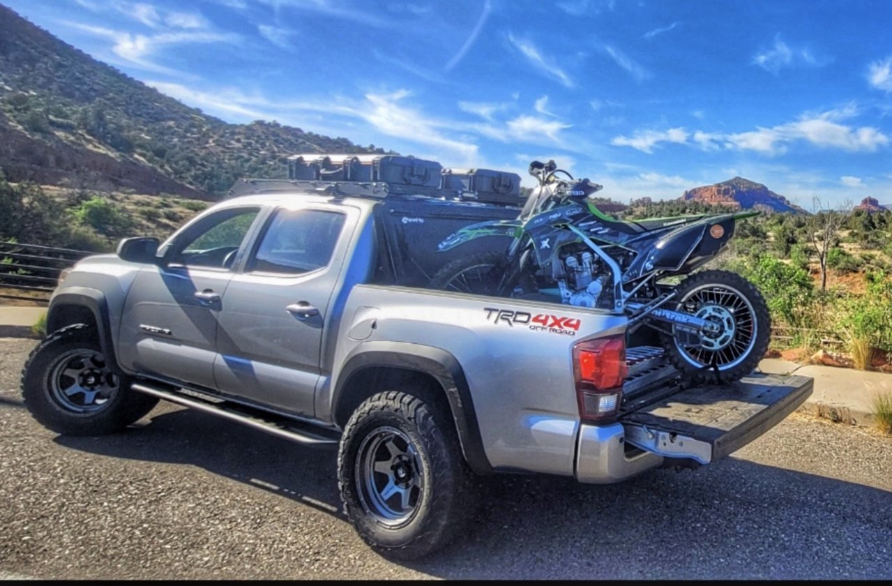

    I’m indifferent about the handles. I won a pair at Overland Expo West ‘22, so I installed them dead center on either side. On a whim decided I wanted a second pair, so I’d have two on either side. I already have some Diode Dynamics flood lighting on each side of my rack but the form factor of those lights doesn’t integrate very well on the side of the rack, so I’ll soon move/repurpose them elsewhere and use my existing floodlight wiring to power 4 Prinsu Camp Lights, which integrate directly into the handles for a much cleaner install. Long story short, if I didn’t already have my SwitchPros circuits run to the rack for my flood lights and had I not won a pair of the handles, they’re pretty useless and I’d never pay $250 for 4 little handles. I mean really, the rack itself serves as your handle. You don’t need a handle bolted to another handle. So unless you plan on adding lighting into the handles, I call them a waste of money at roughly $120 per pair.

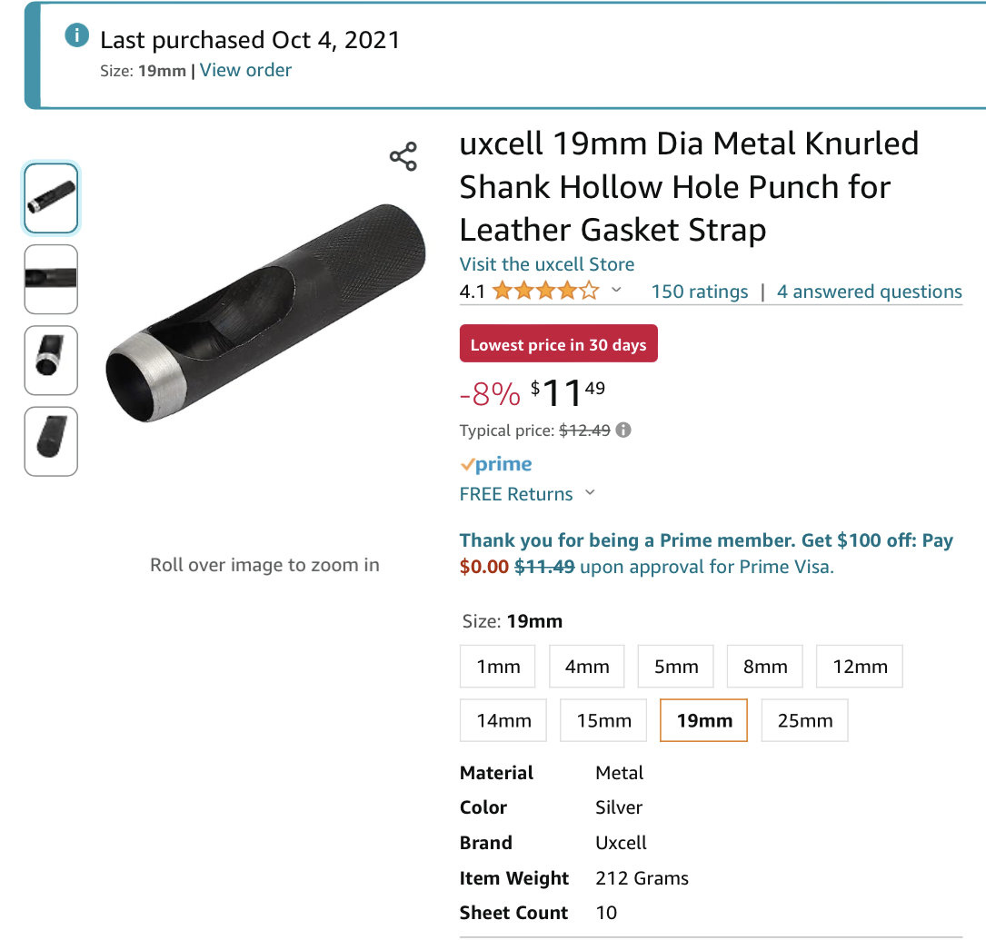

    A couple pro tips for installing the rack- you’ll need to remove the rubber trim pieces that sit in the roof channels to which you’ll bolt the rack. If you want to reinstall those trim pieces like I wanted to, you’ll need to create holes in the trim pieces for the spacers and bolts that affix the rack to the roof. The trim piece has a metal spine running through it, so if you try to drill holes through the trim piece, you’ll just hit the metal spine and your drill bit will move to one side and (worst case scenario) you’ll damage the trim piece beyond repair or (best case scenario) you’ll end up with a sloppy and chewed up trim piece hole that is off-center. I measured out my spacing for the holes, then snipped out with sidecutters a piece of the metal spine just slightly larger than the diameter of the spacer(you’ll need a razor to slice the piece of spline from the rubber trim once you’ve snipped through it), and I then used a 19mm metal punch to make super clean holes in the trim piece. I then installed the spacers using clear silicone into the channel over the threaded bolt holes in the roof, then reinstalled my trim piece. The trim piece holes will fit perfectly nice & snug around the spacers if you’ve been perfect with your measurements. Add some more clear silicone through the spacer holes into the roof channel bolt holes, then lift the rack into place and bolt it down. This will net you as perfect of an install as can be done, and you’ll have no possibility of water intrusion since you’ll have a tight seal from trim piece hole to spacer, from trim piece to roof channel, from spacer to roof via silicone, and from bolt to bolt hole via silicone.
    Attaching photos of my current Diode Dynamics flood lighting & the Prinsu lighting that will replace it, along with when I just had one handle per side. Also attaching a photo of the punch I used for the trim piece holes should you decide to do the same.

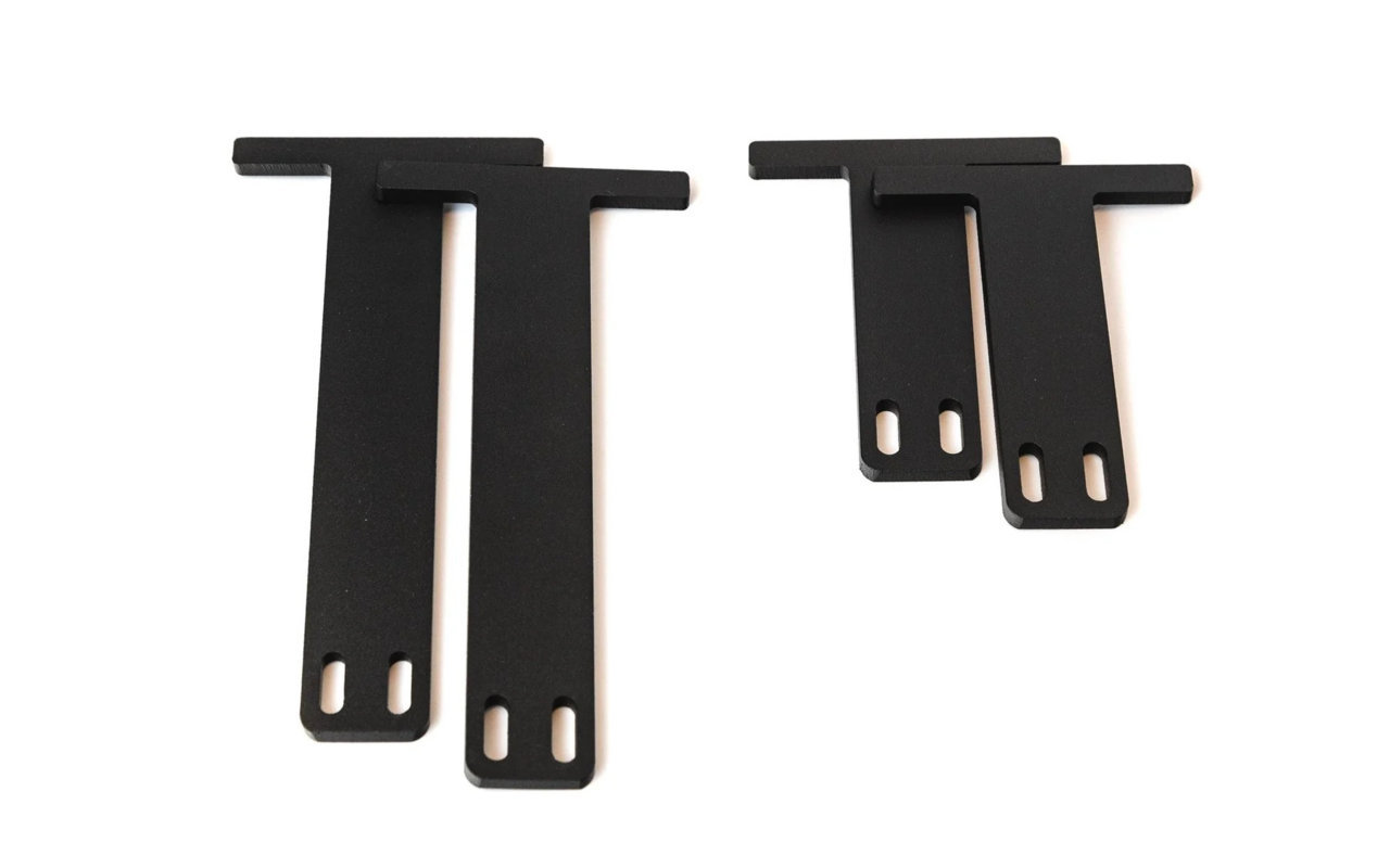

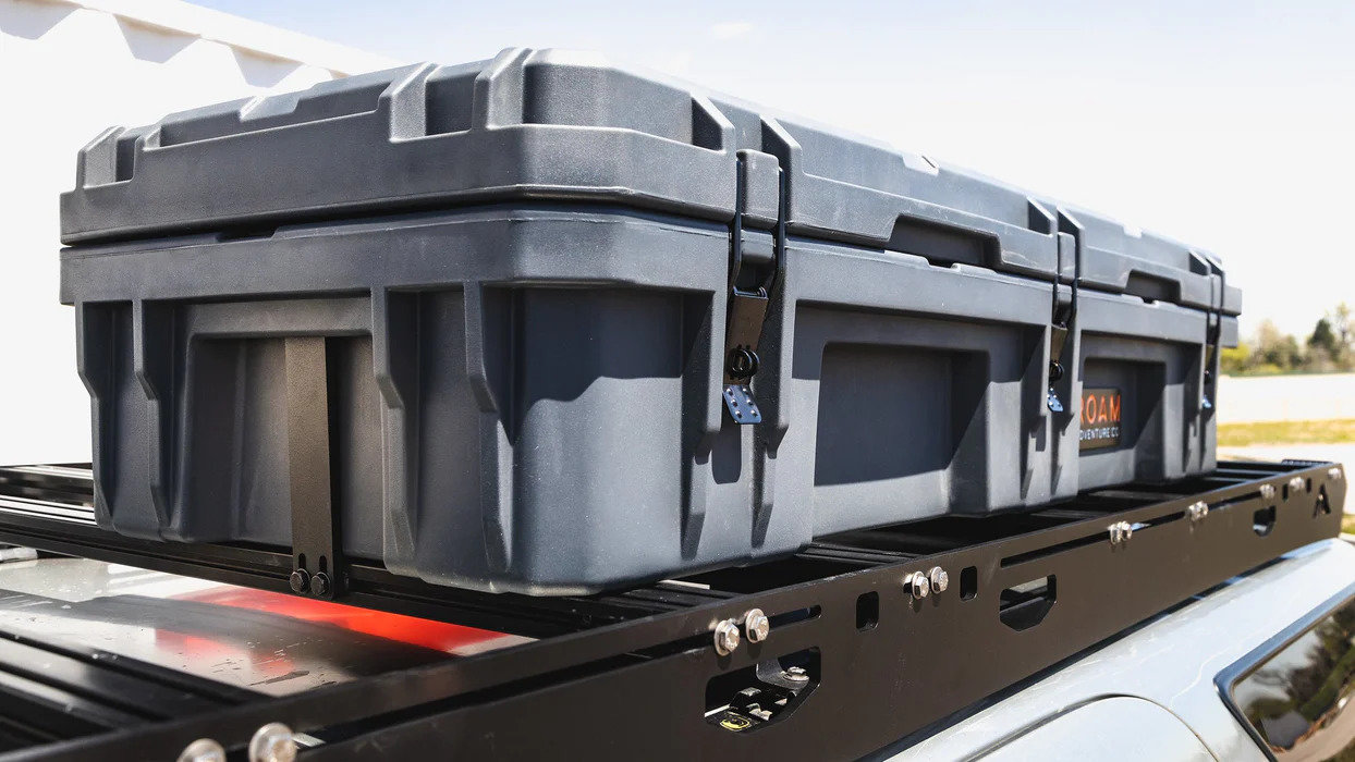

    These are the Sherpa mounts for the Roam cases. I’d planned on going this route until I found all the Roam cases were too long and would cover my sliding roof unless I mounted them side to side, which then negates using the Sherpa mounts, unless one fabricated some sort of adapter.

    Thank you so much for the informative description and photos, especially the installation tips. I will definitely take my time and follow your recommendations and grab myself a hollow punch as well. I agree, the handles are a bit pricey if you can just use the rack itself to grab on to. Tho your setup with prinsu handles with integrated lights looks clean. The handles give it a nice industrial look. Once I install it, will have to play with the setup and see what works me. Thanks again.

    How sturdy does it feel with those mounting brackets? Any play?

    Yup, those. I am planning on getting the 95L and mounting it parallel to the windshield (the short way vs the long way, parallel to the doors) - but now I need 2 additional Sherpa Roam mounts.
    It is a clean and simple install and reasonably priced. So far so good.

    Can’t say. I decided not to go with this setup.

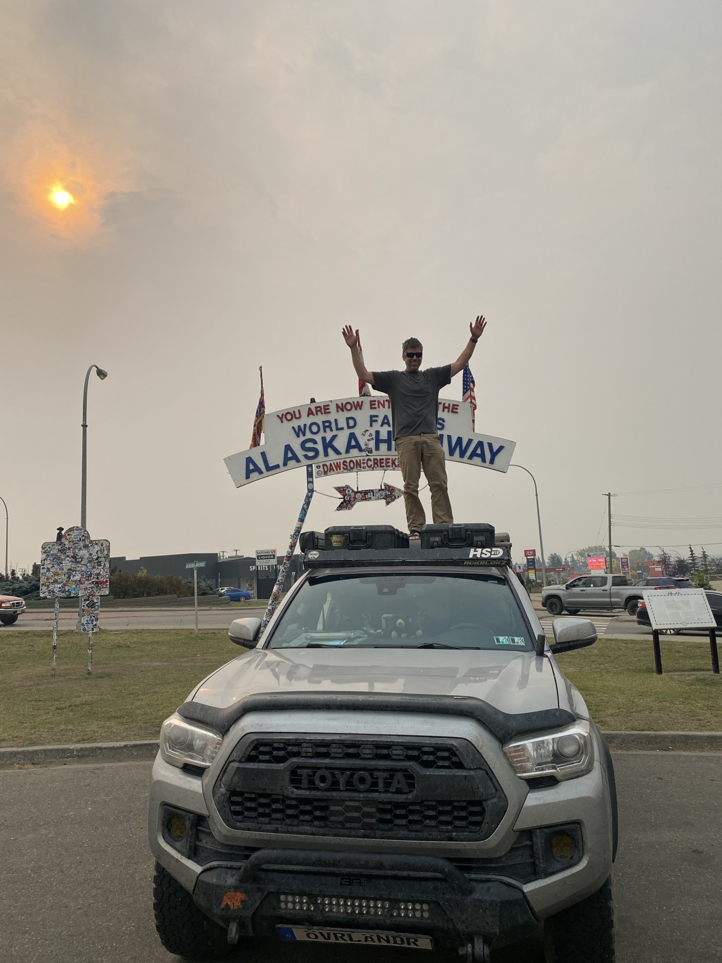

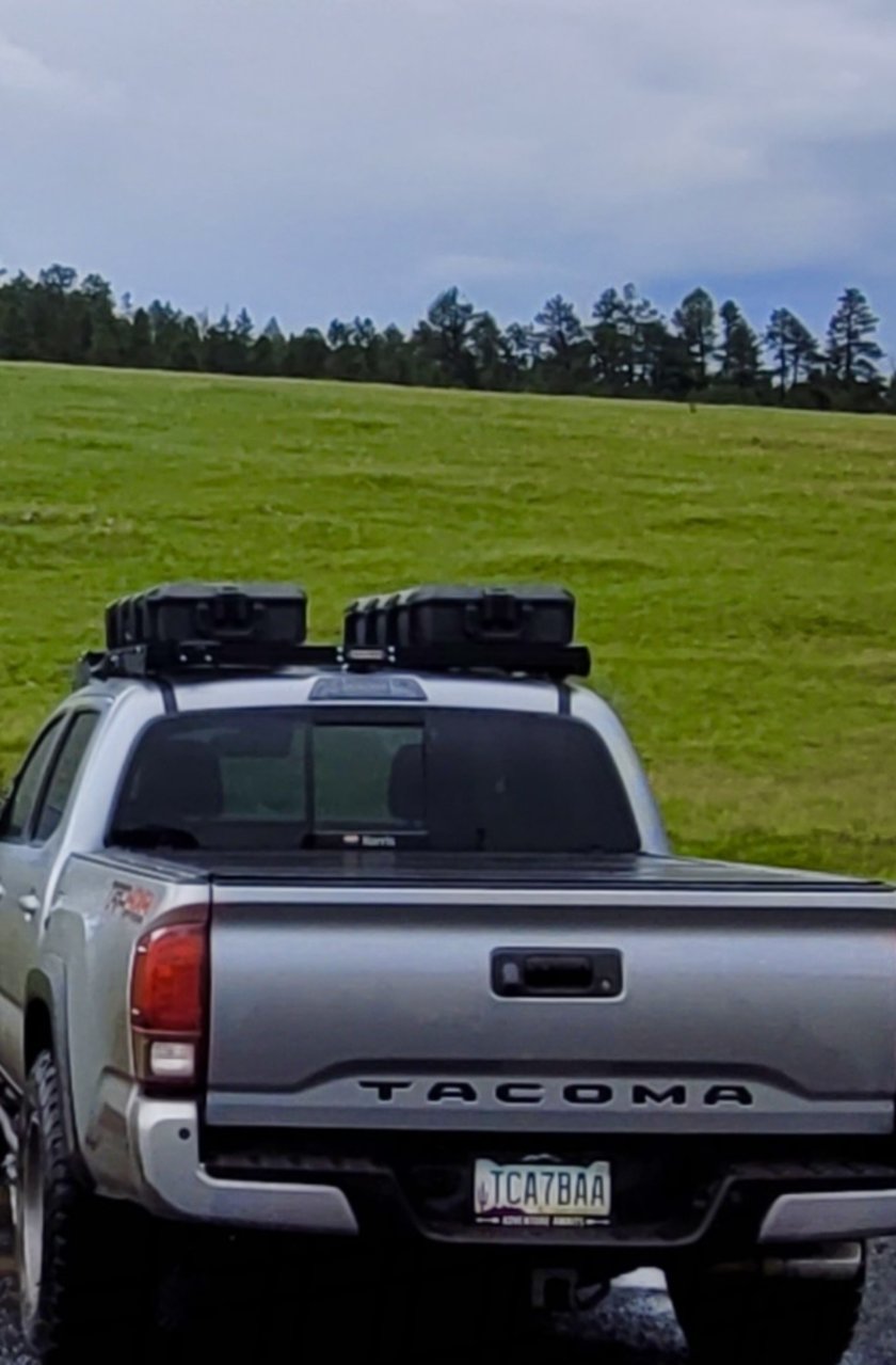

    Just got done with a 11,500 mile trip with the Vault cases. No leaks.
    Family of 3 so we needed the space.
