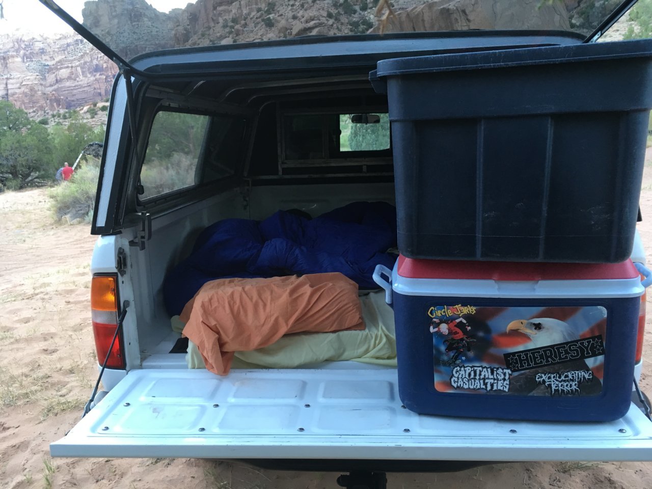

    I made a shallow sleeping platform with drawers thinking it would be neato, and honestly, it sucked. It was a lot of dead weight and even though it was only 8" tall, it made it a lot harder to sleep in the back or do other useful things a pickup truck can normally do. Without the sleeping platform, I can comfortably sit up and read in bed or change clothes. With the sleeping platform, I could not.
    The everyday stuff that's always in my truck easily fits behind and under the seat with enough room that everything's completely hidden: fire extinguisher, shovel, axe, breaker bar, jumper cables, tow strap, shackle, code reader, multimeter, spare bulbs & fuses, first aid kit. With all that I can still hide a coat, boots and day pack behind the seat.
    When I'm camping I have a rubbermaid container for tools, spare parts, camp stove and dry goods, a cooler and a 5 gal. water jug. I set up my bed before I leave home and fold it in half into a taco. Then when I get to my spot it takes mere seconds to move a few things and unfold my bed. I still have to occasionally crawl into the back, but this solves every other issue you mention. Note my friends in the background struggling with an RTT while I've already set up and cracked open a cold one.

    Thank you for the input. I guess I should utilize that area behind the seats more. I have some stuff back there but I bet I could fit more. The tubs seem perfect. I may do something similar to this for camping.
