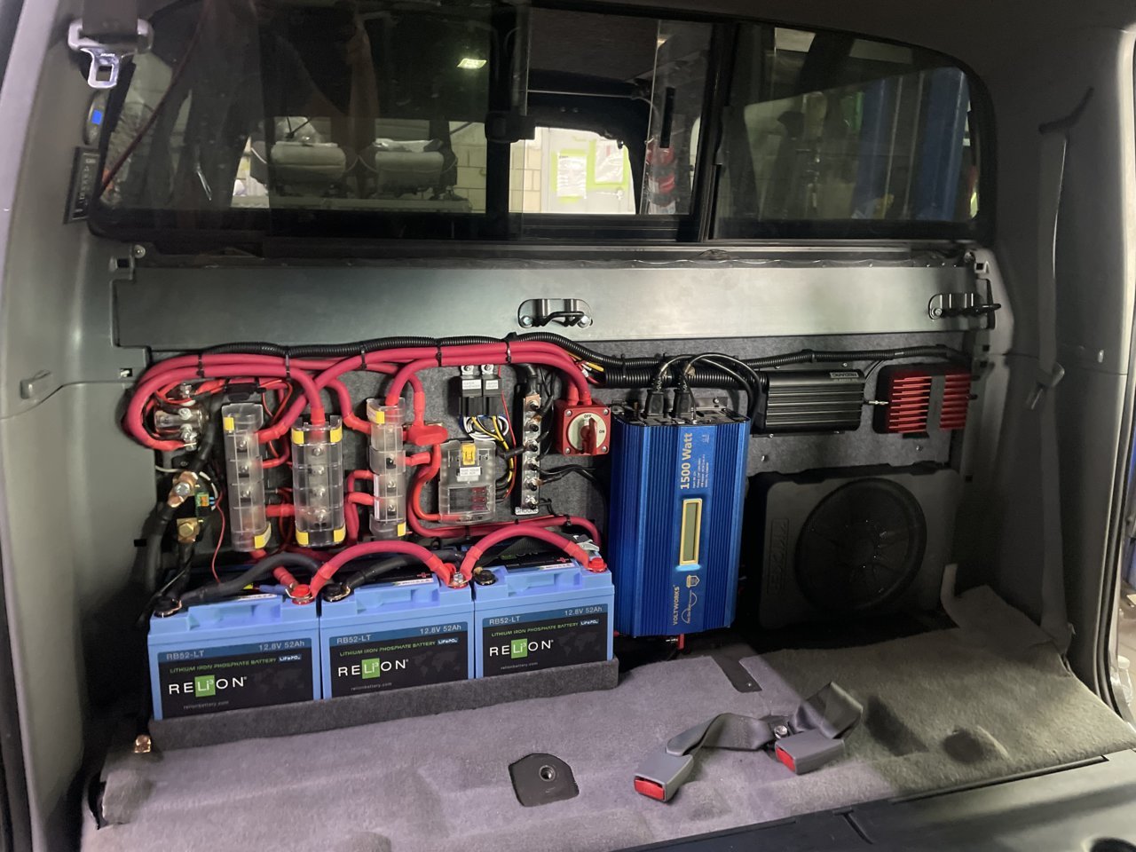

    I ended up going with the molle panel, but made it work by using these two items from Amazon:
    https://www.amazon.com/dp/B01DYSTH3K?ref=ppx_yo2ov_dt_b_product_details
    https://www.amazon.com/dp/B095P95C2G?ref=ppx_yo2ov_dt_b_product_details

    Wow that's an extremely clean setup, well done! I'm considering something very similar for mine but good to see someone actually did it.
    Couple questions if you don't mind:
    1. How did you affix the acrylic to the molle panel? I'm considering some rivnuts so I can remove them in sections for service and hiding wire behind the molle.
    2. Do you feel 1/4" sheet is rigid enough to hold everything?
    3. Anything you would have done differently?

    I used wellnuts. Honestly, might have just gotten a solid piece of aluminum machined to attach and cover the molle panel all together. Then don’t have to mess around with rivnuts/wellnuts. 1/4” as I have utilized is def sturdy enough—the sub is not mounted to the panel (it is mounted to the truck directly and the panel cut out around it), but the inverter is and it is quite heavy.
    FYI, there is a hollow horizontal strut/support beam that is a great option for running wires behind the panel too.
