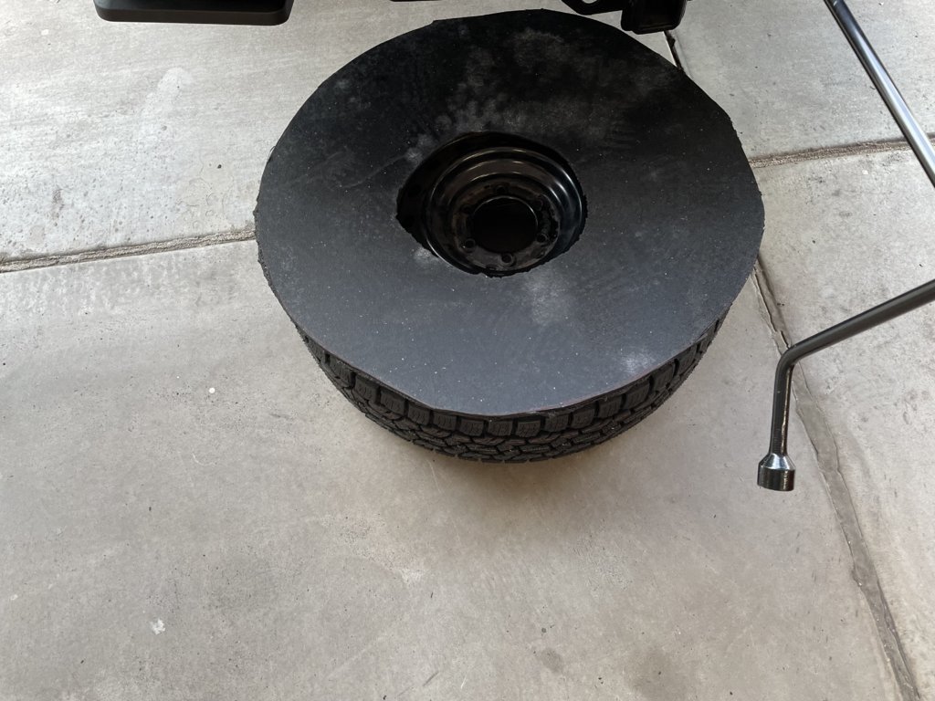

    Pick up a rubber stall mat from tractor supply and trim it to fit. Then sammich it between the top of the tire and the cradle. No more sidewall creases in the spare. :humble:
