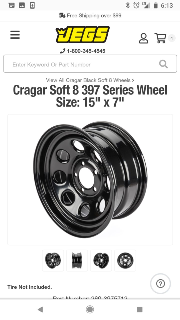

    CAN ANYONE CONFIRM IS THIS RIM FITS OUR 2nd GEN TRUCKS WITH NO MODS?? I know that they fit th 1st gen trucks no problems/mods. don't care too much about TPMS. Just want to be sure that these rims can clear our brake calipers. THANKS IN ADVANCE
    Here's another link to the rims:
    https://www.4wheelparts.com/p/trail...attern-satin-black-tm5-5865/_/R-DHGR-TM5-5865

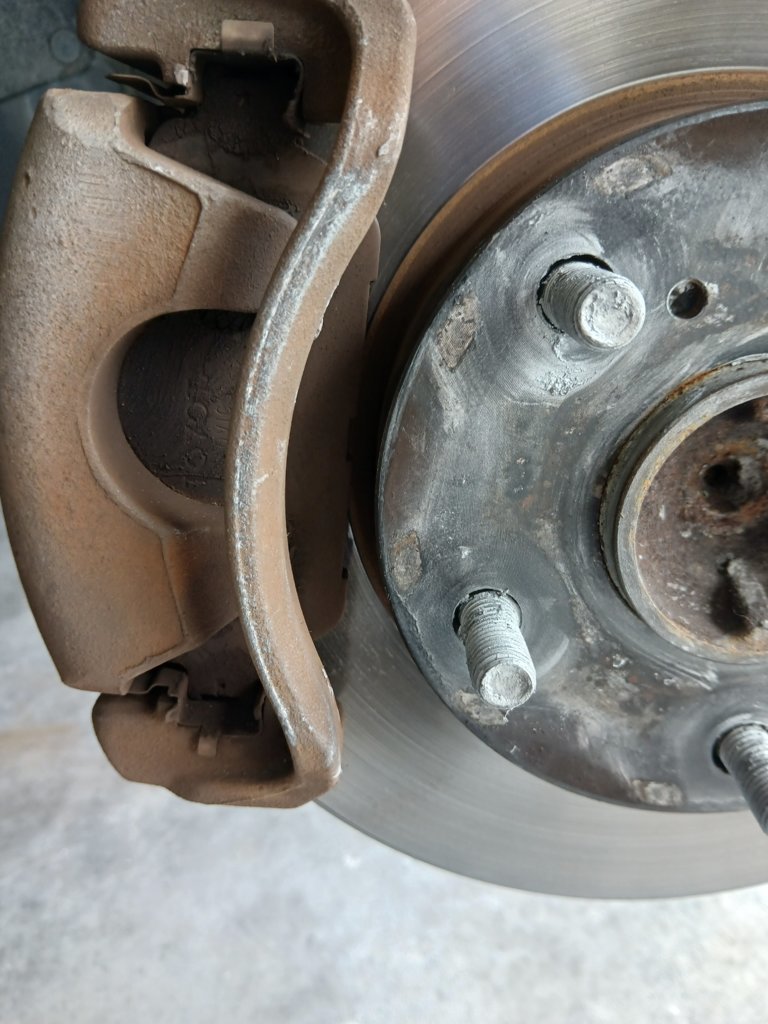

    I ordered a wheel from 4 wheel parts will find out next week

    The 4wp wheels above do not clear the caliper, it's close buy they don't fit once bolted down

    I have a 2008 Tacome 5 lug Access Cab. I bought 4WP Pro comp 7069 15X8 3.75" Backspacing with falken wild peak 31 X 10.5. The wheels DO NOT fit without modification. I had to grind the caliper. I also did the black box mod. The tires do not rub, even at full lock. However, they do rub if I hit a curb or speed bump, or have a total of 3 people in the car. But normal day to day driving, they do not rub.

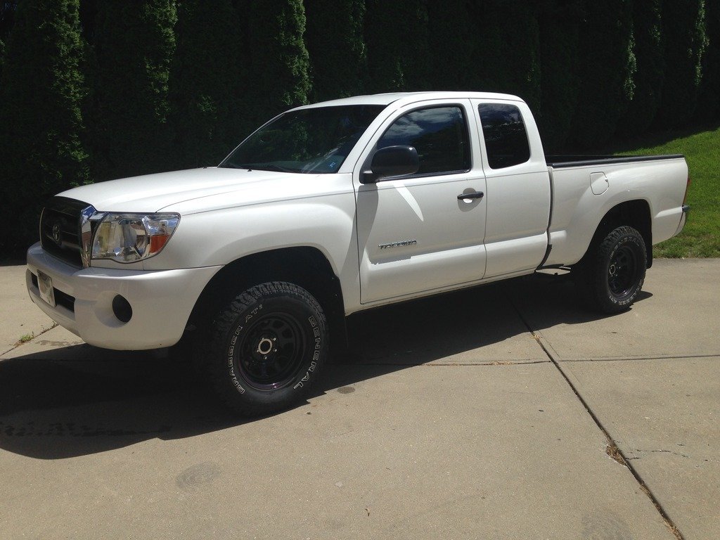

    I just wanted to say "Thanks", this forum has helped me so much. We got our son a 2012 5 lug double cab sr5 for his sixteenth birthday. The wheels and tires needed help.
    I tried to go the quick route and get a set of 5 lug wheels of off the facebook market place, they didn't work. This forum saved me.
    Cragar 15x7 and 235/75/15 BF Goodrich rugged terrain.

    TheRESONANCE
    TheRESONANCE New Member
    Sep 5, 2008
    #9019
    3
    Has anyone discovered any other black rims that will fit w/o spacer or caliper grinding?
    Really trying to get a bullet hole style rim as opposed to the D-windows, but can't really find anyone on the 5 lug forum who has been able to do it without some form of mods.
    Not sure if anyone has confirmed if the cragar 'soft 8' fit ?... Honestly i'm kind of wanting an alloy rim to save some weight since the 4-banger seriously feels underpowered to me.
    https://www.americanracing.com/product/wheels/ar172-baja/
    The website filters that the 15x8 +20 offset (5.29 backspace) fits.
    Offset and tire clearance wise, I feel that it would fit and be fairly flush with the fender provided the rim clears the caliper?
    An old post of Rota grid offroad 16x8 +20 offset w/ 235/70/r16 should really be simliar to that of a 15x8 +20offset w/ 235/75/r15 if I'm looking at things correctly?
    Since I have never test fitted any rim I don't have any experience in how/where the rim interferes with the caliper..
    I have seen previous posts of the American Racing Baja AR172 in 15x7 -6 offset not really fitting without spacer--- Does that mean the 15x8 +20 offset version won't fit since it will likely have the same inner geoemtry/dimensions?
