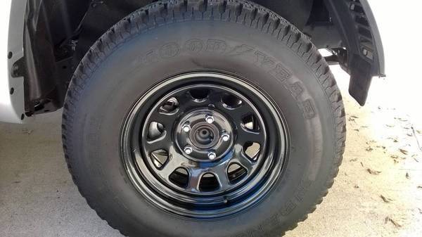

    I removed the ugly red and blue Cragar stripes. Fast and easy with acetone.

    Way better! I am SOOOO doing that! :)

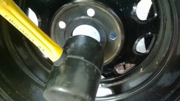

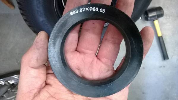

    If you have these wheels, I highly recommend these hub centric rings. Dirt cheap right now on ebay. http://www.ebay.com/itm/140927444133?ssPageName=STRK:MEWNX:IT&_trksid=p3984.m1439.l2649
    These rings eliminate the vibration caused by non hub centric wheels. Just pound them into the back of your wheels with a rubber mallet. The Cragar wheel bore is 83.8mm. My hub size is 60.1mm.
    This specific size is needed for my truck. (Measure your hub diameter to be sure). 83.8mm OD 60.1mm ID

    never seen these before. They center better than the lugs? Have you noticed any difference before and after?

    You will only notice any difference at higher speeds. (60mph plus).
    I do alot of freeway driving and noticed less steering wheel vibration right away.
    These rings basically turn the Cragar wheels into hub centered wheels just like the stock steel wheels I replaced. Are they necessary? No. If you carefully star pattern tighten the lugs with the wheels off the ground, you are very close to perfect center. But for $13.88 and free shipping for all 4 rings this is a no brainer for me.

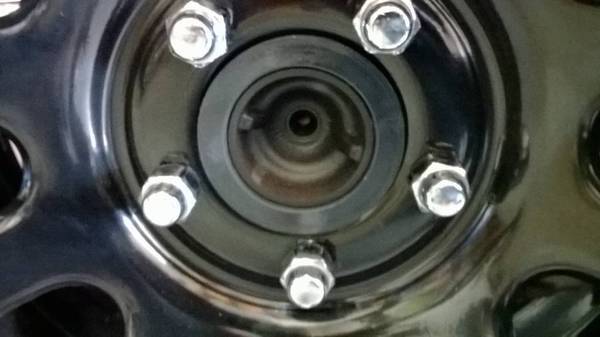

    A couple more photos. Notice the gap around the hub is eliminated. So is my steering wheel vibration. Back to factory feel driving.
