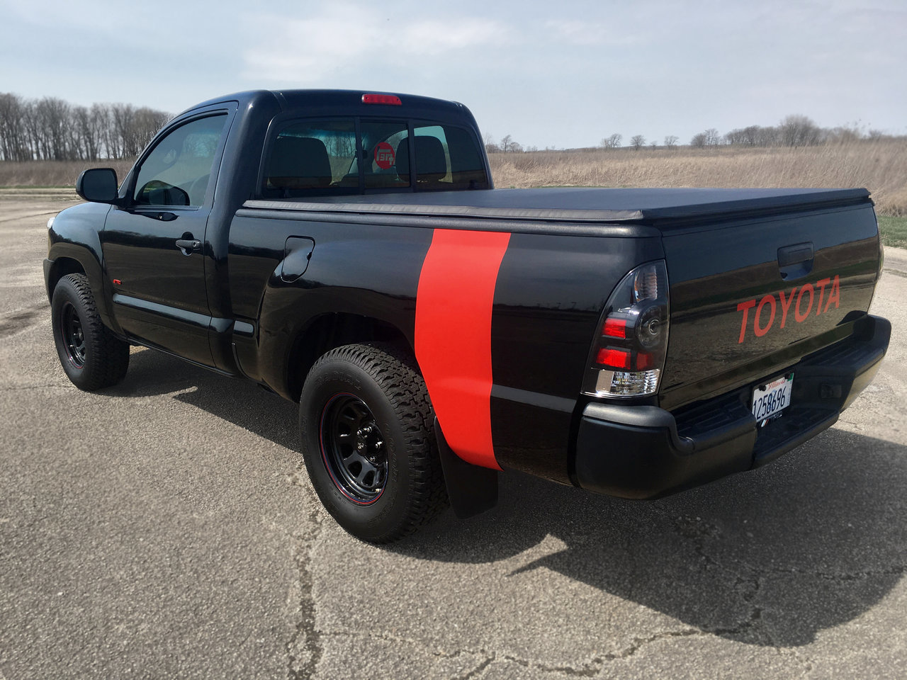

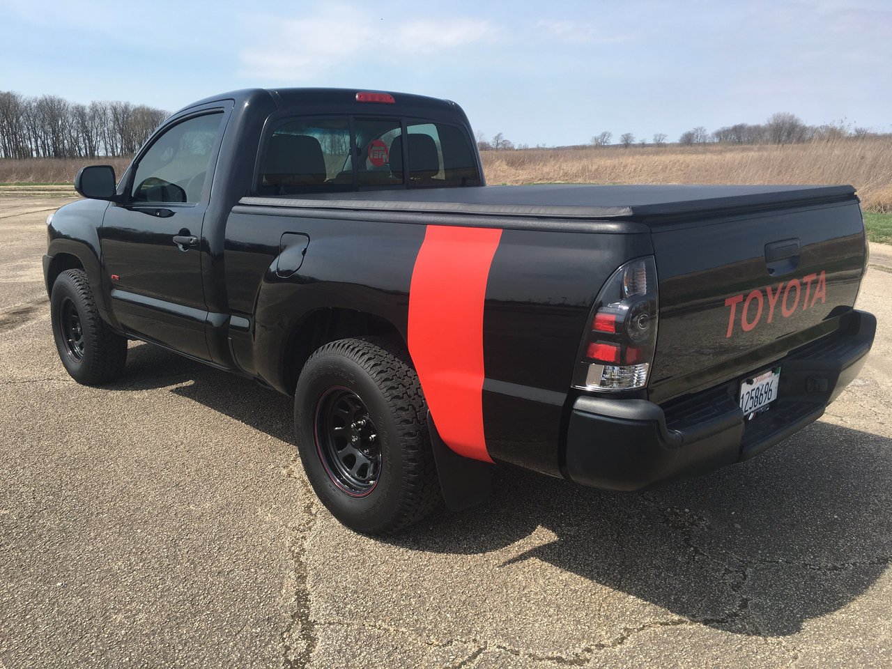

    Here's my 2013 running these rims after I discovered them in 2015. Completely changed the look of my truck. Thanks for finding these OP @gitsum

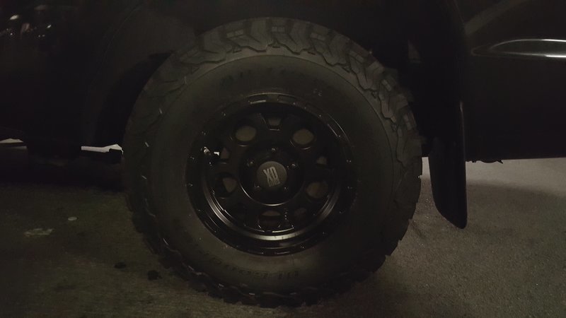

    Here's the info:
    2007
    Part Number: XD12257012706N
    Size: 15" x 7"
    Bolt Pattern:5x114.30
    Offset: -6
    Backspacing: 3.76
    Sorry for the dely in replying :rolleyes:

    epic - and you did say no caliper mods needed? Were they hubcentric?

    Nope no caliper mods needed...as far as being hubcentric...I really don't know sorry.
