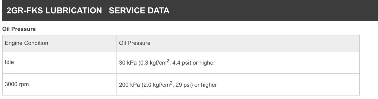

    If it was a case of low engine pressure.
    The engine is likely done.
    That light doesn’t come on until it is less than 4 psi.
    And that’s at idle. Not good at all of it dropped that low while actually running at 1,700+ rpm.

    Toyota says 4.4 psi or more at idle is ok.
    I’m not sure, what you’re not sure about?

    It’s not that it comes on “late”.
    It’s that it doesn’t come on until is critically low.
    You’d think with all the technology we have, we could turn the light on at different pressures.
    But not the case here, it is 4.4 psi or less before it comes on. 5 psi is ok at idle, but not at 1,700 rpm.
