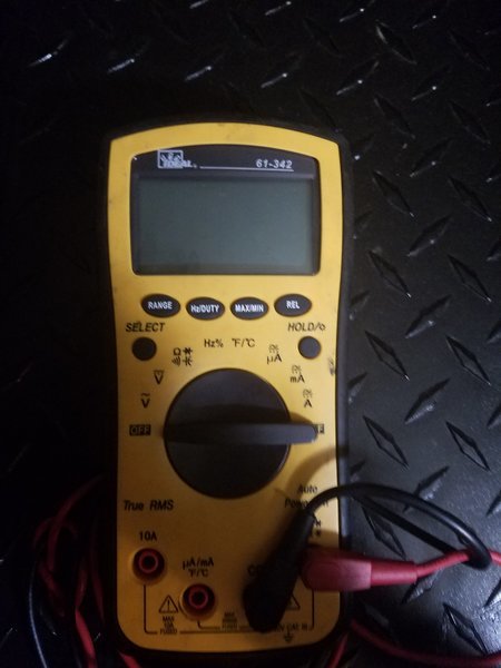

    That is one thing on my list is to install more gfi outlets in the house. the only one is in one of the bathrooms. I have a cheap voltage meter but given this situation im going to buy a new one. I still need to check the attic for any possible gfi or a junction box. Any recommendations on good meter? Thanks!

    Fluke meters are expensive... not worth it IMHO..
    I have this meter. IDEAL industries 61-342 . never failed me yet and extremely accurate.. fairly cheap on Amazon too..
    It even does temperature too and comes with the special probe...

    BTW that meter DOES have a back-lit screen.... if that matters.. (which it definitely does..dark...sun glare..etc)
    And the black part is rubber
