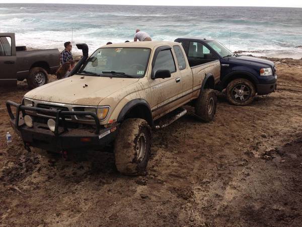

    here are some pics of when this whole problem started.
    and this is after when I hit the mud puddle, where I assume the water in the engine came.

    Bro thats fucken weird.wounder if your shit got to hot.

    I left for a few hours. After looking at the pics, the water and mud does not look that deep.
