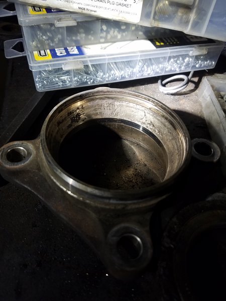

    My passenger side wheel was making a bunch of fun noise and this is what the inside of the bearing looked like after my mechanic took it out and replaced it...
    The thing fell apart after he got it out!

    Just curious, why it would go away in 4x4?

    Probably locks in place I think

    It loads the front cv in a way to where it doesnt oscillate within the stock needle bearing when going into 4x4 like it does when getting pushed by the tire.

    So just an FYI, I put my truck into 4x4 and checked @ about 30 and it went away. Took it out and drove regular and it seemed almost completely gone or so minute It's hard to tell if It's there.

    it will do that and come back eventually, that happens the first few time. then when you do the same thing it will stop in 4x4 but as soon as you switch to 4x2 it will start growling

    Yes this exactly. I took it to the dealership and they told me it's my oversized tires, and act like they don't want anything to do with it. I know for a fact that it is this problem. What do yall suggest I do? Is there any way to insist that this is the actual problem and have them fix it for free under the TSB? I had 5000 when I first noticed, and now I have 21k. I don't want more problems occurring from this down the road.

    If it were your tires, it wouldn't go away in 4x4. Mine was doing the same thing, they did the tsb fix, it went away. You may have to give them a hard time, but a tire noise shouldn't come and go like this noise does. Tell them to fix the thing.
