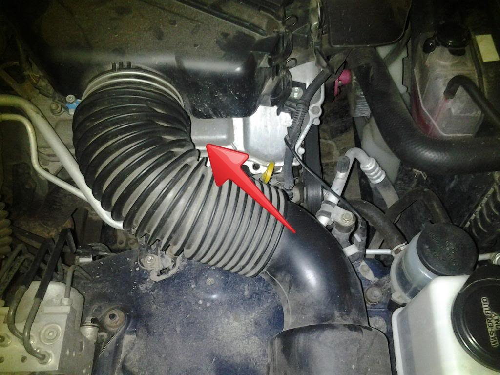

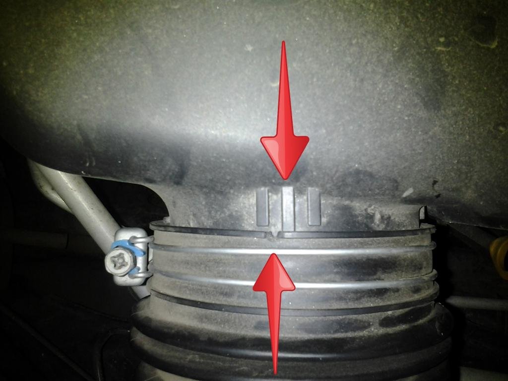

    This clamp here:
    9b55bb65-b1d5-4f14-b003-bacee3afe863_zps_a970a614ca342b599d9a8fc2f97cbc454198d821.jpg
    On my truck, I had to rotate the flex tube counterclockwise on the airbox a bit less than 1/4", which moves the intake tube in relation the the inner fender. You may have to play with it a bit to find a spot that works for you. You can see where the knotch in the tube that used to line up with the center tab on the airbox is now offset to the rear.

    THANKS man. Def just saved me. I was so aggravated the past 2 days. Driving me nuts. Never made that sound before. Had some work done Saturday. While they were doing it I took the air hose to.the engine compartment. Pulled the air filter and cleaned it out. Never thought much of it. Kept thinking the housing wasn't sitting right. After reading your post I went and decided to take a look. Notch was not centered nor was band properly seated. Maybe happened as a result of taking filter out. Not sure. However i adjusted the tubing, repositioned the band and tightened her up. Back to being quiet as can be. GOOD LOOKS!!
