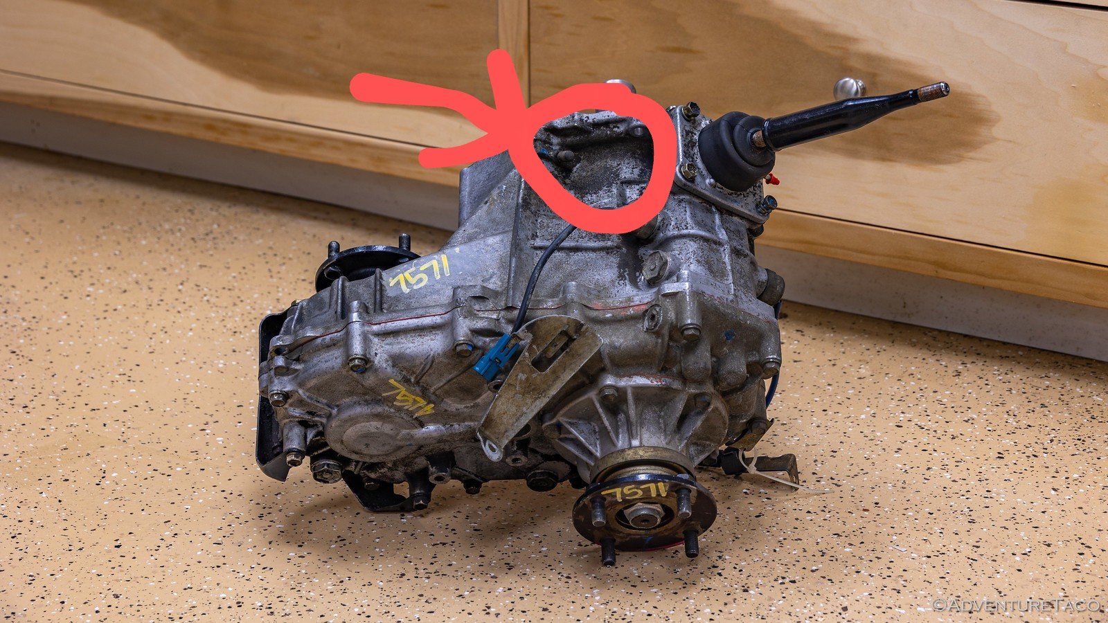

    Should be right here

    thankYou!
    is that vent plug replaceable without having to dismantle the transfer case off of the truck?
    should it just be able to wiggle like the one on the rear axle or is it a different type of vent plug
    i might be able to reach a hand of there to feel around & see if it is seized

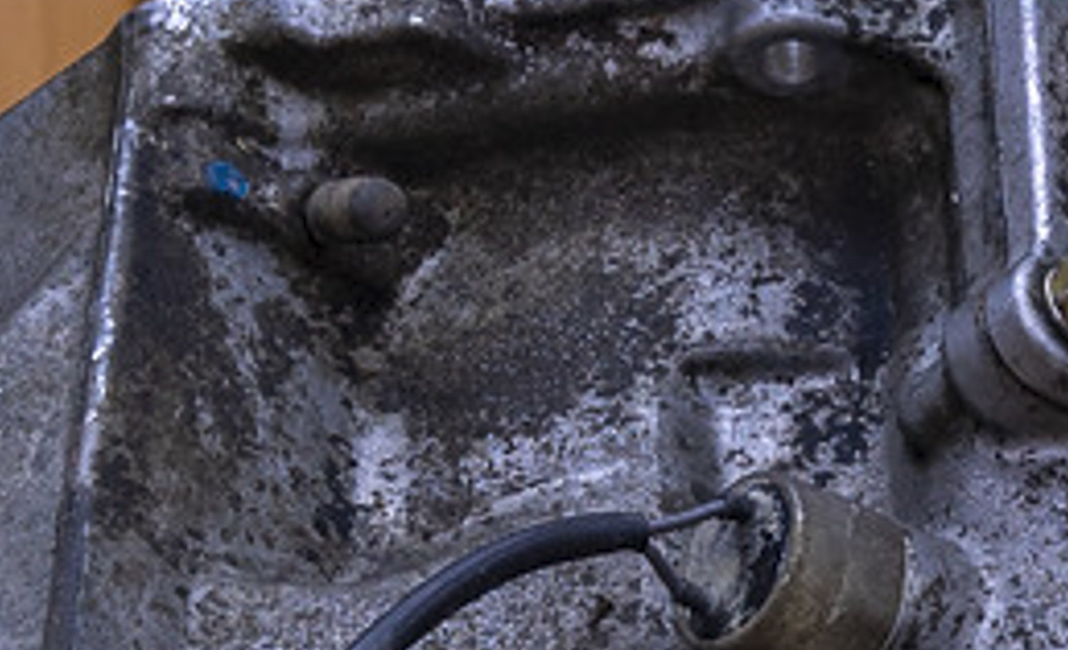

    blew up and cropped that area for a closer up
    well there it looks like it is located to the right of the blue marking

    Yea that's the one. It is replaceable, so long as you can physically get to it. Might be in a hard to reach location. If you can't get at it from below, I'd remove your shifter boot and try to get it from inside the cab above it.

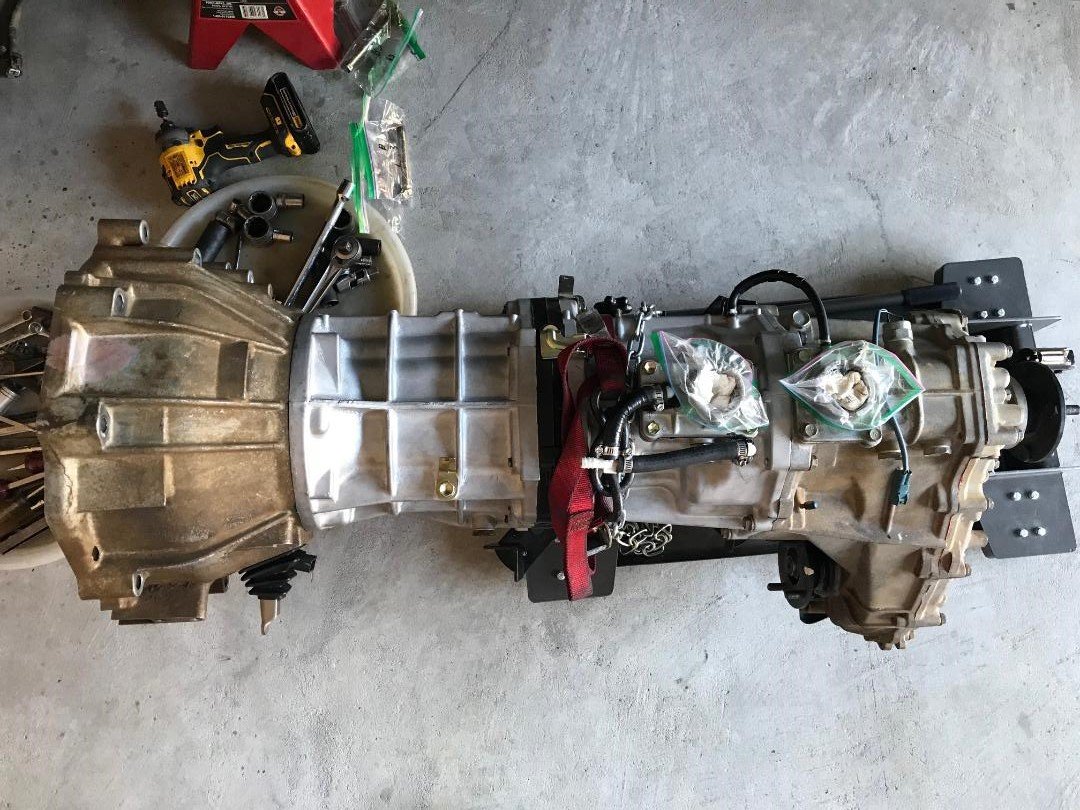

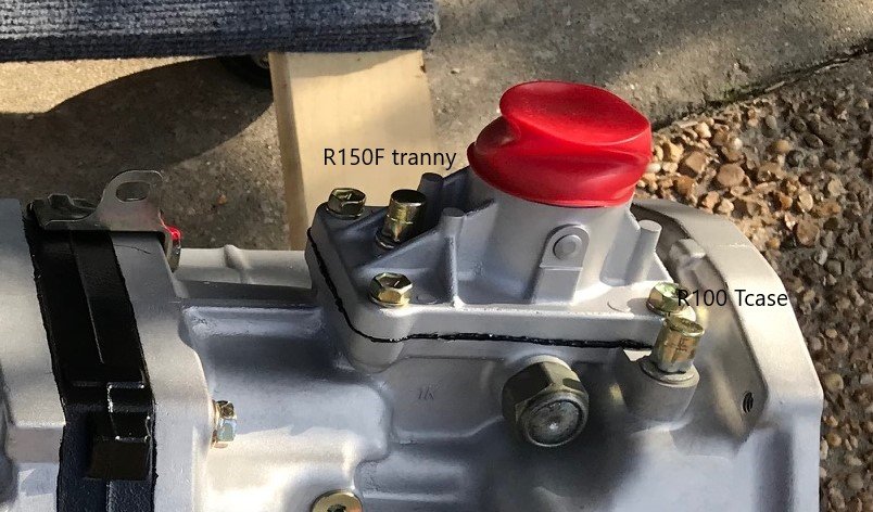

    The R100 Tcase breather vent is pressed into the top-rear of the manual gearbox rear case. The R150F tranny breather vent is pressed into the tranny shifter tower itself. A hose from that red plug next to the Tcase J-shifter tower in your pic leads to the rear tranny case. Toyota put the vents up at a high point and you can service both factory breathers when you pull the shifter boot. Small hands are useful to do it but mine are XXLarge.
    OEM breather vents on R150F tranny:
    Both the tranny and Tcase breather vents were extended on my Taco, but you can see the armored vent hose on the upper right attaching the Tcase to the tranny case:

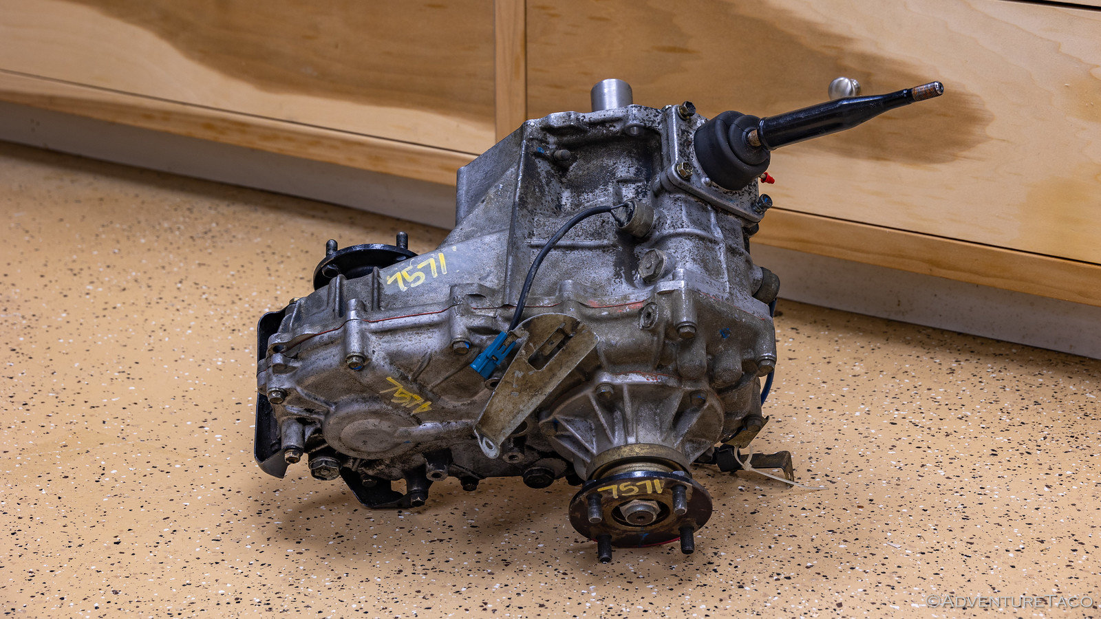

    ? that other pic is a different variation of Tcase for a different year of gen1 Tacoma?
    i probably have the '97 one like you do except the R150F is no longer a '97 model on mine currently and it is having some issues yet to find out about
