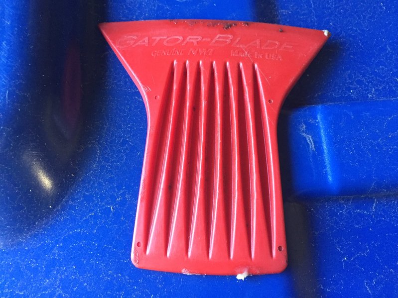

    I recently changed out my factory mirrors for heated ones and when I took the panel off, I found this in the door. No signs of a break in so I'm thinking this was left in at the factory by accident. While I never heard it rattle, it's something to consider.

    Not the same as mine. Another strange discovery, the days that I was hearing the rattle I was low on gas like less than 1/4 tank. Filled up and haven't heard it since that day...
