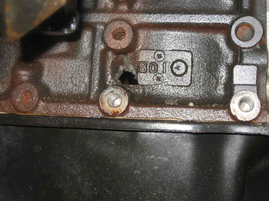

    Oh yeah....mine made that sound right before this happened

    In all seriousness, you need to figure out if its a knock or a tick sound.
    If it's a ticking sound from the drivers side at idle, use the search. Perfectly normal (albeit annoying).
    If you're getting a knock sound from the bottom of the motor, most like a connecting rod on it's way out (or broke completely and then stabbed a hole in the side of the block as in my situation).
