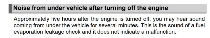

    most likely this:
    from owner's manual:
    "Approximately five hours after the engine is turned off, you may hear sound
    coming from under the vehicle for several minutes. This is the sound of a fuel
    evaporation leakage check and it does not indicate a malfunction."

    Thanks… tried to find it in the owner’s manual (all 300 pages or so)…. What the hell else did I miss?

    Page 8.

    i did a search of the owners manual pdf for "noise". (full disclosure: i knew answer, was just looking for the wording :) )
