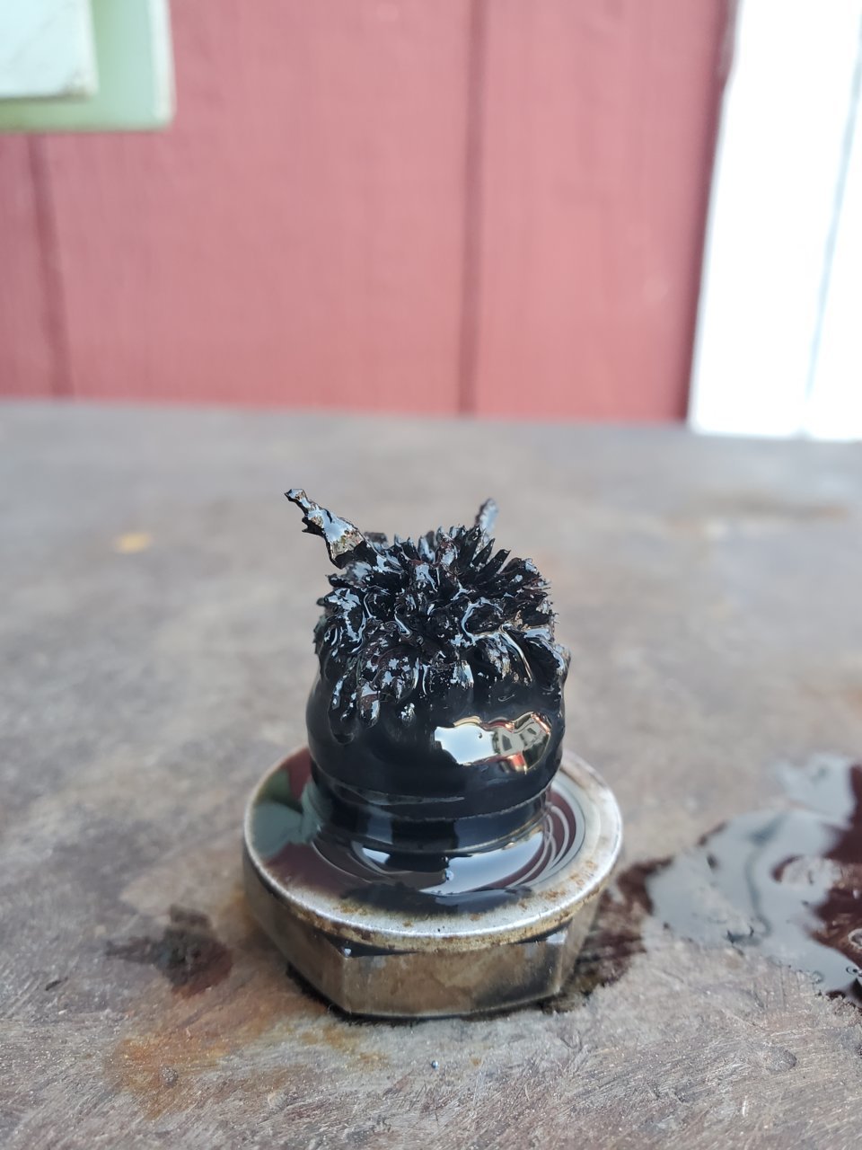

    Sounds like the pinion bearing. With that much shaving, take it out and inspect. You should be able to see where the shaving came from.

    I can't see or feel anything that is bad.
    No chunks in bottom of differential housing.

    You won't find chunk, just a bunch of shaving
