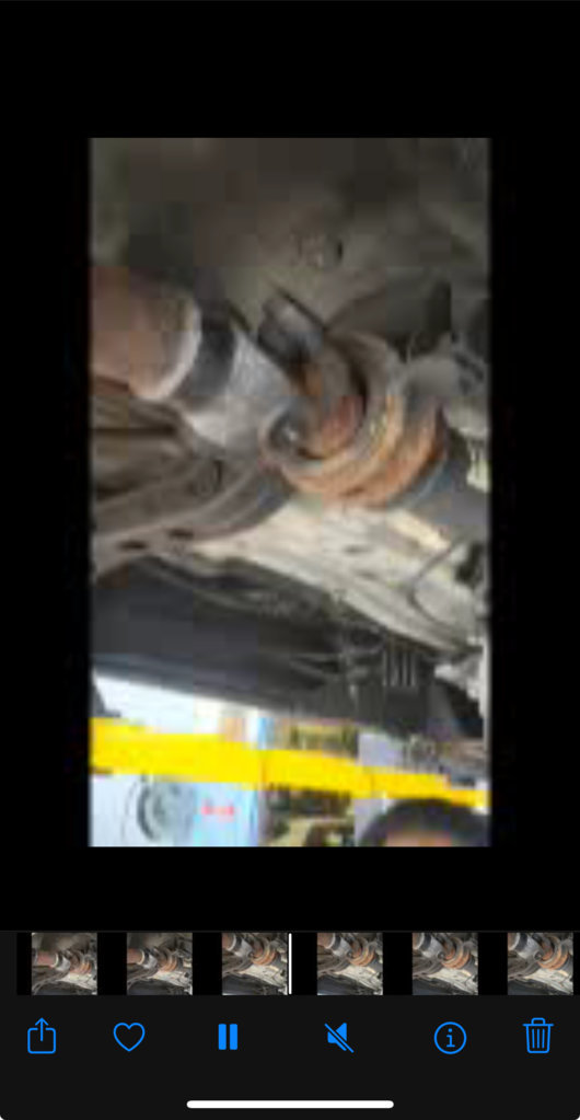

    Was finally able to get the truck to my friends shop and what we found is that the drive shaft is the issue. Took a video but couldn’t upload it, so here is a pic of the video.

    BUCKLE UP! It makes it harder for Aliens to pull you out of your Truck.
    Yowza

    I know, not what I was thinking would be the issue. I guess getting 189k miles out of isn’t that bad :notsure:

    Oh wow!! Can’t complain then - lol. We fixed that and the heat shield for the catalitic converter bolts were where lose (rust on them) so we fixed that too. These are great trucks and I’m at the point where mine just needs a little TLC
