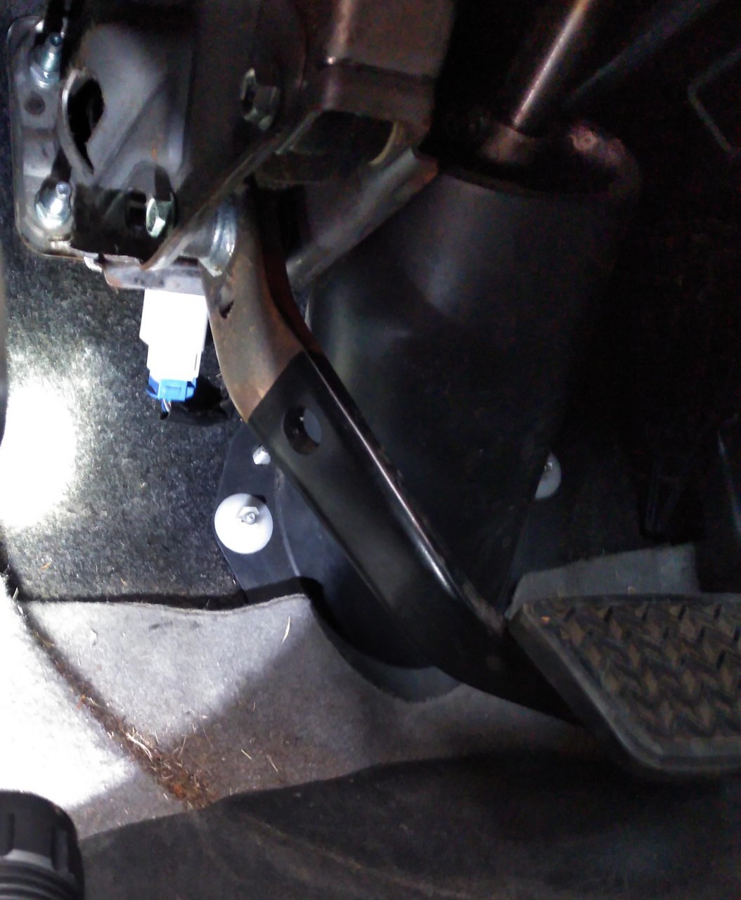

    I had this happen a few times randomly when I know I wasn't on the brake and the accelerator at the same time. I found my brake switch under the brake pedal was not seated properly and was causing the issue. Once I put it in place properly, no issue.

    Hm, this might be worth checking. Do you have a photo of what this looks like?

    Other people have mentioned that the brake switch adjustment was just iffy enough to turn on the brake lights randomly without a foot on the brake. As mentioned above, this tells the ECU to cut the power. Try just barely pressing the brake and see if it acts the same way.

    Here's the location of the switch. It's the white and blue switch behind the brake pedal.
