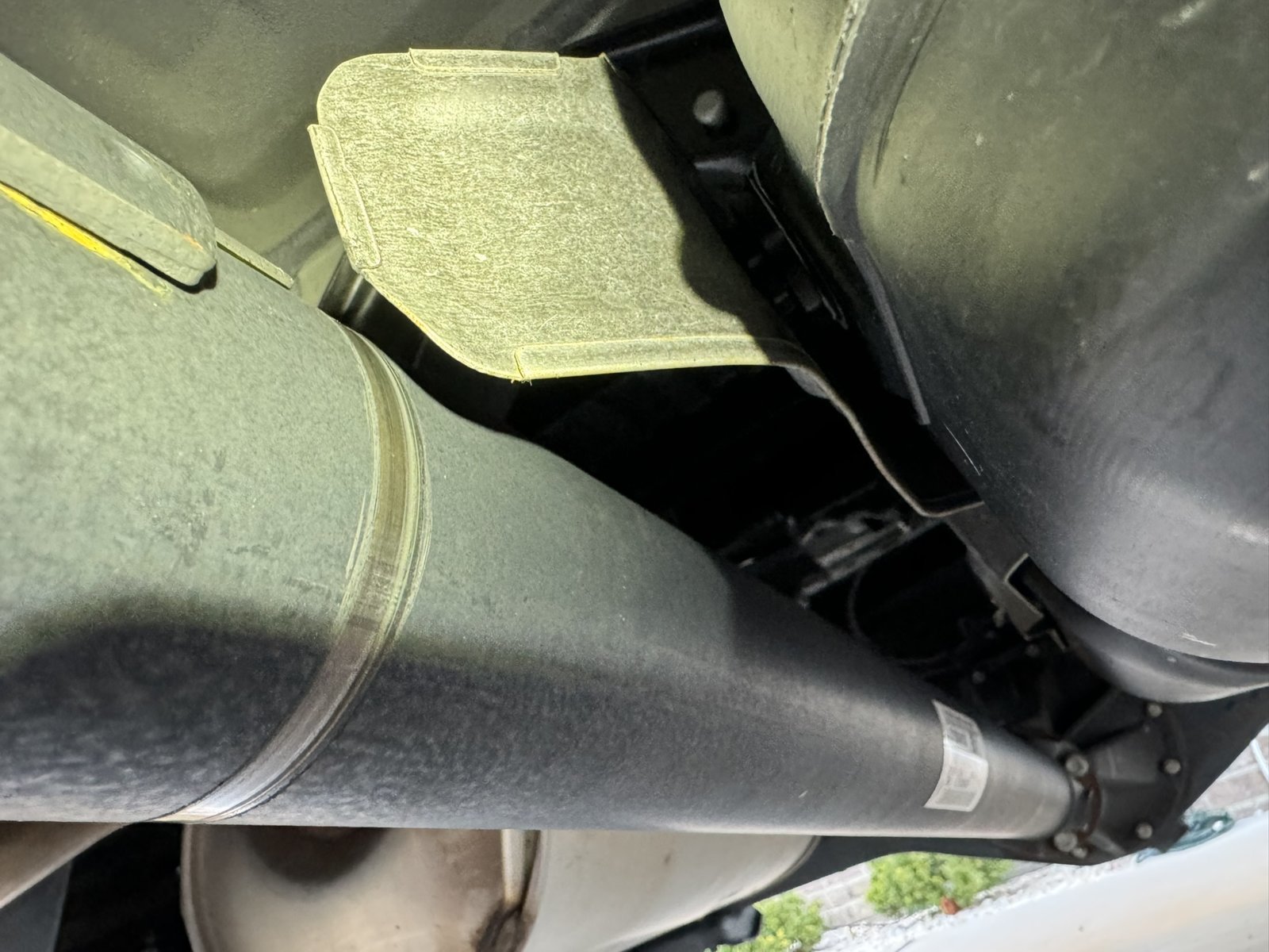

  9. Dec 18, 2023 at 1:48 PM
    Phaaronite
    Phaaronite Active Member
    Apr 12, 2022
    #394850
    43
    Quinton
    2022 Tacoma TRD Sport - Magnetic Gray
    I did pretty much the same thing as you last night - I went through a large puddle a little too fast. I noticed the same kind of sound you described and also thought it might be coming from the brakes/wheels. After reading your post I decided to get back under the truck and inspect the driveshaft - lo and behold, I found a bit of sheet metal bent out of place rubbing against the driveshaft! Here's a pic for reference: upload_2023-12-18_16-47-10.jpg
    I bent it back and away from the drive shaft, and no longer hear any weird noises. Figured I'd post here too in case it happens to anyone else and they come looking!
