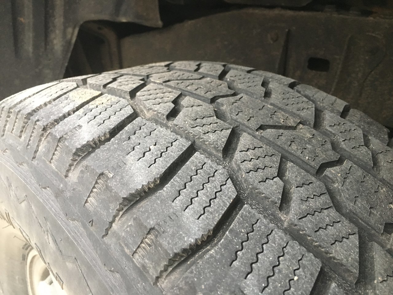

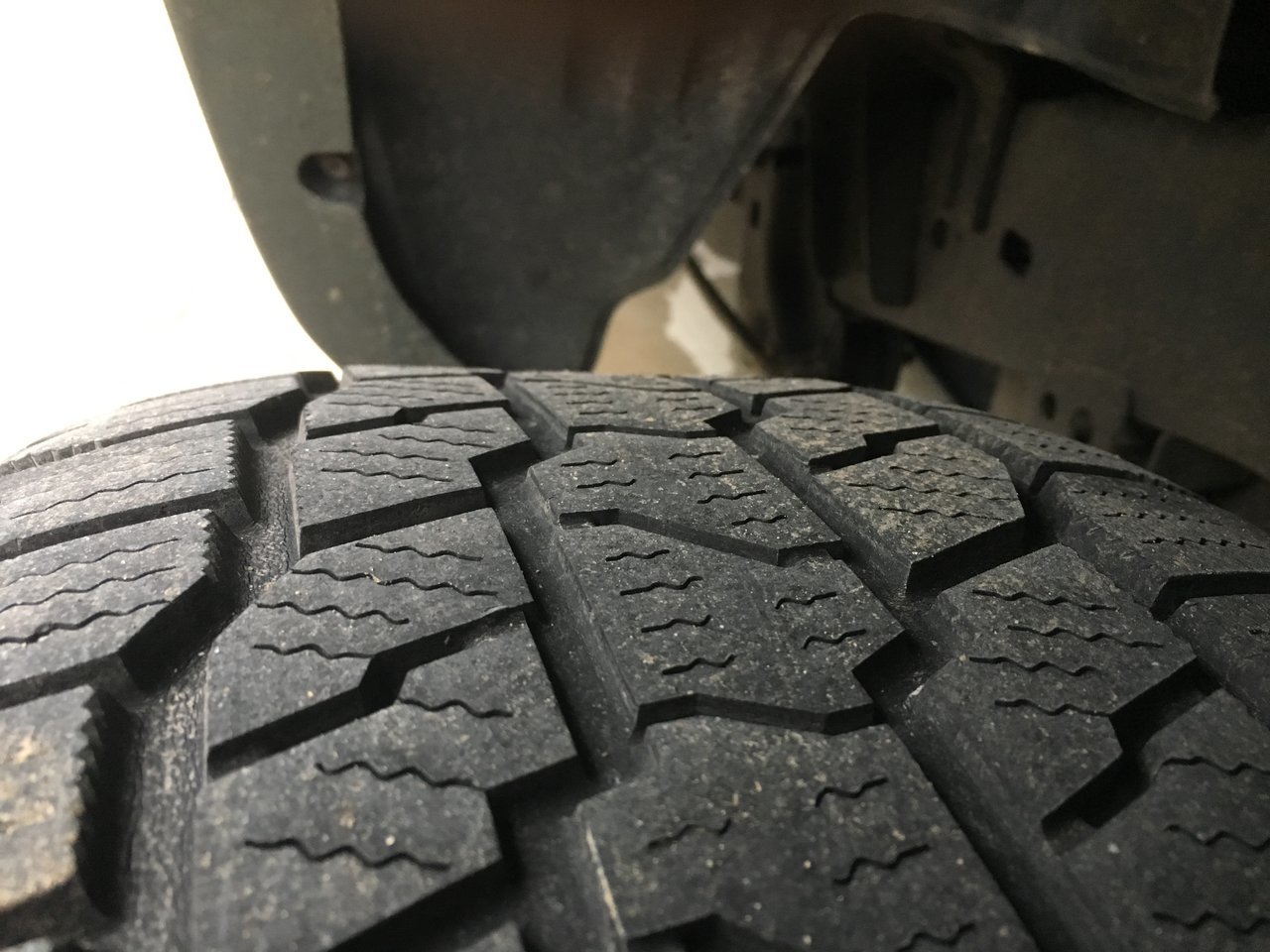

    Hi all, I've been running these Cooper Discoverer AT/Ws for the past 50,000 miles or so and I love these tires. That said, they don't seem to be wearing normally. They're wearing more in the middle than on the outside, which would suggest overinflation, but the shape of the tire when looking at it appears to be underinflated. You can see in one of the pictures what I mean- the middle of the tire looks like it's sunken in like it's underinflated, but it's this same middle tread that's worn significantly more, like its been overinflated. I drive a lot pulling a trailer, maybe this has something to do with it? and I check my tire pressure regularly, keeping it about 35-35 psi cold. The max for the tire is 44psi cold.
    Any thoughts/ advice?

    What size are they? I have the ATP3s and I've found running more like 32 psi for better mileage and even wear. I have a completely different tacoma of course... Try a chalk test?

    Yeah I really should do the chalk test thing. I've got the stock TRD size 265/70R16. Seems a lot of people run lower PSI than the door sticker too now that I'm looking into it. I never gave it much thought til recently. Never had wear issues til now. Just seems strange that if I'm overinflating that they'd appear sunken in the middle like they're underinflated, unless they balloon outwards that dramatically when they heat up?

    Classic over-inflation. That's my vote. The treads on the sides are also wearing unevenly. See how the leading edge on every nub on the outer edge the front tires is making contact and the rear edge is not? A chalk test would make it more obvious to you but I can see it in your pics. I've got the same problem and am running low pressure for awhile to even them out.
    Not my preference. I like the ride better on over-inflated tires. Less resistance. Thus why I have the same problem you're having. Being an AT tire, this problem becomes even more apparent.

    To the op-- if that second pic you posted is on the front, I'd suggest rotating ASAP.

    Looks like cupping on the outside of the tread, if I remember correctly that’s an alignment issue, excessive camber. Someone smarter chime in.

    I'm not smarter. But I agree cupping can be an alignment issue. But I also think something similar happens when running overinflated on the front. When we turn the wheel, the vehicle's forward momentum causes the tire to "roll" or tip/lean to its side, thereby allowing the front edge of the treads on the side to grab pavement-- the same tread that is not making contact when the truck is rolling straight.
    As we roll through a turn and then back to straight, the side tread that was grabbing on its leading edge raises back up due to the tire again being aligned with the direction of forward momentum.
    Kinda hard to explain. I don't know if I'm making sense. But I think this type of wear is more common on taller tires and especially AT tires where there is more space between the treads. It can be mistaken for an alignment problem. By airing down, more of the surface will be in contact with the pavement and less roll will occur and/or the entire (front and back) of that particular tread block will make contact and wear evenly.
    This issue (like the OP's second pic) is a little different wear pattern than cupping.
