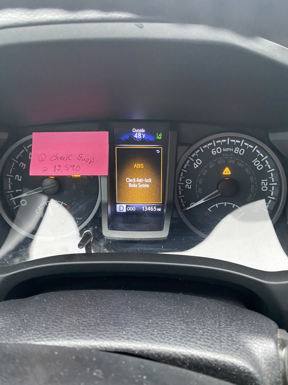

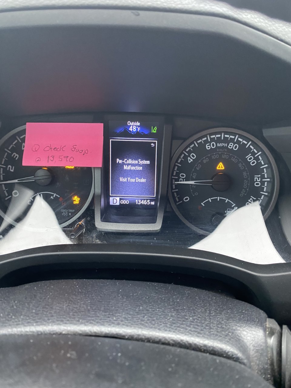

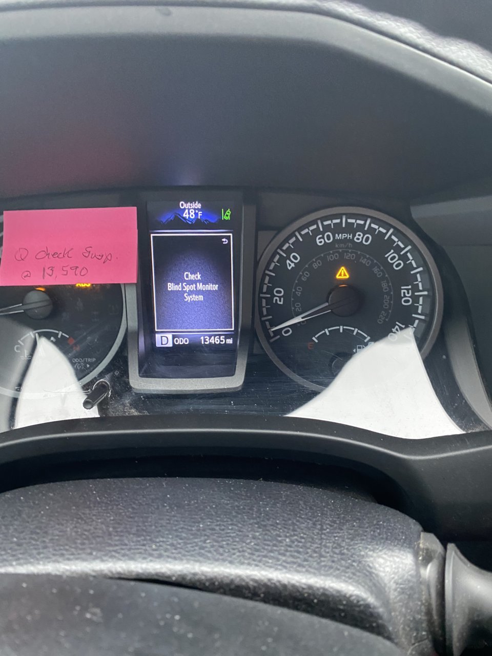

    The other day, while doing some mild off roading, my dash lit up with a bunch of warning lights. I did the old turn it off and turn it back on trick and voila, the lights went out. Problem solved.
    then today, several weeks later, they came on again while driving to work. I turned the truck off and back on and they went away.
    anyone know what the issue could be? I should say my passenger cv axle is currently slinging grease all over everything. I have a new axle already but haven’t replaced it yet. Getting that done this weekend.
    Pics for evidence. 1469E981-E243-45EE-B051-893FF1440B68.jpg9FB38F92-1AEB-40ED-B93C-3438FA3E1D5C.jpg84CD119C-C57D-4E3F-BC93-A3996C487B59.jpg933A92DA-8529-4876-829F-D4AFD34FB3B7.jpg

    Scan it for codes. Everything else will just be a guess.

    Take a peek under the front by the brake backing plates. You will see a wire running to each one on each side. See if you perhaps tore it off.

    Wire damage to the pass front wheel speed sensor?
    Damaged magnetic ring on the pass front wheel bearing?
    What do the codes say?
    Does your scan tool read individual wheel speeds? Plot them in real time and see if any of the four traces look wonky when driving.

    I had same messages except the head unit when I ripped my rear ABS wire while off-road.
    Replaced the whole harness and all is good.

    Mud, dirt packed up on sensors. Power wash wheel ares and up in rear bumper.

    At 13,000 miles I'd want to know why my axle is slinging grease everywhere, chances are its related to your abs fault

    Mild off roading and tore the boot?

    I just mean 13,000 is too early for normal boot failure. If something stuck up in that area like a big tree branch or a rock it may have torn the sensor wire too
