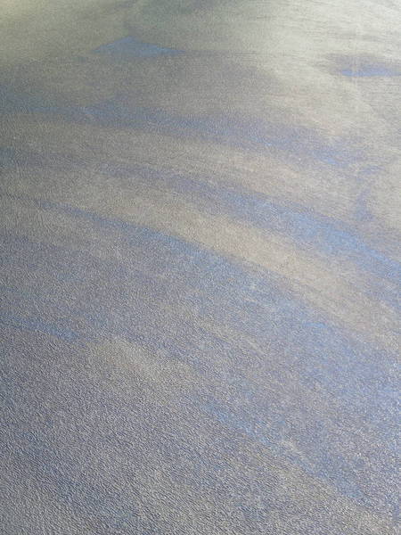

    I've got an undercover tonneau on my taco.
    The previous owner must have used something he shouldn't have on the undercover and ever since I bought it, it's got streaks all over it.
    what's the best way to remove the streaks, and not just cover them up?

    I'll get pics sometime this weekend if I can.
    The streaks have that kind of rainbow appearance that leaked oil has-- if that makes any sense at all.

    It's kind of hard to photograph, but here's the best picture I could get.
  6. Feb 11, 2012 at 10:08 AM
    cc350
    cc350 Retired Member
    Oct 11, 2010
    #44527
    956
    Stiff brush and some degreaser, then coat with a protectant like mothers or 303 aerospace .
