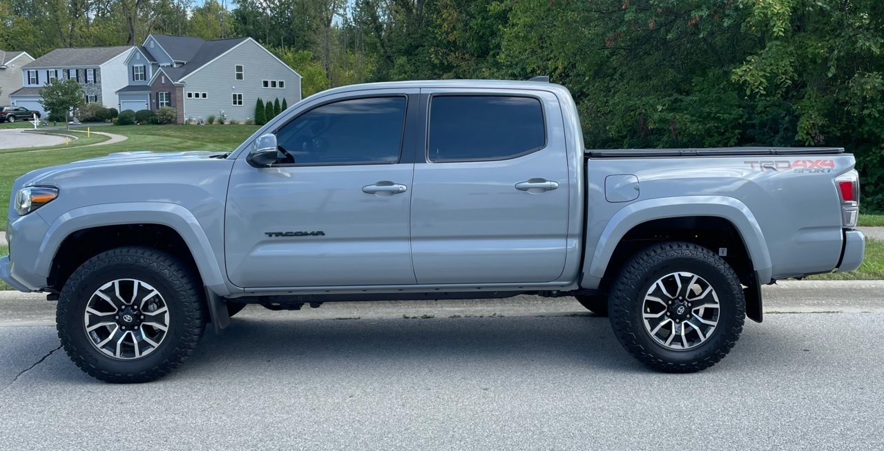

    Do you have any pics of the streetrays spacer installed?

    I installed the Streetrays 1” lift front spacers and 1” rear blocks. The supplied nuts work great with the stock top plate studs. No issues with the install.
    I took the truck to Toyota dealer for an alignment after the install. Surprising, the alignment was still in spec.

    This looks fantastic! So you did the 1/2” front spacer for 1” front lift?

    Thank you! Yes, I added 1/2” spacer and ended up with just over 1” lift. I will attach a screenshot of what I ordered.

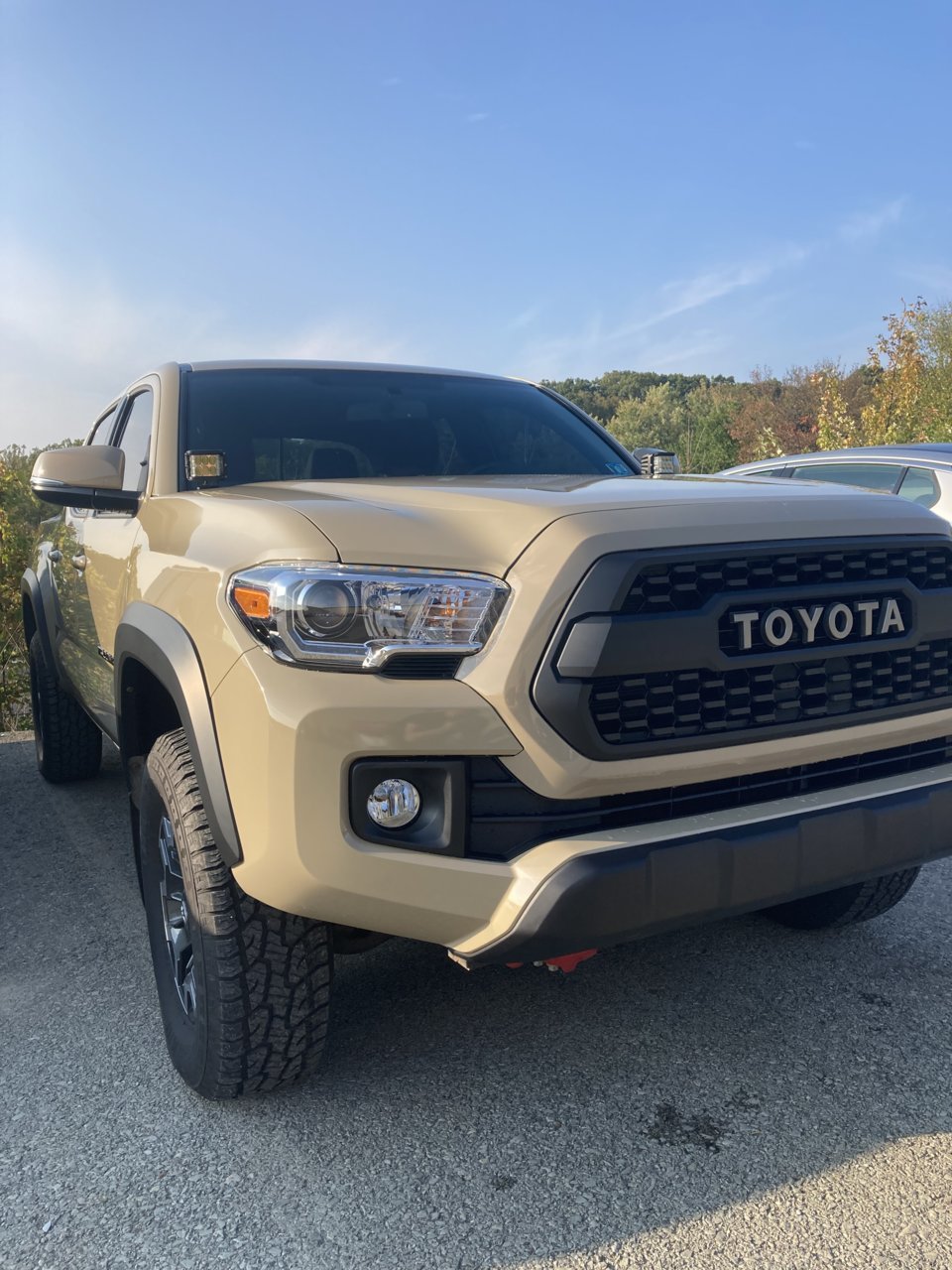

    Got my StreetRays 1/2in spacer and 1in rear blocks. Installing in the near future.
    Also just added an awesome pro grill thanks to @FreshMexicanTaco
