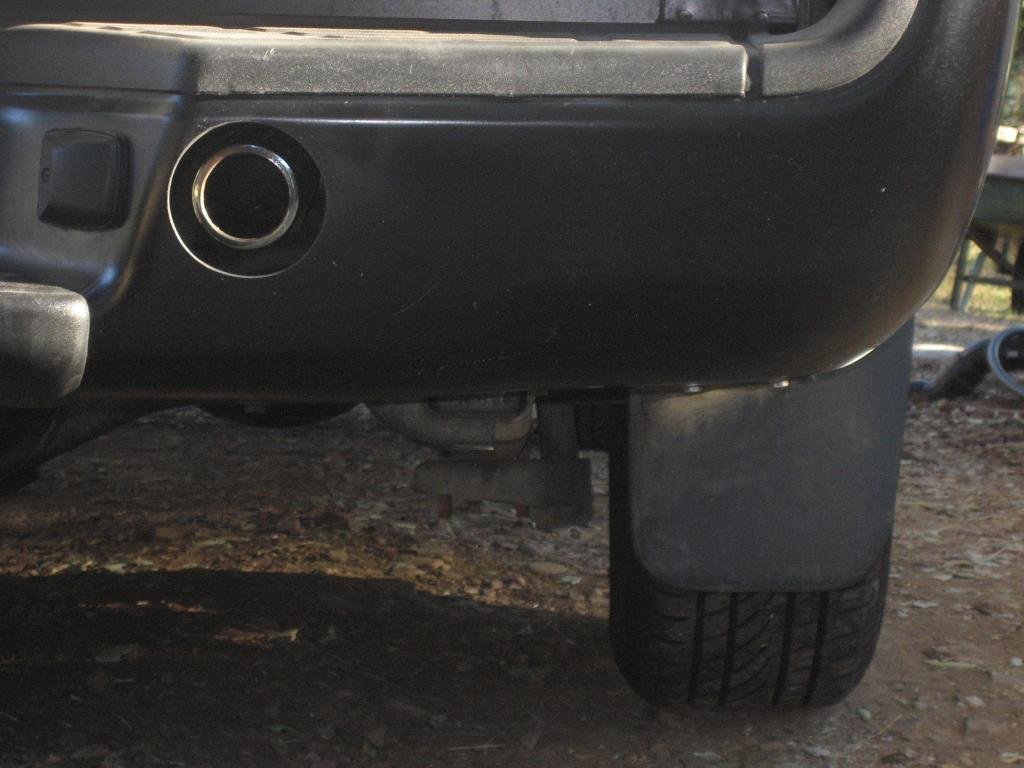

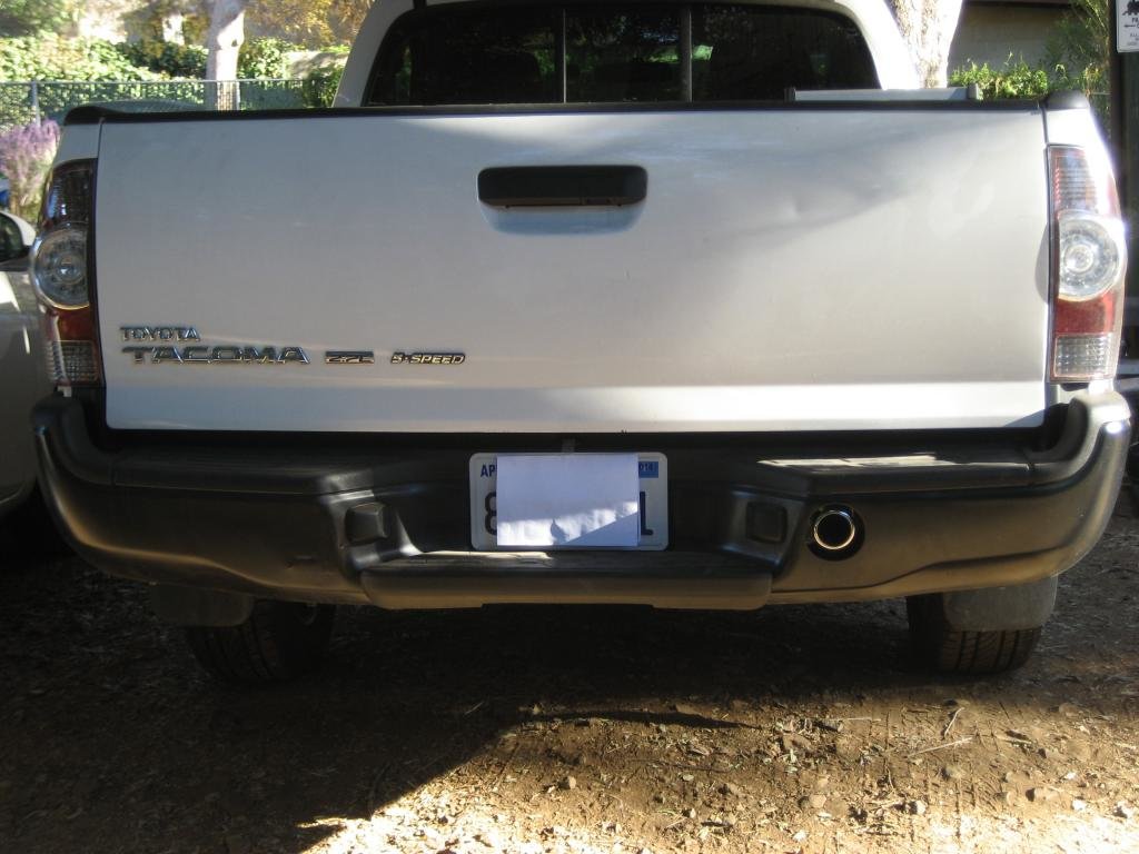

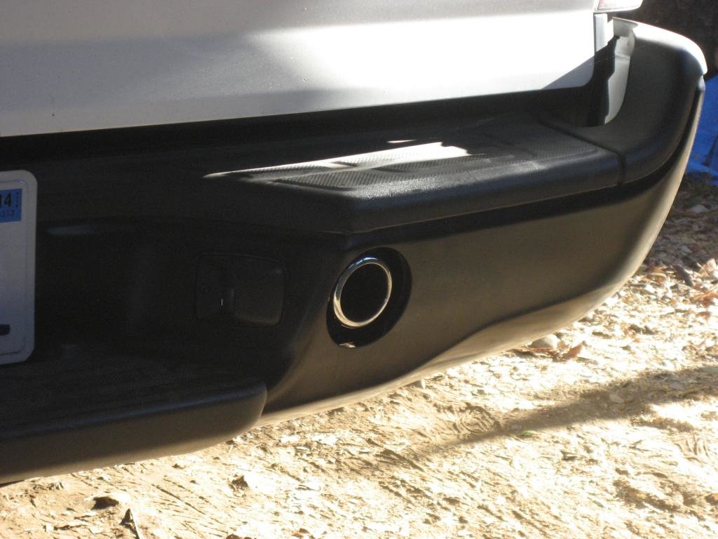

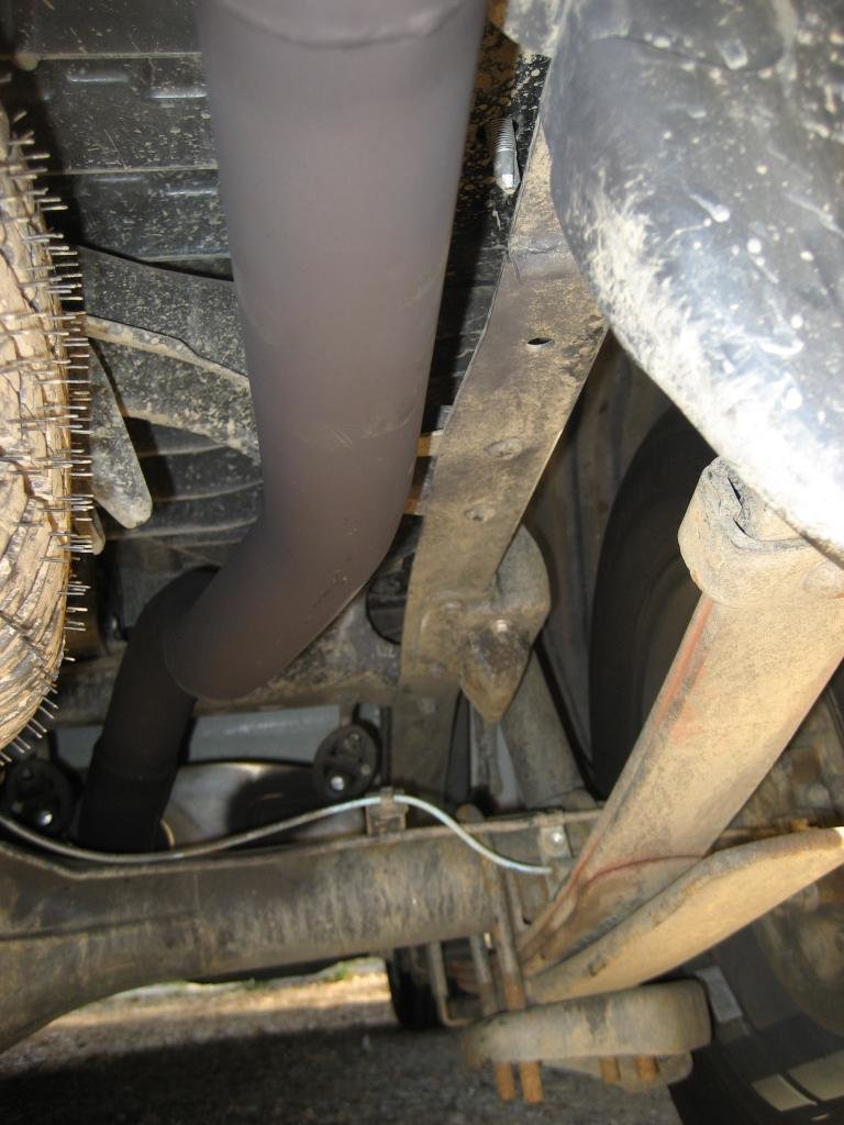

    I wanted a really unique street Taco exhaust, so I punched a hole in the rear bumper and had a custom exhaust shop guy with a mandrel bender fabricate a pipe to fit. This is the result...

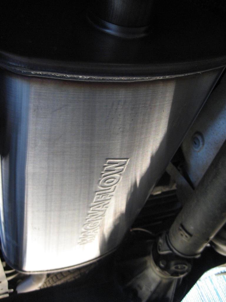

    I also installed the largest MagnaFlow muffler I could find (22" long 5"x11" oval). So it sounds really deep and mellow.

    It cost $400 to get it done just right. But for a totally custom one of a kind mandrel bent cat back system it was well worth it. :)
    I also had mine dump behind the rear axle, and it was pretty quiet there as opposed to dumping in front of the rear axle.

    Yes I did lose low end, and this is how I addressed that issue.
    Our Tacos use metric sized exhaust tubing which comes to 2 3/8" OD. So I had the muffler guy run smaller 2 1/4" OD mandrel bent exhaust tubing to compensate for it. He wanted to run 2 1/2" OD, but that would have opened up the exhaust too much. I actually could have done this with the first MagnaFlow, but the solution didn't occur to me at the time. I'm just glad it did now. The truck sounds great, while still retaining the low end pull. So if you ever get your rear pipe redone, use undersized 2 1/4" OD and it will work the same for your Taco. :thumbsup:

    Cool idea btw. what did you use to make the clean circle. Hole saw? I'd love to get rid of that exit pipe hanging off the passenger side. Throws things off cosmetically imo.

    I used a sharp 3 1/2" hole saw running at slow speed so that it wouldn't jump around and scratch the surrounding area.
    If you feel on the inside of your bumper, you'll find a cross member will impinge on the bottom of the hole. So whoever does your pipe bending will have to be really good to slightly angle the exhaust pipe downward at the end so as to clear that member. A non critical lip on the rear frame also needed to be cut out. That rear pipe has a bunch of compound angle bends in it to snake it's way over and around everything including the spare tire. The guy who did mine bar none does the finest exhaust work I've ever seen in my life. :thumbsup:

    Yes... only the pipe between the muffler and the rear bumper is 2 1/4"OD.
    I found out that it's ok to run a long tube header and a 2 1/2" core muffler, just as long as the end of the exhaust system is slightly reduced to compensate, because the end is the final determinant of flow.
