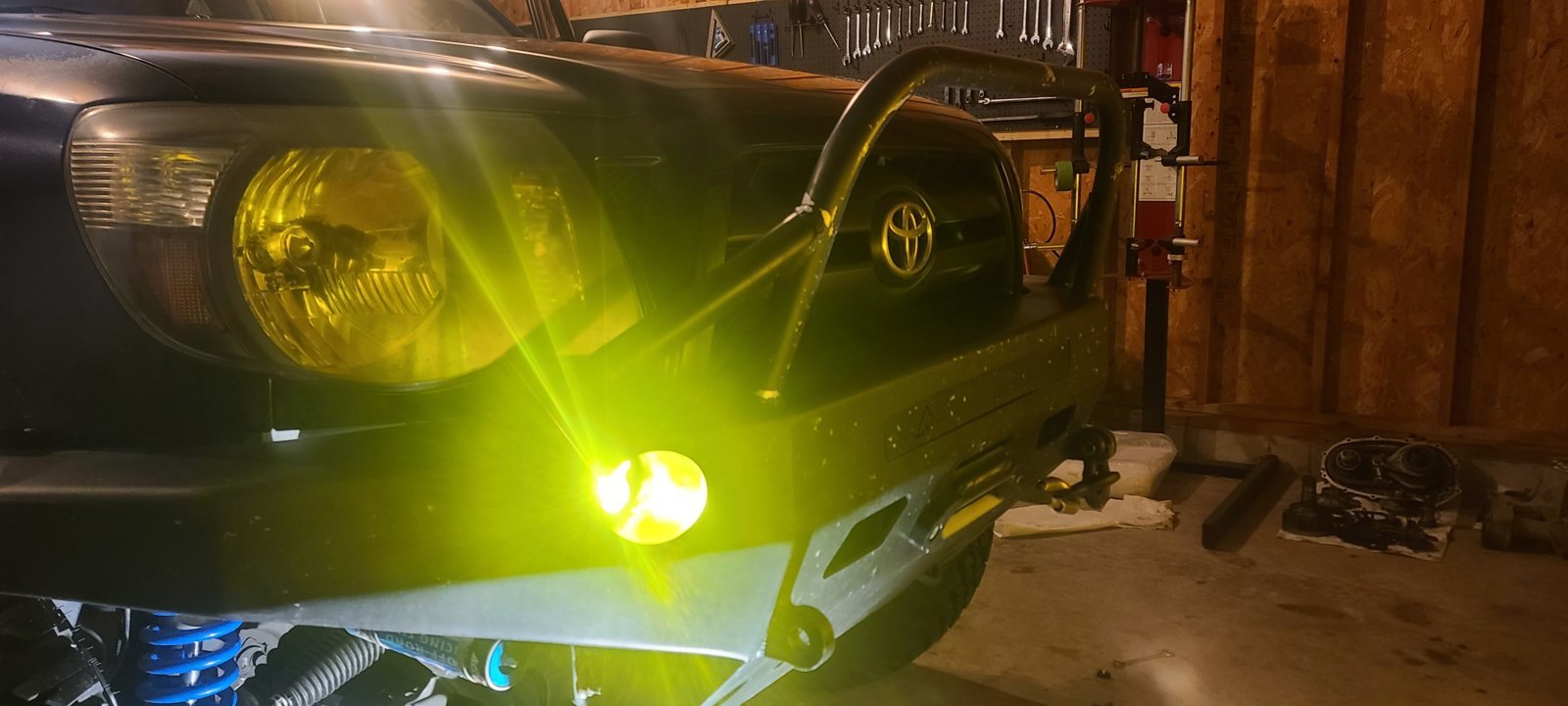

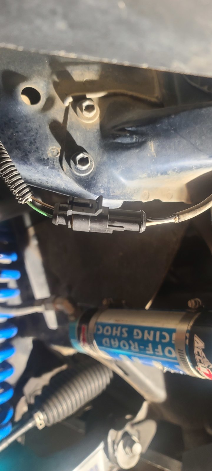

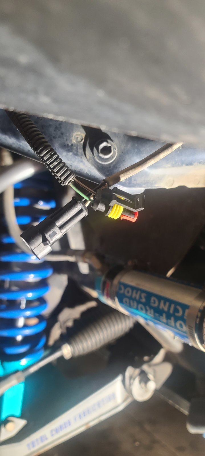

    Tackled a few issues today during an oil change. Been dealing with pending p0420 and p0430 codes. The cats are fairly new and I leak checked the exhaust with no leaks found. Decided to just throw 4 new sensors and a MAF at it. Cleaned the throttle body, replaced intake air filter. Went for a nice long drive and codes are no longer pending. Second issue was my wiring to my pods in the front bumper. They've been disconnected for a while now due to the crimp connectors breaking from removing and installing the front bumper so much over the past few months.
    After growing tired of having to deal with these connections every time I removed the front bumper, I decided to address it finally by pinning the wires into some connectors. I have lights again! This will make disconnecting these pods less of a headache when its time to reconnect them again.

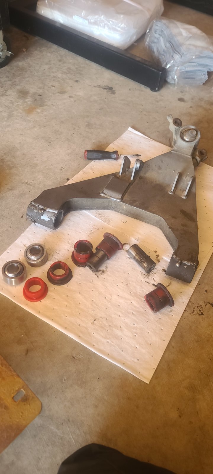

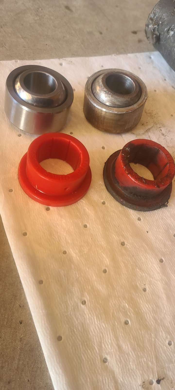

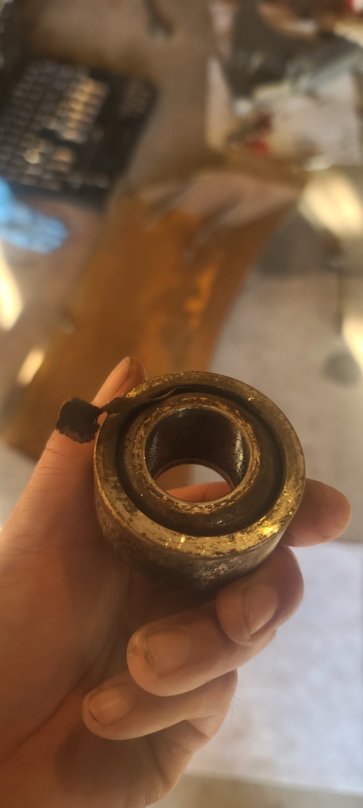

    Swapped out the uniballs in my uppers and lowers today as well as the bushings in my lowers. Holy fuck my uniballs were shot. Got rid of an awful creak I was getting when turning the steering wheel left or right. Steering also feels a lot lighter now and actually returns to center.

    Some last minute photos from yesterday's bushing and uniball replacement. Truck needs a wash

    The driver side lower was in the worst shape. There was some sort of liner material was coming apart

    My UCA uniballs have been lasting 3 years or so. I havent had to replace the LCA uniballs yet

    These uniballs are about 4 years old. Well overdue for how much abuse they've taken from the elements and on the trail

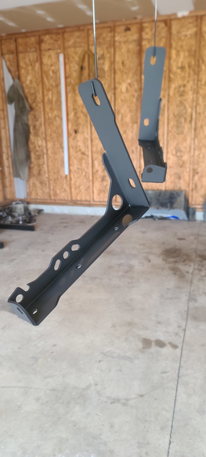

    Painting up the bed stiffeners on won at last year's AOAA raffle. Figured it's time to throw em on lol
