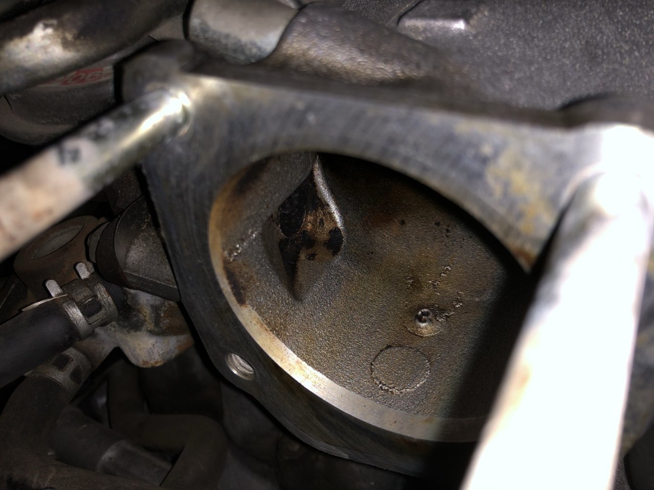

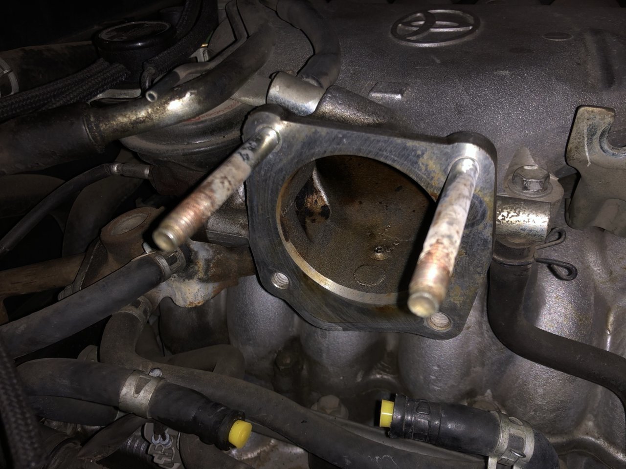

    Ok, since I've got everyone's attention on this thread!
    2 pics below, intake manifold (that's what it's called, right?) where I removed the throttle body.
    Is there supposed to be a hole there going into the EGR something or another? I scraped at it with a toothpick and wiped it with a rag and throttle body cleaner. Can't tell how deep the gunk is gonna go, but it sure does look like a hole is completely blocked. I'm unsure I want to keep going yet, for fear of gunk dislodging and going into the engine. I have no fault codes, at least not with my cheapo OBD2 reader.

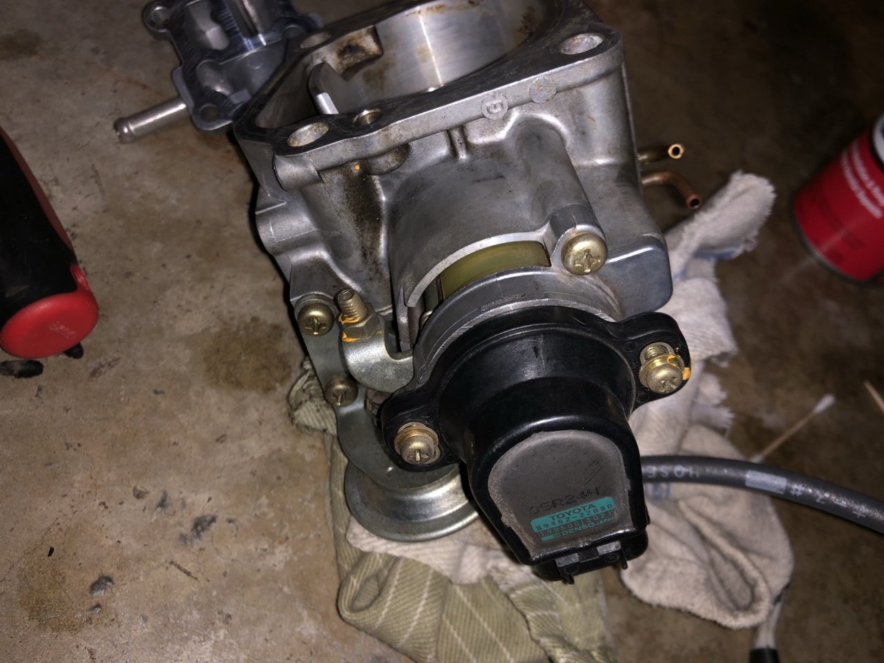

    In addition to the intake manifold gunk issue above, one more Q for tonight...
    As I turn the throttle on the throttle body, there is a significant noise that sounds like an old worn spring, not alarming but I doubt it's new sounding. Worth disassembling further to clean or replace a spring, assuming that's what it is? Earlier before taking off the throttle body I thought the spring noise was on the front where the steel wires clip in, but now it's apparent it's on the rear, next to the TPS, and hidden behind that yellow plastic bushing in the pic. Need to remove more JIS screws to get at it. Not sure if I should just be blasting throttle body cleaner in there.
