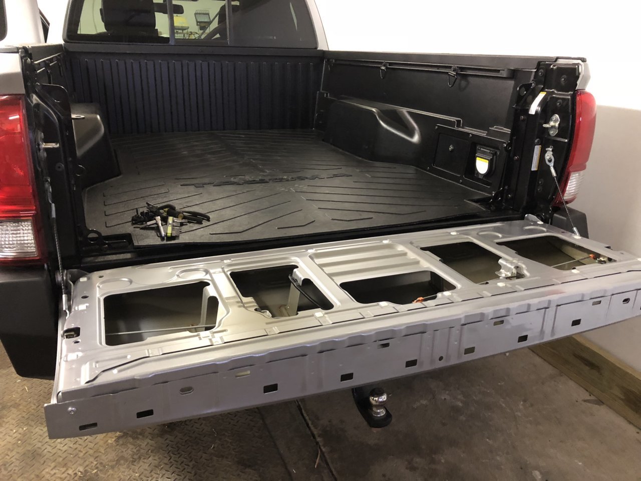

  11. Jun 8, 2019 at 4:46 PM
    Grossomotto
    Grossomotto Complete 3rd Member
    Mar 13, 2018
    #247175
    8,447
    39.9526° N, 75.1652° W
    2017 4WDV6LB6MT
    This is what it looks like underneath. I’ve got the Mobtown stainless hardware that I never used, I’ll sell cheap.

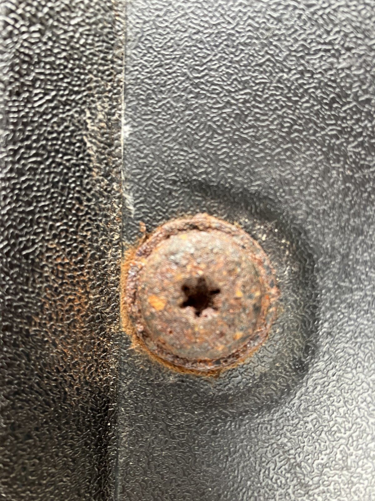

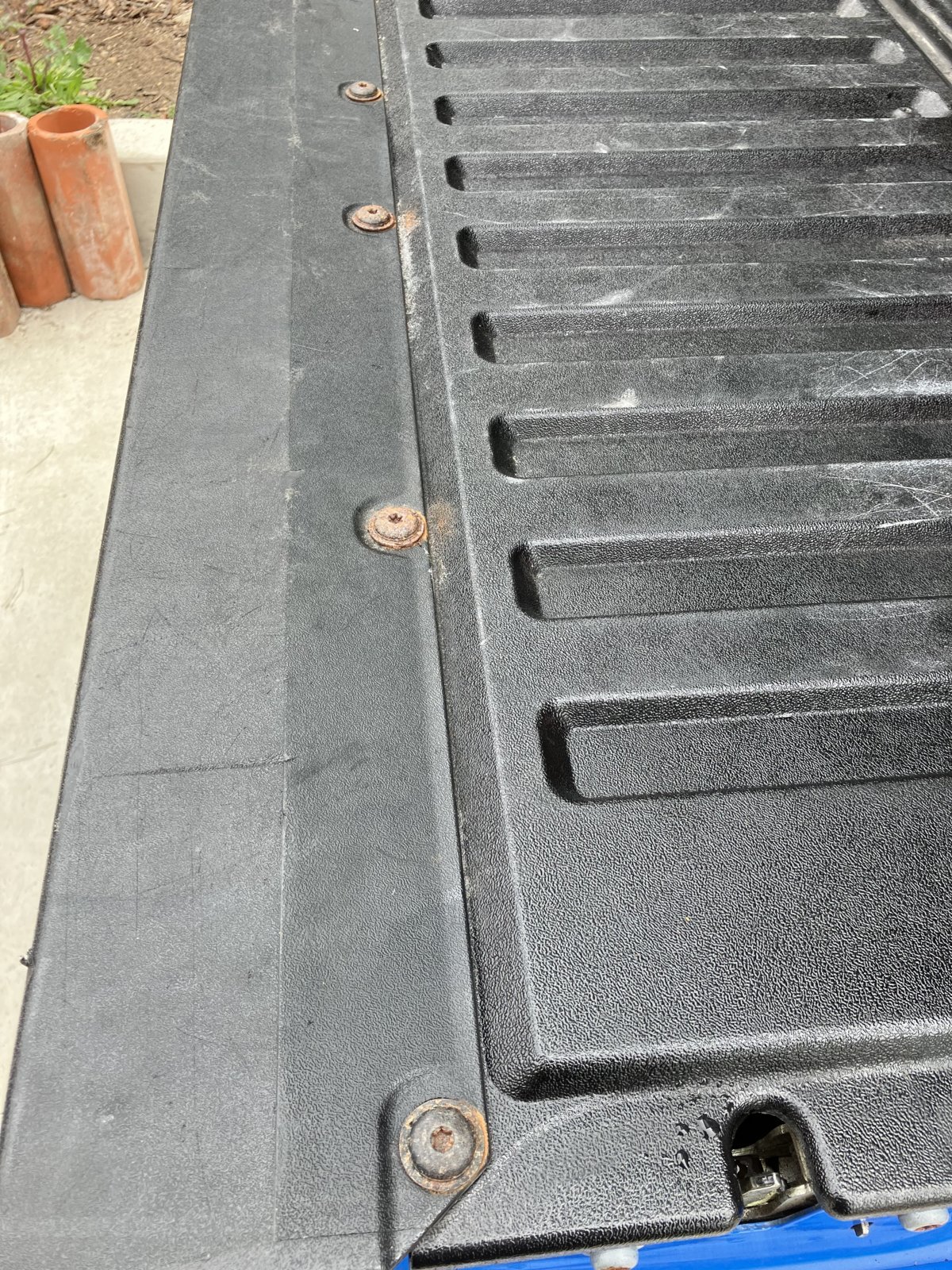

  12. Dec 13, 2023 at 3:45 PM
    LJTacoma
    LJTacoma My Ferrari...
    Dec 18, 2019
    #313625
    140
    Erik
    2020 Toyota Tacoma TRD Off-Road 4x4 2+2 (voodoo blue)
    I'm rusting!...
    Toyota metal no like salt water. Can anyone suggest a source for good stainless steel (316) replacement bolts (what size are these bolts)? Thanks!!
