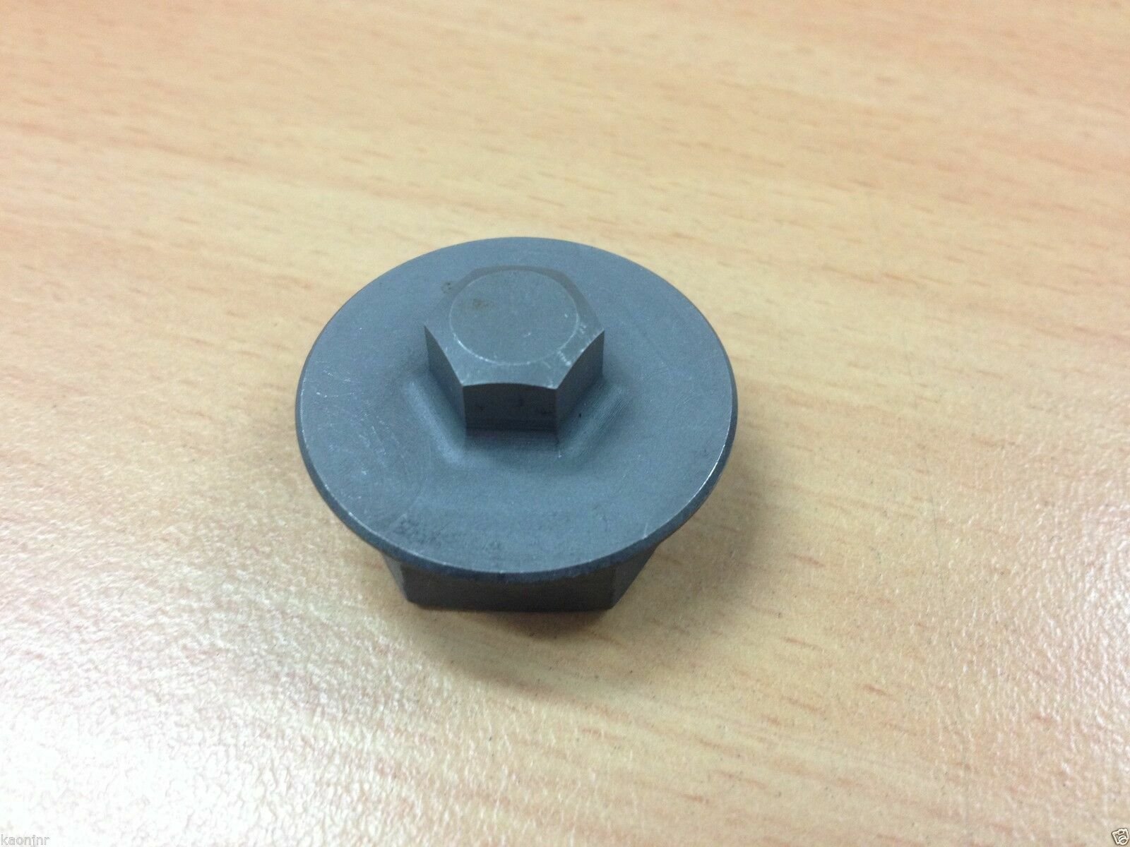

  15. Mar 5, 2024 at 7:11 AM
    #35
    slapmackie
    slapmackie Member
    Feb 25, 2015
    #149557
    9
    Powell, Tn.
    2017 Tacoma TRD OFF ROAD 4X4
    Stevie17 likes this.
  16. Mar 5, 2024 at 7:28 AM
    #36
    Stevie17
    Stevie17 Well-Known Member
    Mar 2, 2023
    #419202
    4,218
    Stevie
    Crossville, Alabama
    24 Celestial Silver Sr 5 DCSB 4x4
    Only 1 way to find out, try it and see. Is it a socket on the other side? Looks like it just fits inside and uses a wrench to loosen it up. :notsure:
  17. Mar 5, 2024 at 7:33 AM
    #37
    Hook78
    Hook78 Well-Known Member
    Dec 3, 2017
    #237571
    6,890
    Eastern NC
    2015 DCSB TRD OR
    Bilstein 6112/5160 Icon RXT
    How is this any different from using an Allen key bit?
  18. Mar 5, 2024 at 7:50 AM
    #38
    slapmackie
    slapmackie Member
    Feb 25, 2015
    #149557
    9
    Powell, Tn.
    Yeah, it's a 24MM socket on the other side...I'll give it a go and report back!
    Stevie17[QUOTED] likes this.
  19. Mar 5, 2024 at 7:55 AM
    #39
    kaljam
    kaljam Well-Known Member
    Aug 4, 2019
    #301145
    138
    Bill
    New Hampshire
    2023 TRD Sport wind chill pearl
    Waste of money - get the original out by any/all of the means mentioned above then get the Lexus plug to replace it (what it should have come with in the first place). But its your money.
  20. Mar 5, 2024 at 9:06 AM
    #40
    slapmackie
    slapmackie Member
    Feb 25, 2015
    #149557
    9
    Powell, Tn.
    They state that the 10mm side is slightly oversized designed to tap in and "hopefully" prevent it from stripping. There's a 24mm socket side to get a good bite...Here's a pretty cool video I just found showing how it works.
