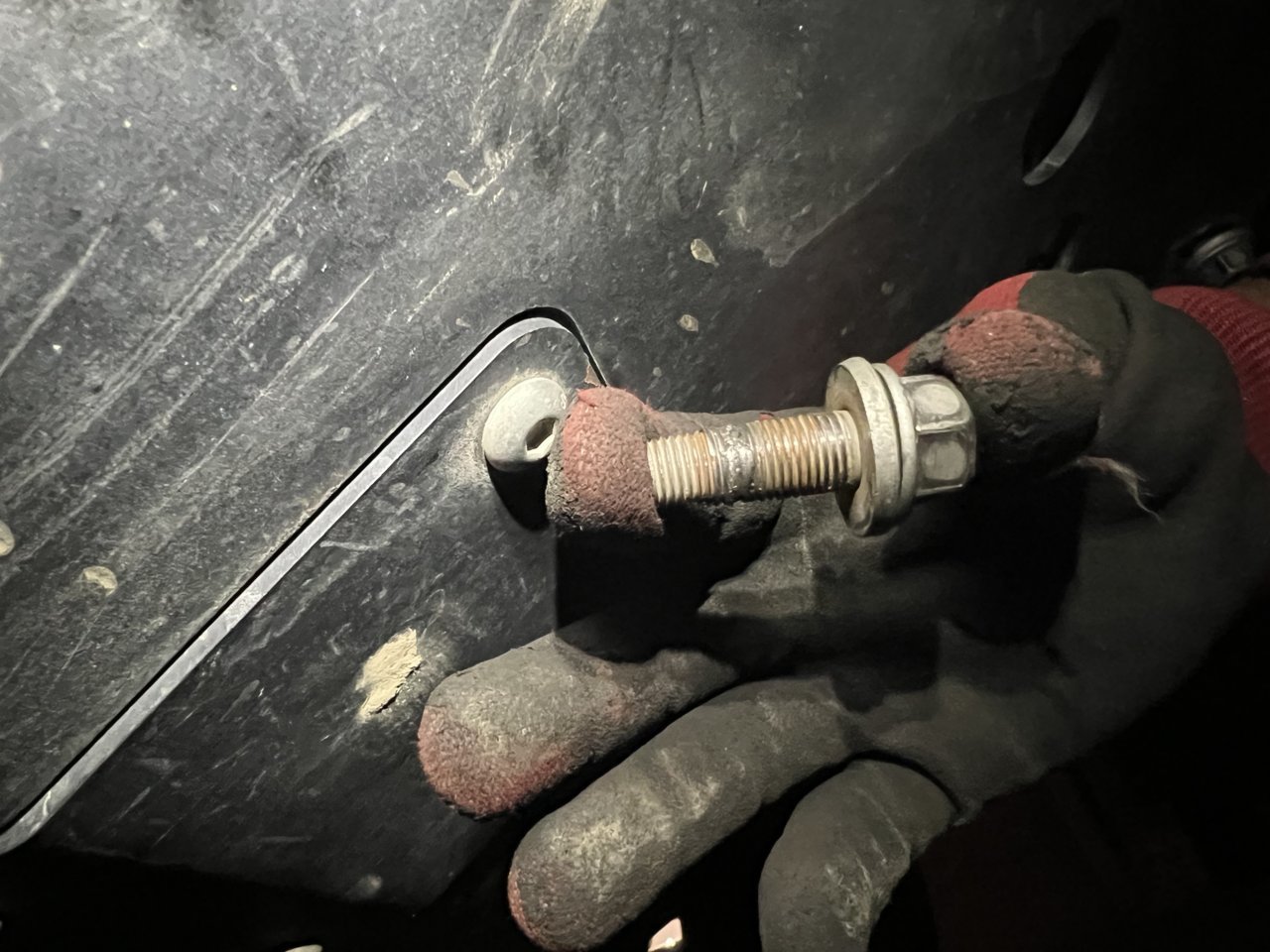

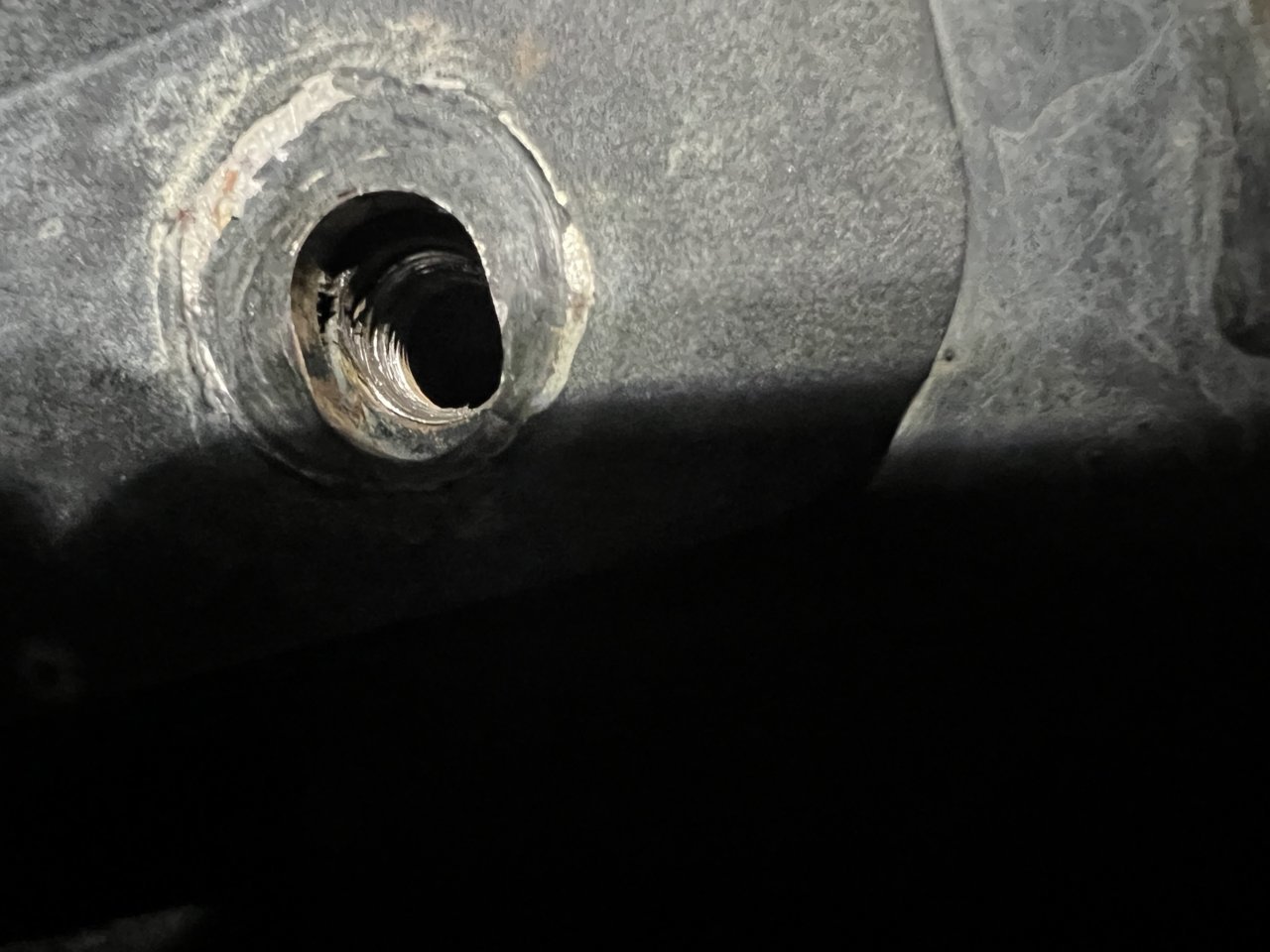

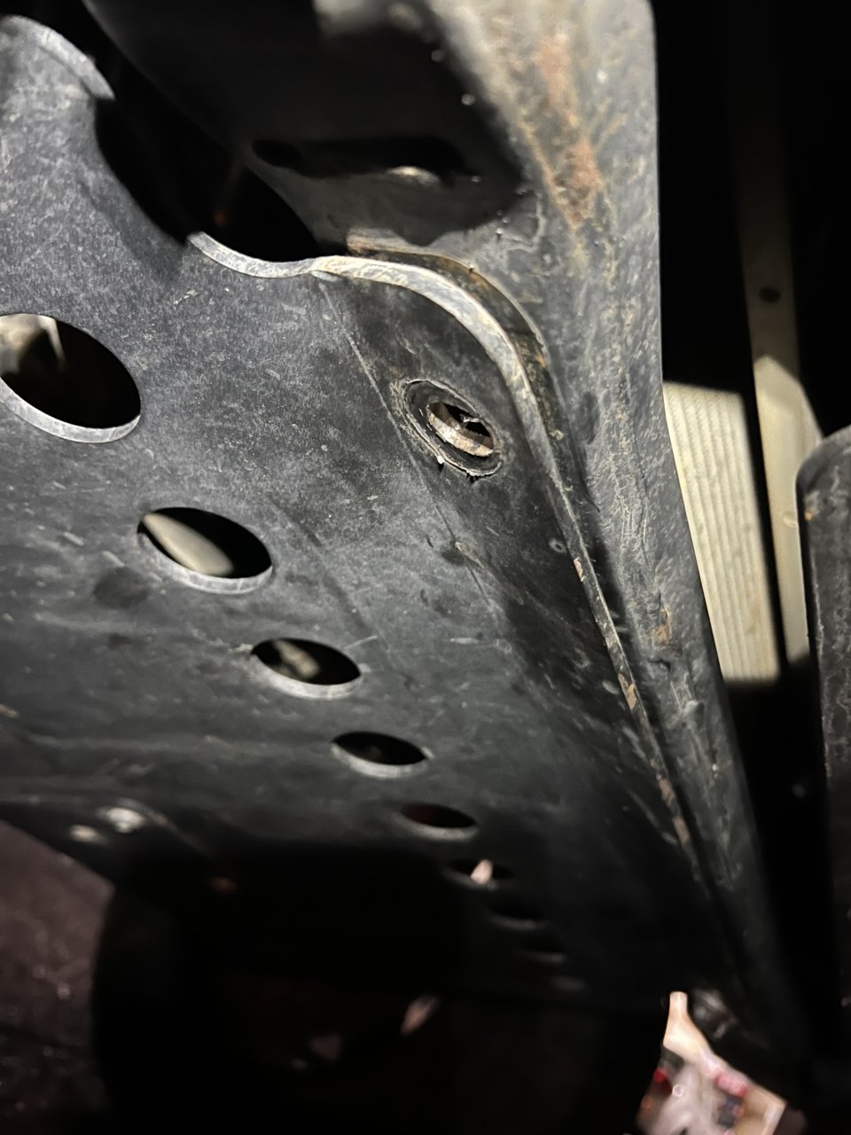

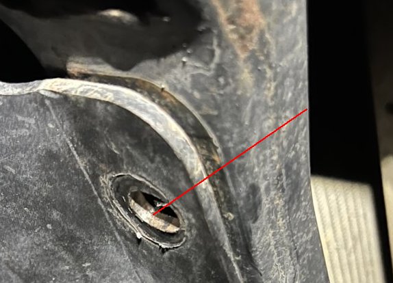

    I need advice on how I should proceed next. Was reinstalling steel front skid plate and I stripped the furthest front mounting bolt and hole on the passenger side. Can the hole be re-threaded and a new bolt installed, is drilling and tapping a new mounting hole possible or should I just run the skid plate without that bolt?

    Welcome to TW…Only one way to find out…run a tap in it and get a new bolt

    @HondaGM I’m gonna give that a try, at this point I don’t think I can make it worse than it already is ¯\_(ツ)_/¯

    With your current bumper, looks like you have access to the top of the crossmember? Drill all the way through the top of the crossmember and use a long bolt with nut and thick fender washer.
