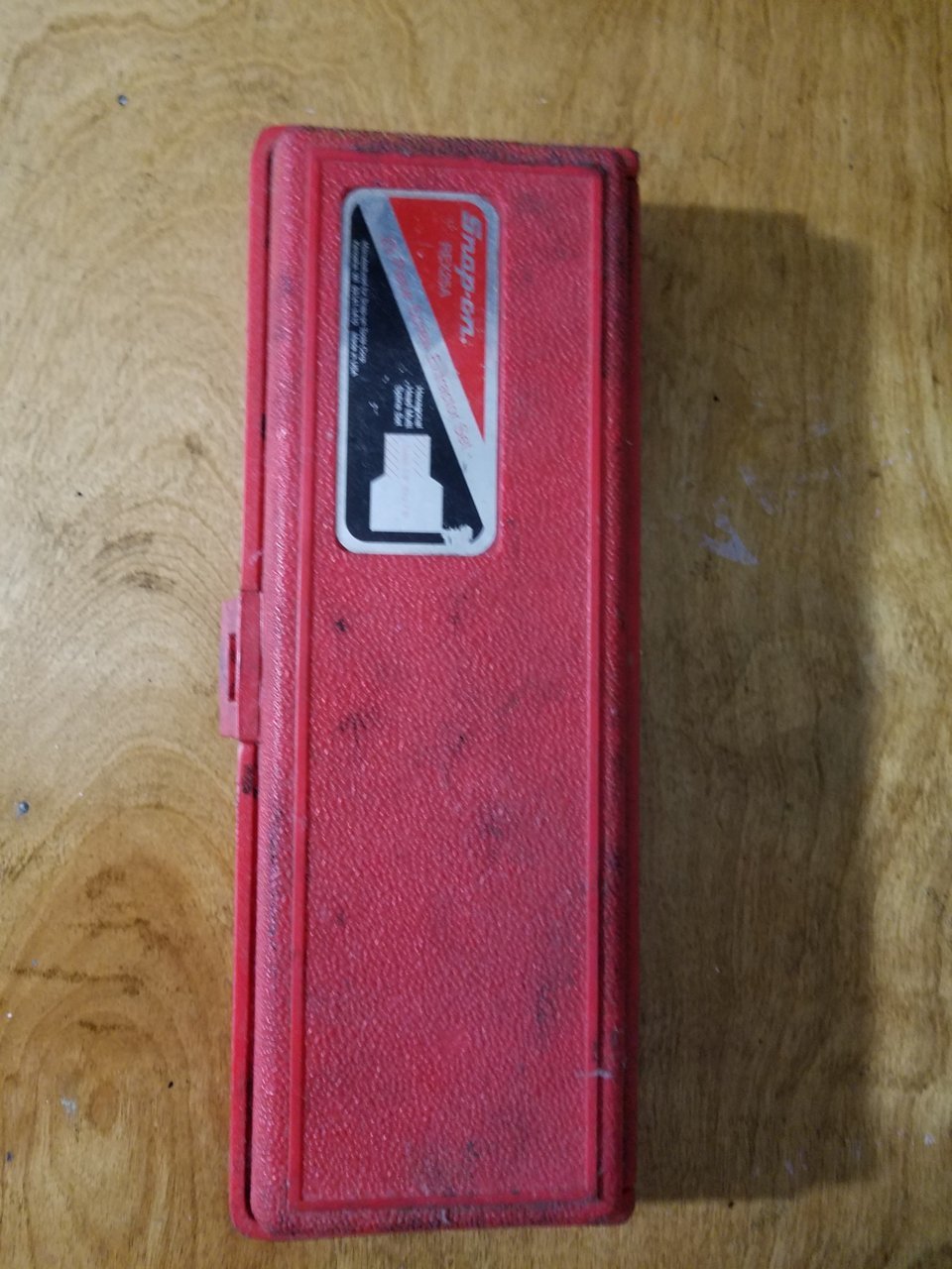

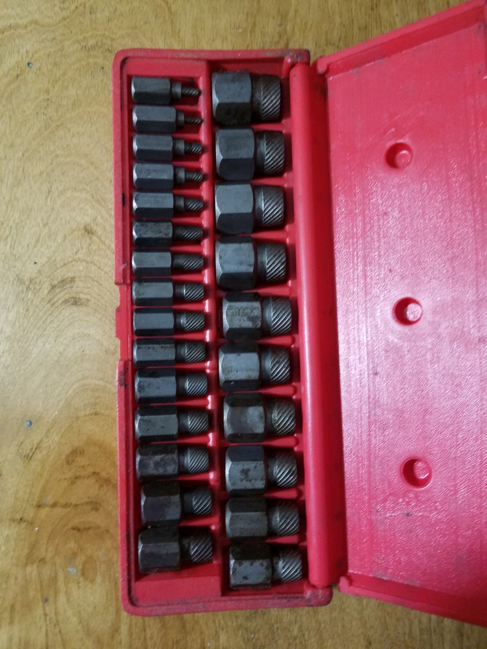

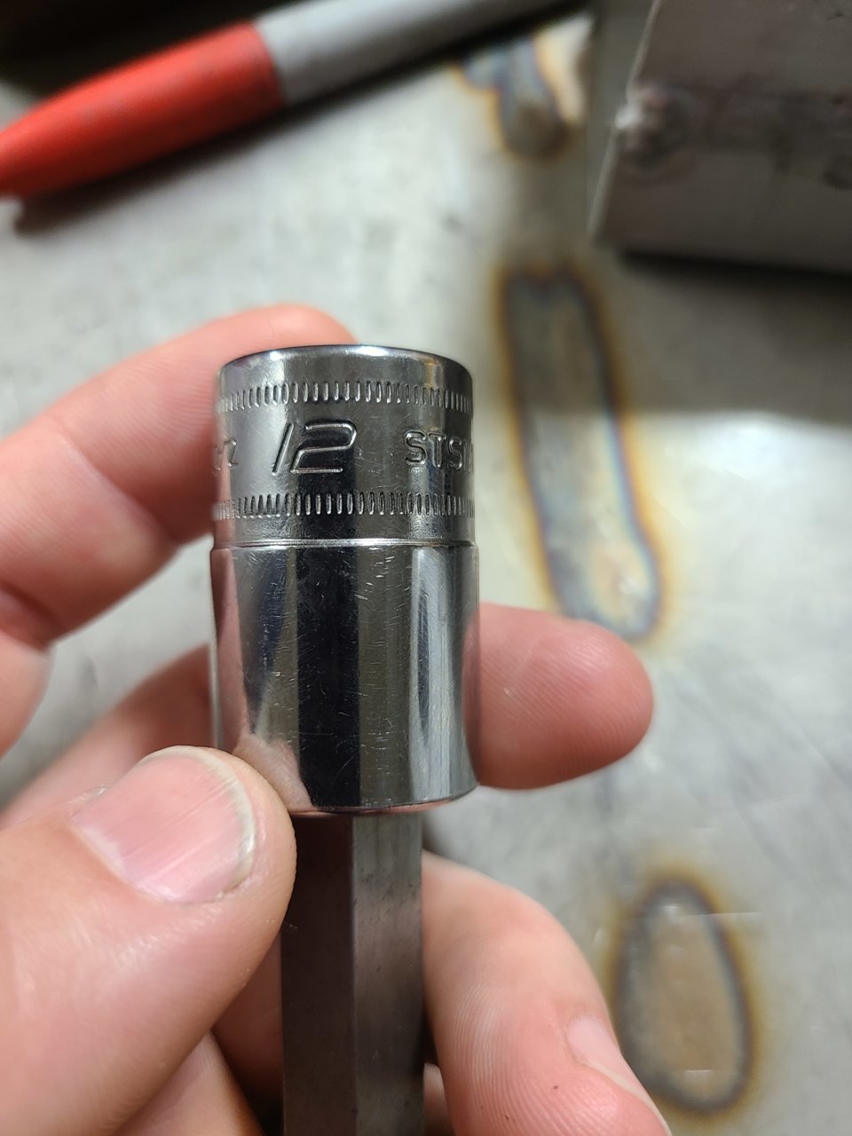

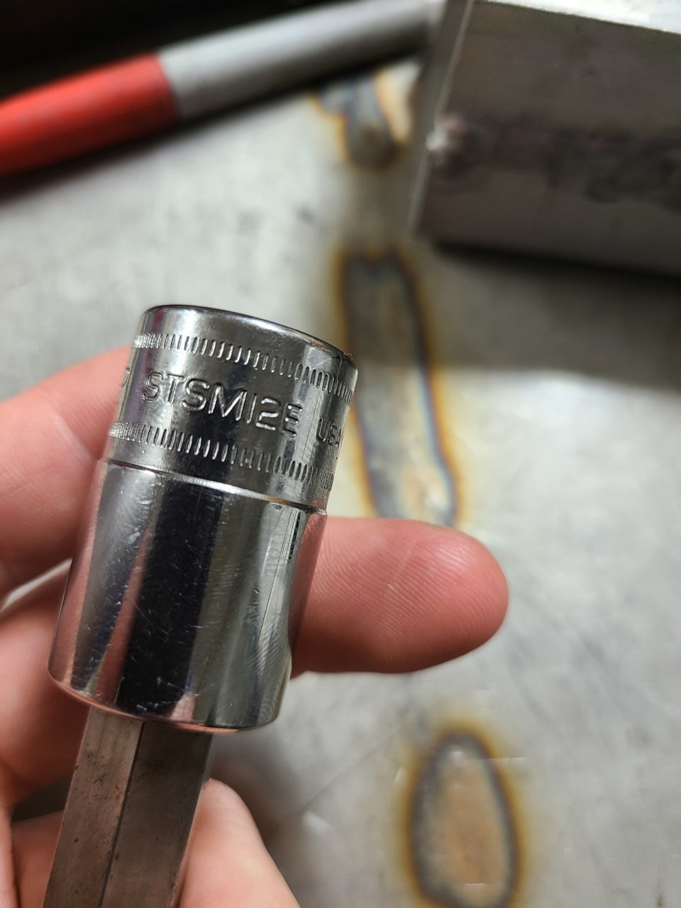

    I have the Snap-On one. STSM12E
    landphil[QUOTED] likes this.

    Is that actually 12mm double hex? I linked 10mm, since OP mentioned a 10 mm 6pt hex socket. Hope I didn’t steer him wrong, and if so, the sooner he knows the better.
    Edit. Snap-on is listing yours as a 12mm triple-square.

    Mine is a 12mm. Used on multiples of my engines across a variety of years. My original engine being an '06. It was the Snap-On part listed specifically for the engine, as far as I can remember.
  12. May 23, 2020 at 7:19 PM
    #32
    Torspd
    Torspd Tor-nication
    Sep 18, 2009
    #22958
    26,446
    Tor
    The Great America!
    MMVI 4.4L 4x4 Access Cab
    Torspd Custom Turbo kit [] Borg Warner 9180EFR Turbo [] Haltech Elite 2500 [] TiAL Q BOV [] TiAL V44 Wastegate @ 15psi [] CP Pistons [] CP Carrillo Rods [] ARP Head studs [] ARP Main Studs [] ARP Header - Head Studs [] Ported Heads w/ 1mm oversized valves intake/exhaust [] Brian Crower Forged Stroker Crank [] Darton M.I.D. Sleeved Block [] Kelford Camshafts [] Torspd 160* T-stat mod [] APR Large Fuel Rail [] Walbro 460 LPH E85 Fuel Pump [] FueLab FPR [] APR T56 Conversion Kit [] KP RACING Built T56 [] McLeod Racing Custom Twin Disk Clutch [] One Piece Aluminum Driveshaft [] MGW Shifter [] Custom lowering kit [] Ohlins Front Coilovers [] QA1rear shocks [] Custom Ron Davis Radiator [] Dual SPAL Electric Fans []
    Perfect fit

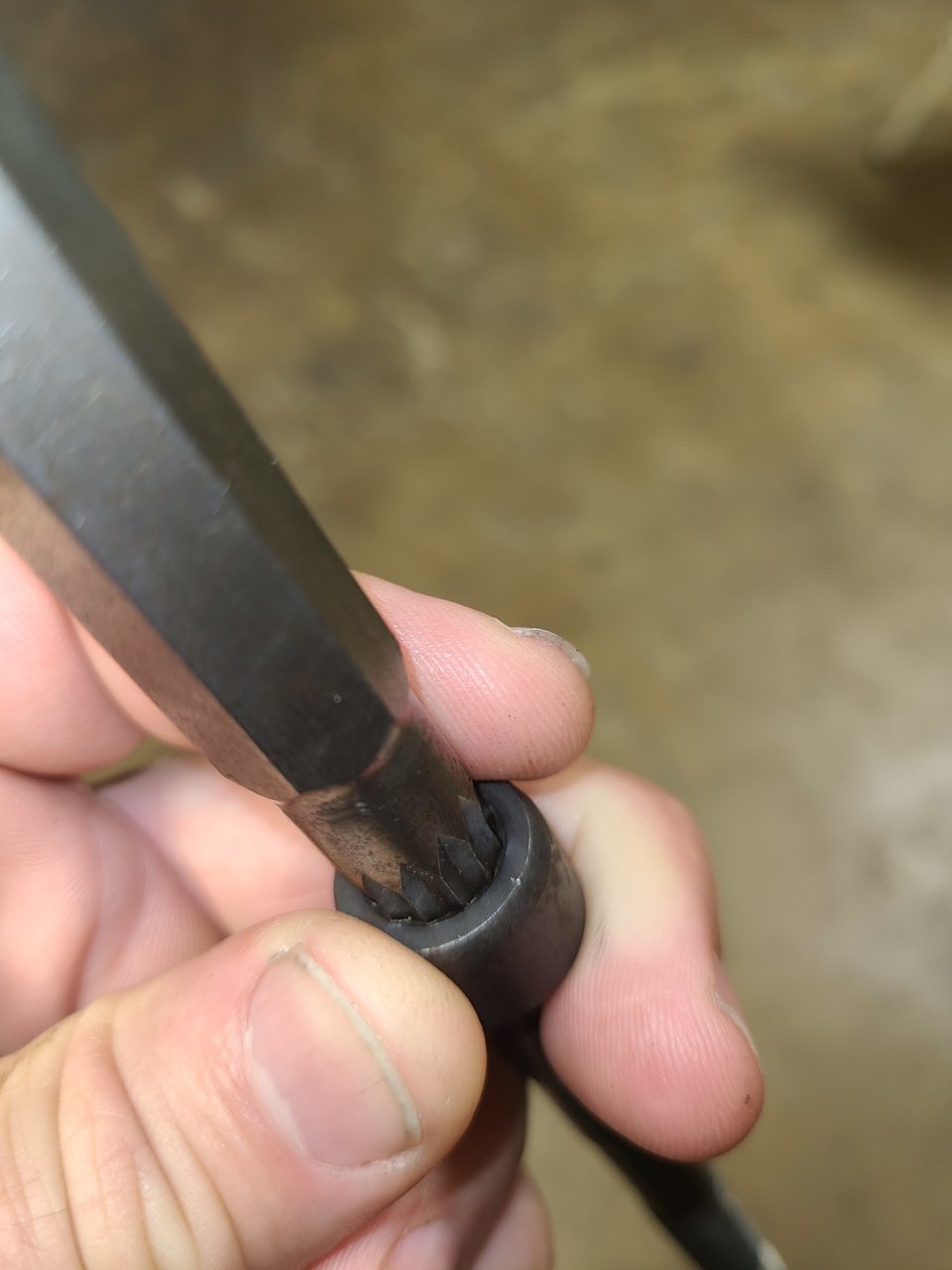

    A few
    FYI snap on sells these spline extractors .Might have worked on those stripped ones . Know you got it out already

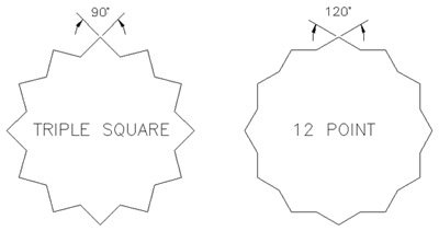

    Just so everyone else can see the difference.
    Skyway and wilcam47 like this.

    Hmm.. so I looked into the STSM12E bit on ebay and it the seller lists it as a triple square. The bit does indeed appear to be a triple square according to the diagram posted above. Should I go ahead and get this anyways, or is there a there a different bit I should order?
    [​IMG]stsm12e
