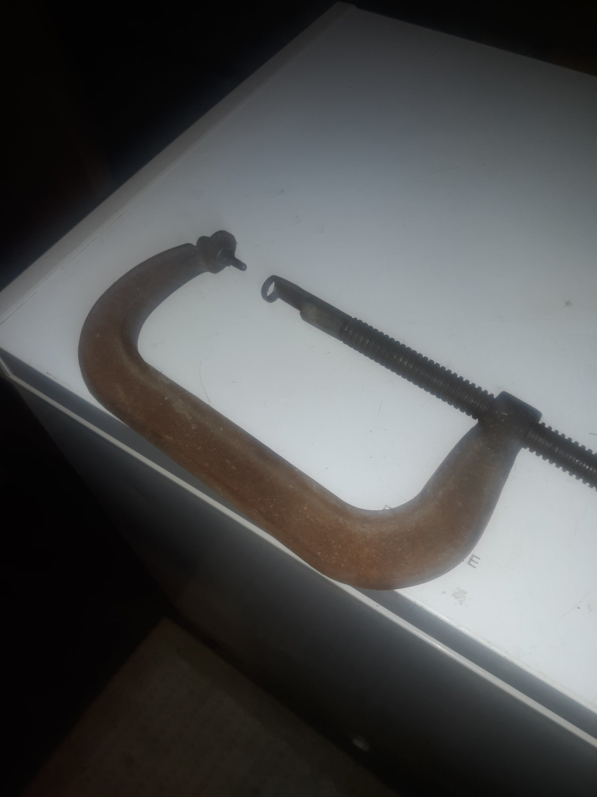

    I made this when I was racing motorcycles a long time ago.

    I used this when I removed my valves when I did my head gaskets lasts year. I can’t tell you if there are easier ways but this does work. Just be careful with those keepers. They like to fly around.

    Ok thanks for the help. I tried using a spring compressor from oreillys but it kinda sucked so I ended up using a socket with a magnet inside and that worked very well. Part of my confusion was that I didn’t realize the “buckets” just lift off of the springs by hand
