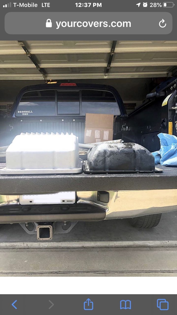

    CDDC4C99-3D0E-4B95-9554-9BE08459A2D3.jpg Or just be like me and upgrade the whole pan, lol.
